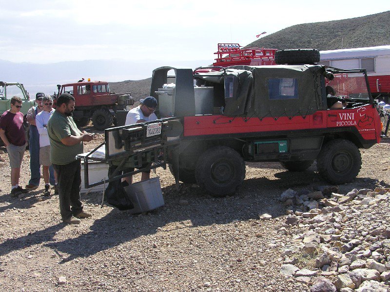

Does anyone have more info/pictures on this truck - one of my goals is to be able to put my smoker in the back so I can drive to various comps.
The prep table looks cool too!
While we are at it - can someone measure the distance from the floor to the bottom of roll bar (my Pinz is in Cali so I can't do it myself).
Thanks,
Thanks,

Check with Andre, I believe the prep table is his work (and that's him in the green shirt, first in line!).

the oven is a wolf brand commercial oven, set up for propane, and it sits on the folded down rear seats(removable).
The rear expedition rack is made to swing open in the opposite direction as the oven door.
We made the food service top large enough to fit his 100qt commercial cooler and it was done in 16ga stainless steel.
The spare got moved to the roof to accommodate the rack/service top.
I made the rack hold 2 jerry cans as the small Onan generator(where the jerry can used to be) is plumbed into the fuel tank.
The entire set up slides into his 2" receiver with a locking bolt and rubber bumpers to keep it from jingling around on the trail.

Jimm391730 wrote:Check with Andre, I believe the prep table is his work (and that's him in the green shirt, first in line!).
And let there be no mistake. I was helping prepare and serve. I ate last.

Do you have any more pictures or know how I can contact owner to ask him some questions.Andre wrote:the oven is a wolf brand commercial oven, set up for propane, and it sits on the folded down rear seats(removable).
I have the hauling of my smoker planned but the swing out prep area would kick ass
