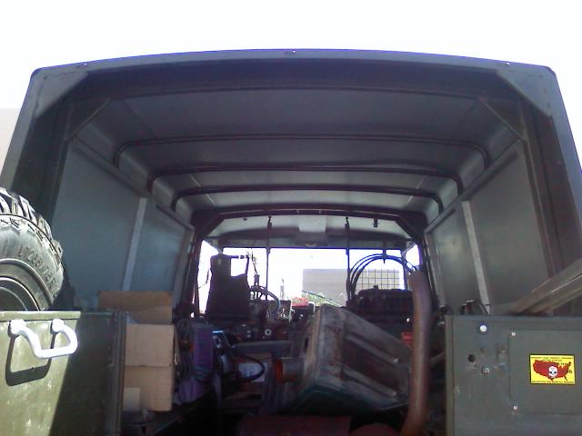

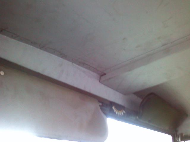

Here's some preview pics of what I've been working on.
- 0131141039.jpg (30.65 KiB) Viewed 9269 times
- 0131141038a.jpg (73.01 KiB) Viewed 9269 times
- 0212141149a.jpg (53.93 KiB) Viewed 9269 times
- 0212141150.jpg (46 KiB) Viewed 9269 times
- 0212141149.jpg (66.28 KiB) Viewed 9269 times
Re: Fat Fabrications hard sides and roof
more images with windows, rear door, panel, and door latches soon.
