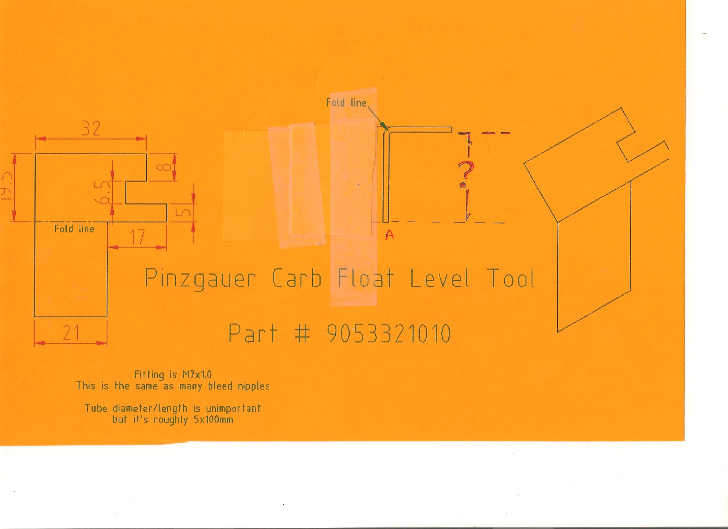

Assuming A is the point to which the level in the tube must coincide to indicate the fuel in the bowl is at the appropriate level,
would someone who has a properly dimensioned tool give me the length indicated by the question mark on the attached drawing. That is, from the bottom of the horizontal leg to the bottom of the vertical leg
thank you and i promise i wont make any more posts on this topic

Ah, just realised you've edited my original drawing. The thickness of the metal was about 1mm - just take that off the vertical dimension, therefore 26.27mm - I think you'd be hard pushed to set the levels that accurately anyway

Thanks Spandit!!!!!
You wouldn't believe how many different confusing replies and numbers I got to what I thought a very straightforward question.
Thanks again!
Thanks again!
Re: Float level gauge dimensions final appeal
Glad to help. Should have measured that dimension when I had the original tool. In reality, you could stick a scale on the side and just make sure both carbs are at the same level.

First I apologize if I came across as ungrateful or derisive of any of the replies I rcvd . This forum has helped me immeasurably over the years.
In my defense..I was looking for one number. I recorded or did the calculations given in each response and never once did I get the same number. A perfect example are the responses from Spandit and from edzz
Spandit, who made one of the tools and presumably used it successfully, gives the number 26.27 mm. The drawing he did is very helpful.
edzz directed me to a commercial site that has a picture of the tool they sell and indicates that the proper measure is 1.05" . This converts to 26.67 mm
Maybe Maybe i was/am being a bit anal as my scribe cant make separate lines .4 mm apart
They are several replies which result in radically different answers including the number 16.5 in the repair manual (i admit that one still confuses me) And there were replies that just confused me
Once I again I apologize for any perceived lack of appreciation on my part for the replies, all of which, I know were meant to be helpful

Since the gauge distance includes the gasket and the carb top thickness (because it bolts to the top of the carb top) it ends up being closer to the 1" or metric numbers you've seen; but IIRC the 16.5mm number in the manual is the distance from the top of the carb BOWL (from the top of the middle part of the carb) and does not include the thickness of the gasket and carb top. Other than miniscule differences I think you will ultimately realize that all the numbers you've seen here are correct if taken in the correct context.radically different answers including the number 16.5 in the repair manual
Good luck!

It's a shame that the levels can't be adjusted without taking the top off - wouldn't be difficult to fit a screw somewhere for a competent engineer?

The adjustment is made by putting or removing shims under the shut off valve....so screw would not work
I know, but if the height of the valve could be altered by means of a screw that would aid things
Robin
