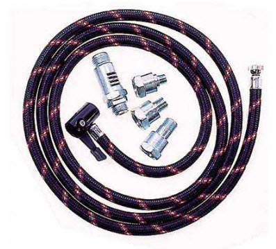

Any one ever heard of this or better yet tried it?
Basically you just remove a spark plug and the special valve allows only fresh air in (so your not filling your tire with an lovely air/gas mixture)!
Seems pretty cool and a great way to have "backup on board" air (if it actually works and you added a hose long enough to reach all the wheels and you could deal with all the fuel in that disconnected cylinder!)

Taking a plug in and out is probably not a good idea when there are plenty of other options for filling up your tires.

compunerdy wrote:Taking a plug in and out is probably not a good idea when there are plenty of other options for filling up your tires.
Agreed but it is an interesting option for an emergency situation perhaps? May not work and may not be a good idea but it could bring out good discussion about on-board air options.
Engine driven compressor
24v compressor (perhaps with tank)
CO2 tank
Hand pump

It uses the engine compression to actuate the tiny-tiny compressor unit and pump up your tires?
This might take awhile, since it's gonna draw in, what, a cm2 of air at .0 bar every other revolution of the engine? The tiny, cheap electrics pump the same volume, but WAY faster..

I used to have one of those 30 years ago - they work, fuel gases do creep in a little and perish the rubber hose but they are a pain to use - burnt fingers getting the spark plug out, trying to cross thread spark threads however for emergency use only is OK but not for regular use.

I would much rather spend a few or more dollars on a battery air pump. Certainly the idea of taking off the dog house and frying my fingers to get a tire pumped up
would not be my choice. Seriously doubt that there is enough umph to re bead a tire. Even a hand or foot pump would be a preferred method.
For a serious long term off road adventure I would (if I did not already have a pump) invest in a CO2 bottle, and (if there were an option) not travel alone.
