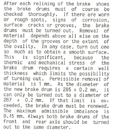

I am trying to find the drum specs on the site, and this is the closest my search has come.
I need to have my drums turned and I was asked what the allowable tolerances were for the drums, is there a thread that has this info?
If not what I would really appreciate the information?
Re: Brake Drum Groove
Please add your location to your profile. Have you no manuals? Here are the numbers you need.

Post by rcollierf350 »
Awesome thank you
