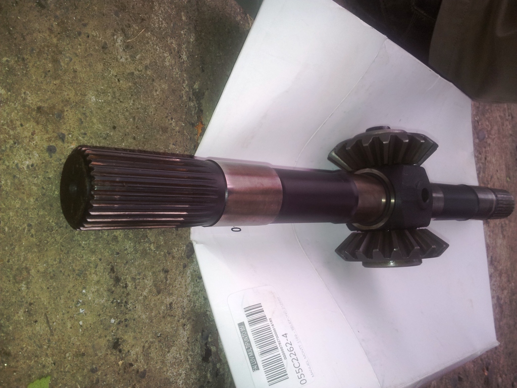

Hi, having removed the rearmost axle, found the problem is on the pinion shaft if damaged. The splines which joins it with the spinned hub are worn. The spinned hub seems to have some wear as well, bus the splines on the shaft are almost gone...
Could not find the price for the pinion shaft, but assume it wont be cheap! Any ideas?? I think it´s no good idea to repair it.
Here a picture before opening the diff. Later will attach some more.
Greetings!
Greetings!

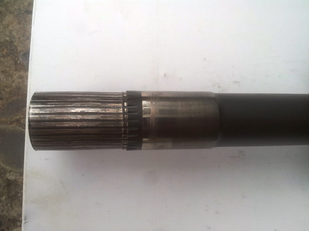

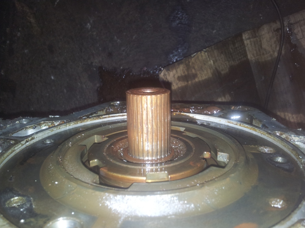

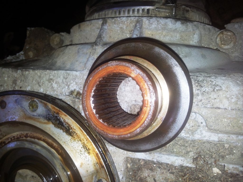

Here some pictures of the shaft, damaged and also the fit side, and the plined hub.
- healthy side of the shaft
- 2014-03-27 09.24.38.jpg (367.98 KiB) Viewed 7232 times
- damaged, very worn side of the shaft
- 2014-03-27 09.21.54.jpg (248.61 KiB) Viewed 7232 times
- splinned hub, some damage.
- 2014-03-26 09.38.43b.jpg (419.97 KiB) Viewed 7232 times
- David Dunn
- Posts: 2283
- Location: Arcadia, CA
Re: Wheel drive oil replacement
With a quick check of the parts manual, it appears that only the ring and pinion gears themselves are 716 part #s and everything else are 710 numbers.
So go hunt down a 710 or 712 and liberate a diff for it's parts.
- Jimm391730
- Posts: 1456
- Location: Idyllwild, CA
Not nearly as good as a proper replacement, but if this is the rearmost axle, turn the shaft around so the worn splines are aft, towards the parking brake, and the good splines are getting driven. Then drill a hole for a cross pin through the damaged splines and collar so the parking brake is functional again. Generally, the brake will have much less torque than driving.

I' ve been thinking about a solution like that, but the front part has a hole where the driving shaft fits in. it should be drilled.
And would the diff lock work in that configuration? Anyway the lock would be a secondary problem...
Thanks for the ideas and opinions!

Unless you are under a time restraint, replace the parts. You have all the time into dismantling, do you feel it would be worth doing a second time? Especially if it happens at a less opportune time, and possibly more dramatic
