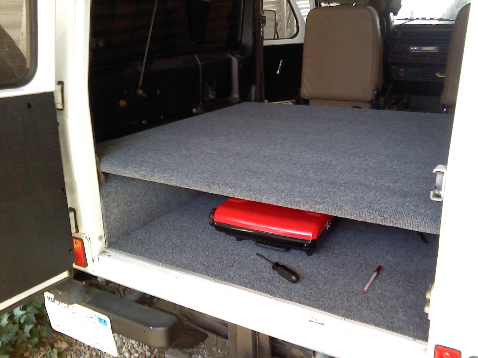

For budget reasons, I couldn't get the sound matting (from heco.net) that I normally use on project trucks and settled on this not-so-bad jute/alum. stuff. Auto/outdoor carpet will go over top and they will be glued together but I am not gluing the insulation to the floor! (dont ever do that)
The main part of the bed is done. There is an extension that is folded down when the seats are put forward which provides almost 6ft. of sleeping room. It is attached at the front of this piece via a piano hinge and has two 2x2's for support. The fridge is mounted on the far right rear corner and wired directly to the battery with a new switch on the shifter console. It can be left on all night as its a Danfoss compressor type. I'll post the completed stuff soon.
