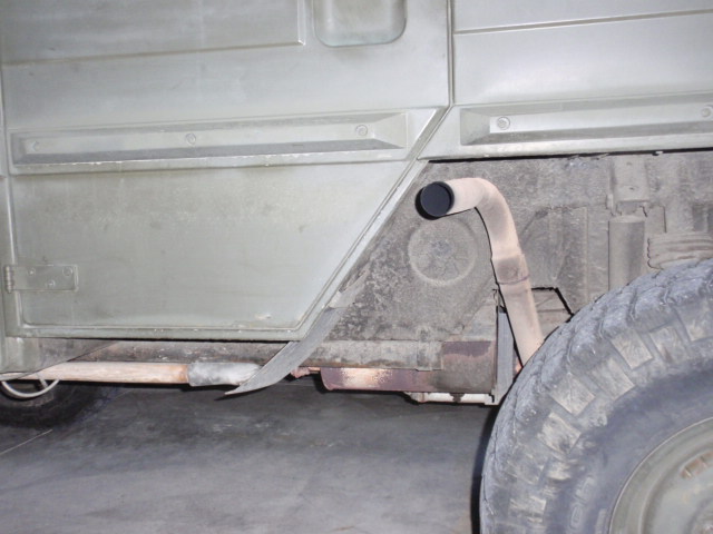

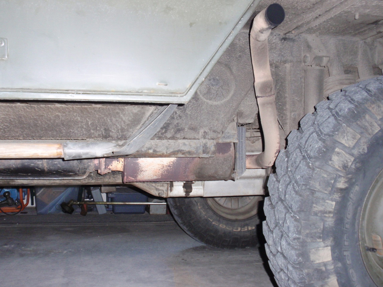

Re: Fumes in cab
For what its worth... I don't know if it makes a difference or not. I will caution against running the exhaust pipe too close to the body of the truck to prevent hot spots inside the truck.
- P6250043.JPG (76.09 KiB) Viewed 5294 times
- P6250041.JPG (254.97 KiB) Viewed 5294 times
