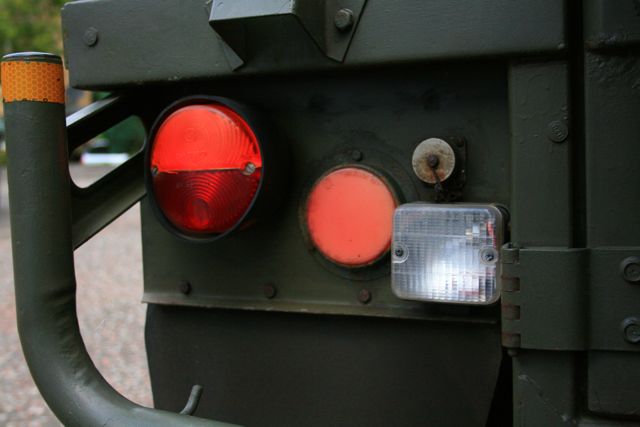

Mine are cheap generic ones mounted next to original refectors http://www.pinzgauer.4x4man.com/Modifications.html
I have had my rear lights changed so red is brake as per EU Standard.
If I had more money I would have gone for a more powerful LED light

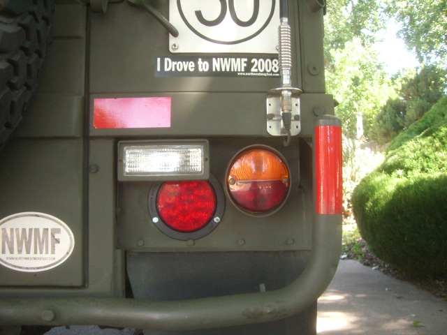

Right side above LED tail light. Operated from switch installed at front cab console.
