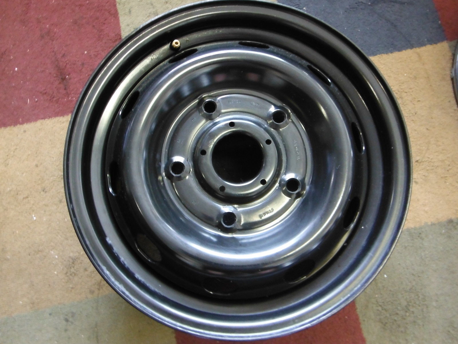

Got a call from the local dealer that they had one of the 2015 Ford Transit vans on the lot - I dropped by and measured the bolt circle -yep, it is 5 x 160mm - and they look like they would fit. I forgot to take a couple of pictures though. The steel wheels seemed like they would possibly fit even with the recessed area of the Pinz drum.

Here is a picture of the rim (this is a white one used on some of the contractor versions:
http://www.hubcaphaven.com/mm5/graphics ... cap_lg.jpg
The cap is a plastic snap in part, btw. The 10 holes in the rim are actually semi circular - just look oval from the angle of the photo.

I'd say its 90%+ that the 2015 ford transit rims will fit....
Check the other thread "Stainless steel lug nuts" for pics of the previous euro transit rims on a pinz - also this posting:
"I just ran that tag in the Ford system. The part IS 4138552, engineering # is YC151007DE.
Also, this wheel is not part of the FOMOCO USA parts stream. I'm told the Ford 16 x 6 1/2 USA part# is YC151007DA. List price $258.82"
So the trick will be to get them as take-offs when someone upgrades their transit to alloy wheels.

Yes - I agree - I actually don't like the look of most aluminum rims on a Pinzgauer - I would consider the steel wheels however as they should keep the wheel on the rim better than the stock pinz wheels and might be easier to get correctly balanced. For the price of these you could get something much better like the bead lock Trail Ready rims that are available in pinz wheel spacings...
There should be some of the steel wheels coming up on ebay from vendors like this guy - he sells the surplus items from the RV converters in Indianna...

I contacted that seller earlier today and he has a total of four rims - they also are from a full size Transit and not the smaller Transit Connect as he incorrectly had stated (he might have fixed it by now). Like new condition - painted black .
I offered him 1/2 of the dealer price for buying all four and he seemed willing to make that deal. So it would be about $517 + shipping from southern CA for the full set.
Anyone up to try them out? I don't really need them right now... someone should go for it!
