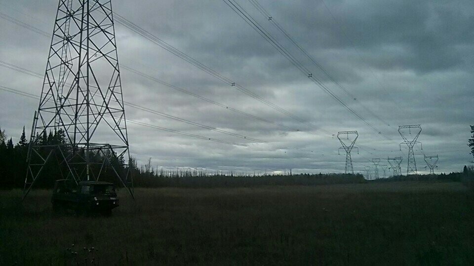

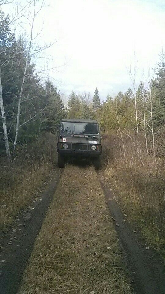

Truck is running great! Finally got it back into the bush where it belongs. Did some scouting today before Deer season starts on Monday.

Glad to see you out
Love that front bumper!!
