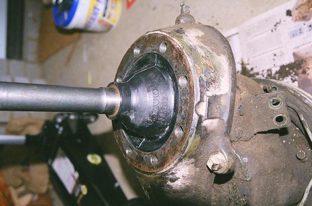

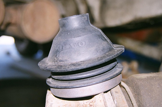

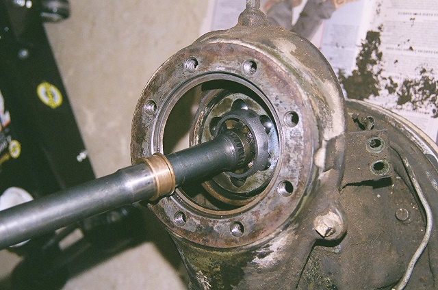

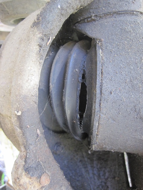

For reference, here are some pictures of the CV boot installation. Note that the CV seals the axle halfshaft around the brass ring, seals the portal to the axle casing (sandwiched between flangle) and then seals to the outer box (steel ring around CV).

1st Picture shows the boot (new part).
2nd shows the portal hub with the boot removed. You can see all 3 sealing faces in this picture.
3rd shows the boot installed.
FMV or Tatanka? Good question...
The boots in the photos came from Volvo stock around 5 years ago, and despite very minimal use, have already split (last photo), which I assume is a result of age (perished) rather than wear. So I now have some of FMV's recently manufactured boots waiting to be fitted.

When my boots first split, the primary indication was the vast quantities of oil leaking out...
