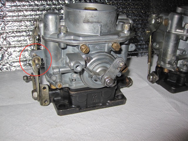

I have been reading about these trucks idle speed should be set up around 750-850 05 so. My truck starts fine, but was closer to the 500 mark. Once it's warm, it will run, but the gen light comes on and it always seemed slow to me. Now I know why.
I figured it would be an easy adjustment, just tighten a little. Took the engine cover off and I don't see any screws where they are supposed to be. Or am I not looking in the right area. I have a manual, and think I know what to look for.
Is there anything special about these screws? Does someone know the thread pitch and size? Is this something I can pick up at a bolt\screw shop, or is it funky?
I think there are only 2, one for each carb?

I think your carbs use the smaller idle speed adjustment screws (red circle). Both sizes were used for no apparent reason that I've found. And yes, there is one on each carb.

Here's a photo of the adjust screw on the front carb.
Re: Idle Adjusting Screws Missing
Okay, I see. Face palm!
I thought they were lower than that, on the plate that has the two holes...
Sounds like I will be upping the idle and balancing carbs today, or at least attempting...

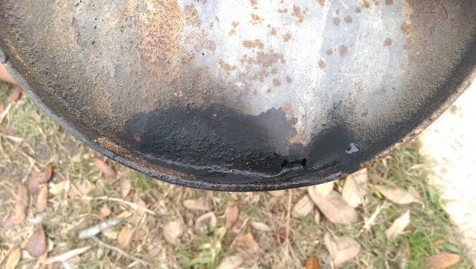

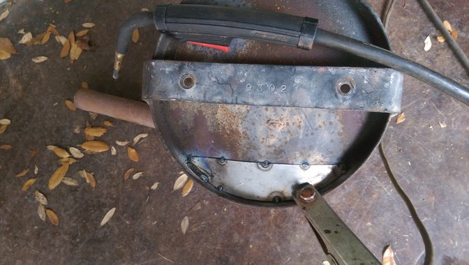

After doing this, I noticed a puddle under the thing, thought it was just water(has been raining), but it was kind of black. Looked around and found my muffler had a hole! Oh well, took up welding last year, best thing I have done lately. Dropping the muffler, welding a patch and putting it all back was not that hard. Had to form the patch around the muffler, I think it has seen its fair share of the Arizona desert and isn't 100% round anymore...
I took the pic before I put a bead on it, only tacked in place in the picture.
Bonus, she runs better with the higher RPM, and no more hole in muffler...
