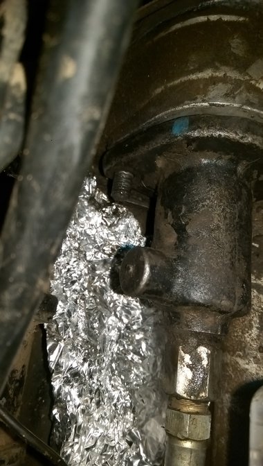

I have been wanting to bleed my clutch and had some time to investigate that today.
Took off the doghouse and following the clutch line, I think I located the slave cylinder but what I think would be the the bleeder valve is pointed towards the engine, and there is no valve there...? The picture is somewhat obstructed because of a shadow but I think you can make out where the bleeder valve would be screwed into. Feels like it has broken off to me.
Hopefully the pic helps. The big white thing at the top is the oil filter.
The only thing I can think of, is that it is installed the wrong way. Is that even possible, and can I just flip this around if that is the case? Assuming that I can remove the broken nipple and get a new one. Would I need any seals/gaskets.

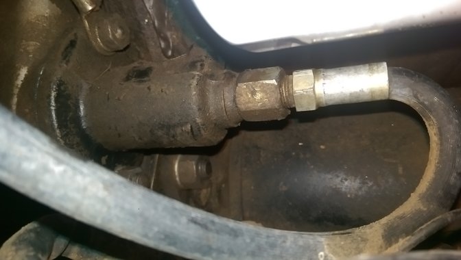

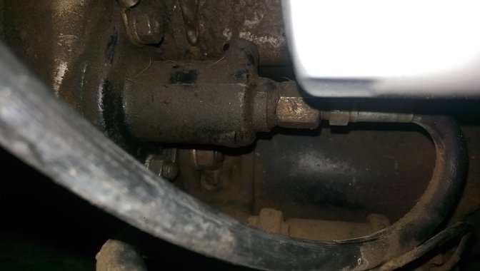

Little better lighting, you can see the orientation of the valve.
Looking through the parts manual and some older post, it looks like these can be removed for cleaning without leaking much, or even removing lines.
The plan is to remove the nuts holding it on, then rotate 180 deg and bolt it all back. Hopefully not even removing the housing. Plan on doing this today, if any issues I should look out for, let me know.

For those that are curious. It is indeed possible to install the slave 180 degrees off, with apparently no change in clutch performance... Other than making it impossible to bleed...
I swapped it around so the bleed valve would not be facing the engine. But, there is a broken valve in there. I am going to order replacements asap and try to get that one out. Any thoughts or previous experience about extracting a broken bleeder valve?

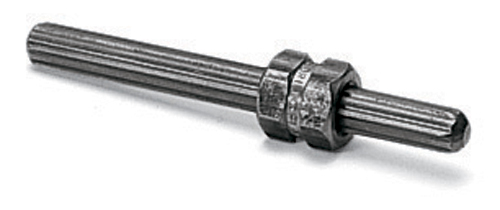

OK, so the valve is broken. If it is close to the body of the piece it goes into all the better. I used an extractor similar to what is used to remove broken bolts ( don't know the tech term) but the nice part is the valve doesn't have to be drilled like a bolt as it already has a hole to put the extractor into. Back it out, and put in the new one. Ezy pzy.

At the tool store ask for an "EZ Out", hint they come in many sizes.

Having multiple types, I've personally had much better success with the straight flute type, but they are not common to find.

I have never seen the flute type. I have the ez outs but have been having more success with speed outs. They have a bit on one end and the extractor on the other. But it does depend on the situation/material. Hell, a sharp flat head screwdriver with a hammer has done the trick for me.

I tried every damn ez-out I had, but they just kept stripping the metal without backing out the valve. Ended up removing the slave and hose, putting it in a vice, and using the sharp screwdriver/hammer method to remove it, that's some soft metal.
