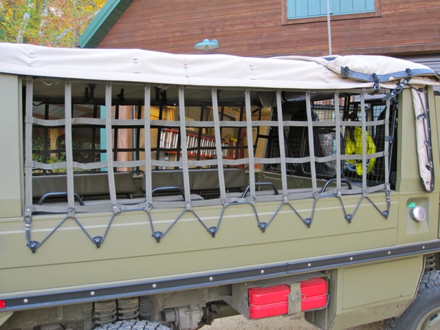

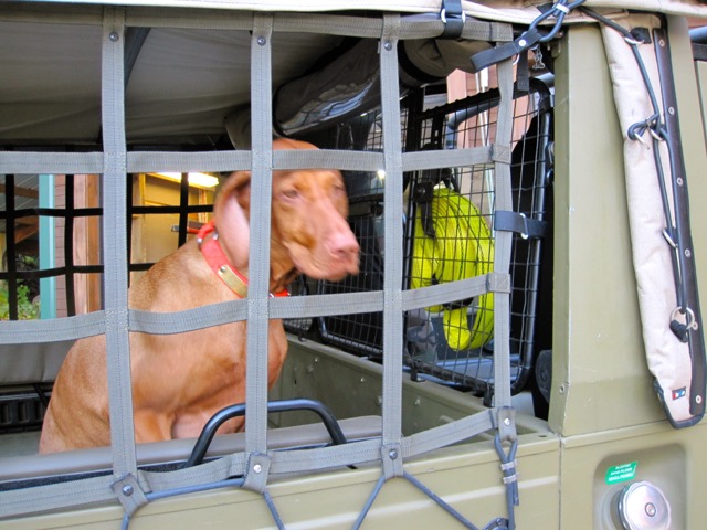

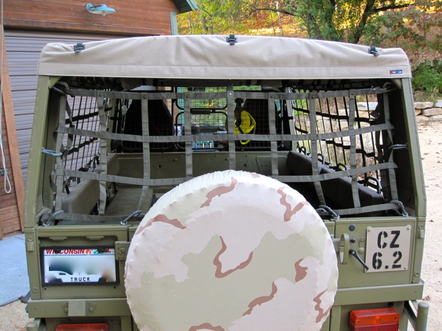

Seats up and with new rubber clamp inserts for the seat backs so they don't dislodge easily.
I came up with this CCS (Canine Containment System) :wink: after I found he would occasionally jump out the side while on the trail if a squirrel or turkey appeared. It has worked very well for me with no issues. The cargo net came from Sportsman's Guide and I cut and re-sewed as needed.
110446 PM - Version 2.jpg (112.25 KiB) Viewed 4918 times
Re: Dogs in a Pinz Question
I do something very similar. I have 3 safety net straps used for race car drivers windows that span the sides and rear of the pinz. I simply zip tie them and cut them off when not needed. They stay on 90% of the time.

Paul I like your netting for the M series - keeps it open but safe!
