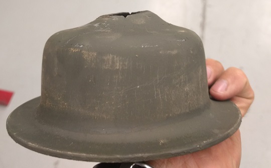

Just replaced my forward right cup. Noticed the front right sat a little low.
Grabbed the community (Southwest Pinzgauer Association) spring compressor tool and removed the spring.
The cup had rust/busted thru and the frame was sitting on the cup. I managed to fully extent the axle/spring after I remove the strap and shock and managed to pry enough to get the compressor tool to fit in. After that it was cake. Jacked the wheel hub until the rubber stops hit and tightened the compression tool threads.
The spring assembly came right out. It was a little scary handling that compressed spring to the shop to get the tool out and then to set it back in once I got the new cup. I also noticed once I took out the broken cup that the cap cup had been deformed by the broken chunk that was still riding on the cap cup. Formed that back flat and it all went to together very easy.
Now she sits level.

- Cup Cap Deformation
- IMG_20160425_161145.jpg (43.37 KiB) Viewed 7776 times
- New cup and assembly being compressed
- Pinz 710 Cup Replacement 3.jpg (217.35 KiB) Viewed 7776 times
- Broken part in cup
- Pinz 710 Cup Replacement 2.jpg (334.89 KiB) Viewed 7776 times

great photos. note the rotted cup and the tools needed to replace. Do not try to mcGyver

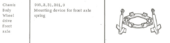

Re: Broken Front Spring Cup
In the repair manual it shows something similar but not quite the same so could be a copy someone made?undysworld wrote:FWIW, I believe the spring compressor shown is a McGyver.
The factory tool had a two-piece flat end that the arms pull on, if I'm not mistaken. PC, can you confirm?
A McGyver is okay, provided it's stout enough for the job.
