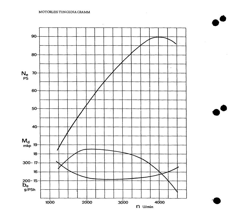

Ha! Just kidding, I found it.
For those who struggle with the French (and metric) PS is roughly equal to horsepower.
m/kp is kilopond meter and one of those is equal to about 7.23 ft*lbs.

So max torque occurs at 2k and slowly falls off after that. I'm looking at the output of some small diesel engines which have a much lower max rpm and i wonder how it would work with the stock gearing.
I wonder how many people drive within the 3 to 4k rpm range on a normal basis?
For a 710, anything over about 50mph is over 3k rpm... I'd guess that 90% of the owners run in this range at least part of the time.
