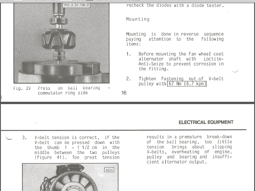

To avoid this type of thing either find a competent mechanic or learn to do it yourself.
Proper torque should have prevented this.
If your mechanic does not have access to the shop and operators manuals and the knowelege to read and understand them he should not be working on the truck.
