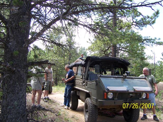

Re: Windshield down driving adventures or how to break a win
I don't think I have ever seen Scott R. offroad in his pinz with the windshield up. If anyone would have broken a windshield in the down position it would be Scott. Not something I would do as the desert plants around here tend to be less then friendly.

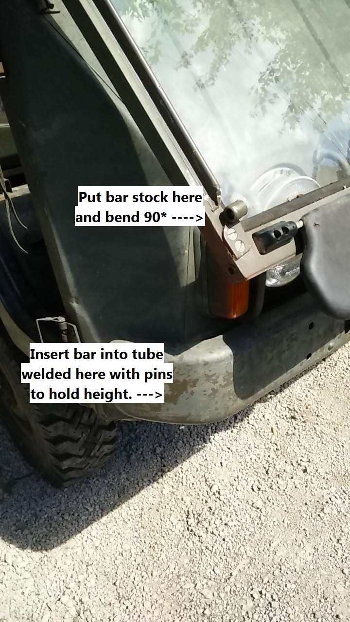

Here is what I think would be a better solution to supporting windshield while down.
- Penny_windshield_down with notes.jpg (357.51 KiB) Viewed 7626 times

If you were closer where I would have a continuous customer, I’d say go for.. but since you’re not, Here is how I see it.
I wouldn’t use the eye to suspend the windshield , nor would I use the bumperettes for a mounting point.
Using the eyes has a future possible failure of the thread or stripping from the frame due to vibrations and the frame falls . The Pinz bumpers aren’t the stiffest and if hit on one side and twist the frame… well, let’s say glass doesn’t react well with that.
The original setup mounts to the body and has a spring loaded channel that wraps around the frame to hold it firm. It appears you are depending on gravity to hold the frame in place… trust me, that won’t happen. Without use of positive fasteners to hold the frame firm, it will beat itself up until something gives ( glass has been known to fall out and be run over ). Good for me, bad for the owner.
An oversimplified solution is 2 rolls of paper towels set over the headlamp guards and a pair of tie straps from the base of the windshield frame down over the top edge and snug off at the body to hold the frame firm.
The not sooo hillybilly version might be a frame that uses the lamp guards fastener point, extends up to a point that a tube is mounted horizontally across the uprights and wrapped with something similar to pipe insulation ( just an example, I’d used something that is a little denser) . With the windshield down against the foam, fab tiedowns ( like a straps) and apply tension to hold everything firm. Lastly, tighten the bolts at the frame’s pivot point ( don’t trust the bolts by themselves, the frame will still move).
Now, if you go with a method that holds the frame, you should go to an auto glass shop and buy a tube of windshield urethane and put a layer on the inside of the windshield frame between the pinchweld and the gasket. It doesn't need to be anything pretty but a bond to hold the gasket in place. If you ever need to replace the windshield, cotter hey extractor ( hook tool, carpet tool in other trades) will easily peel the two apart. Do yourself a favor and don't use silicone, it'll release ifself within a couple years.
