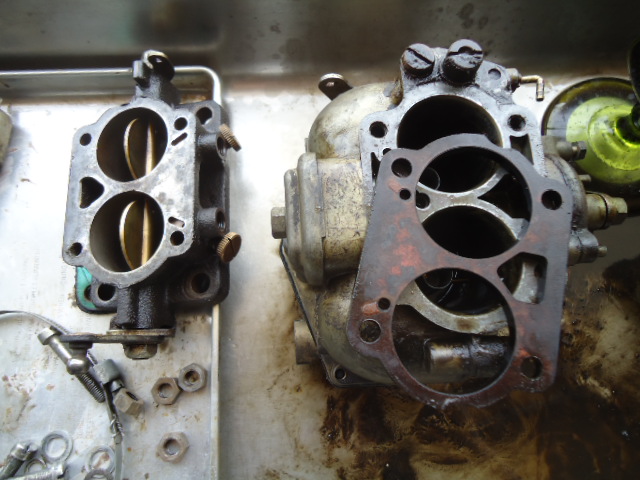

I have a spare set of carburetors. Here are pictures of disassembly and assembly afterward, something I like to do for fun. The Zenith 36 NDIX is just a puzzle like any other car part, 11 minutes elapsed between photos.
Everything was soaked in carb cleaner and then blown out with compressed air. Not shown is the new gasket kit.

How long does it take to put together when blindfolded, in the dark, and wearing mittens?...11 minutes elapsed between photos.

Jim has a good point. The Zenith carb has about 90 parts if you include every nut and washer. When I refer to the carb as a puzzle, I only disassemble to about 50 parts. These 50 can be re-assembled in just a few minutes, and that is without installing the 2 main gaskets. If I were to put a Zenith carb together with the intention of actually installing it in my Pinzgauer, it would take much more time due to the care and precision that must be considered.
I recommend to anyone who has a spare carburetor to take it apart and put it back together a few times. It doesn't take long to get familiar with everything. Read the manual and you will begin to understand more just how it works, which isn't really that complicated. The trick is getting two carbs syncronized and working together, and that isn't something I can advise on.

The throttle bodies are also critical to proper carb operation and may need rebuilding, too. The round brass plates can wear and the throttle shaft/bore can wear, too, allowing air to get past and make synchronizing and smooth idling nearly impossible. If the shaft assembly has any play at all you need to check all clearances. SAV sells a slightly oversize throttle shaft, 8.3 mm vs the standard 8 mm version, in case the bore is worn. Be sure to replace the shaft seals and locking tabs, too. All of these potential tiny leaks can add up.
