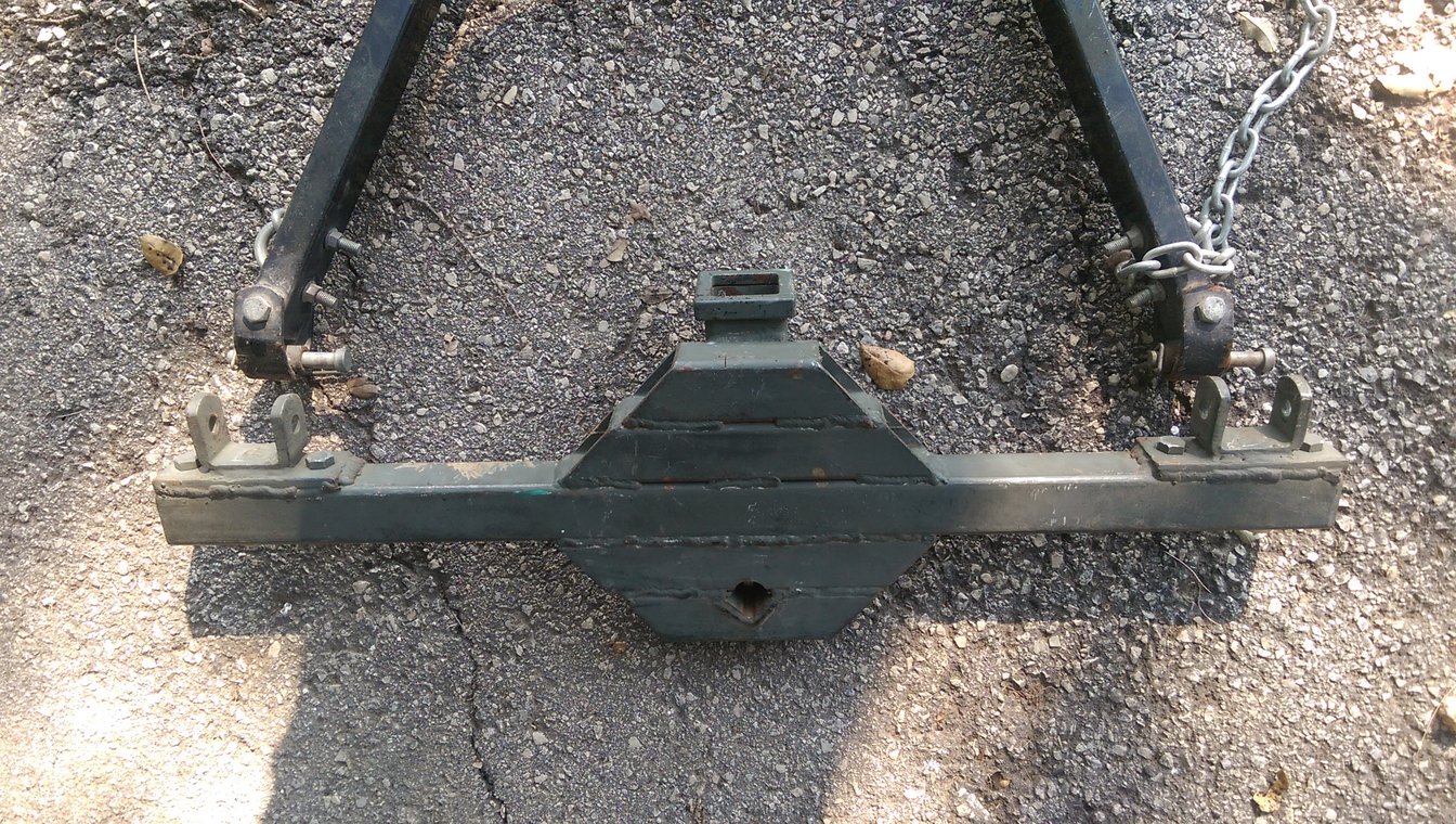

Okay, as promised. This is how my truck's PO did it.
It's a pretty sweet set up, sits just off the bumper and has some rubber pads that cushion between it and the bumper. Has a receptacle for a square hitch as well. The two tow bars rotate at their attachments, so slight differences in bumper height should not be too much of a problem. I have never used it, but am afraid of taking it out of the truck, cause I see the value in it, so it just lives in the back for now.
I Personally would not use this for any sort of highway use. You are putting your truck and others peoples lives at risk based on how good the welder/fabricator was. I could see this used for recovery, broke down on the trail or light off road use only. That said, this is Merica and do what ever the hell you want.
Disclaimer: I am not condoning or sanctioning this in any way, just showing you how another yahoo did it.
My suggestion, get a buddy you trust who can drive the other truck!

Re: Tow pipe?
That is a standard A frame arrangement that works well when set up correctly. They are often used by big bus style RVs here to tow their smaller run around car. In Australia the brakes on the vehicle being towed must operate with the brakes in the towing vehicle and small units that do this are freely available - lights etc as per any van/vehicle being towed also must function.
The A frame requires govt engineering approval - type certification.
an example http://www.northcoach.com.au/ready-brute-elite-a-frame/

Re: Tow pipe?
Looks great Texas710. Thanks for the pics. I will try to get something like that fabricated. If i cant get this figured out iwill just sell one truck haha

Yep, simple enough, just use someone good for the fabrication. If you look closely, where the pin sits is shaped so that it kind of locks in there, like the one on the bumper.
