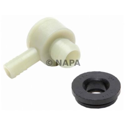

The issue I have is when I reached in under the steering column to check the brake booster, there was just a hole.
Item 11 (suction connection) from the below diagram was missing :
Does anyone have a photo of this part? Is it plastic or metal? Is it possible it was pushed into the vacuum housing?

If you have an open hole it may be a booster housing that was replaced at some time. Many check valves can be found that fit into the housing with a rubber grommet. NAPA has this item: http://www.napaonline.com/Catalog/Catal ... 0480268630 which you might be able to adapt with a little effort.
