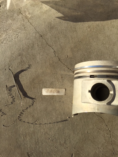

So I finally changed out my leaking oil pan gasket and to my surprise I find this spring thing stuck to the drain plug magnet.
(left in picture)I think it must be an oil scraper tension spring from a piston (compare to new piston on right).
The p.o. said that a "cylinder was replaced" at some point.
Question to the group: could this have come from an operating piston or was it a vestige of the event that precipitated
'cylinder was replaced" event? If anyone knows who Bill Gise is, his name was on the new piston that was in the box that came with the truck.
Engine runs great with 145psi across all cylinders

If the rest of the ring and the spring get through between a piston and a cylinder there is no way your compression can be identcal across all cylinder.
I would assume the mechanic performing the repair was too lazy to remove the oil pan to check for debris

No way that would have come out of one of your piston without some
very serious side-effects, like scored walls etc. This has to be a lazy
boy remnant :lol:
