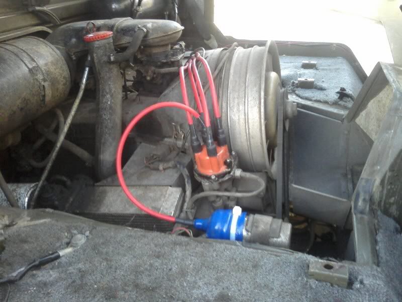

I am assuming you have the most common distributor that looks like this.
- image.jpg (108.22 KiB) Viewed 7720 times
