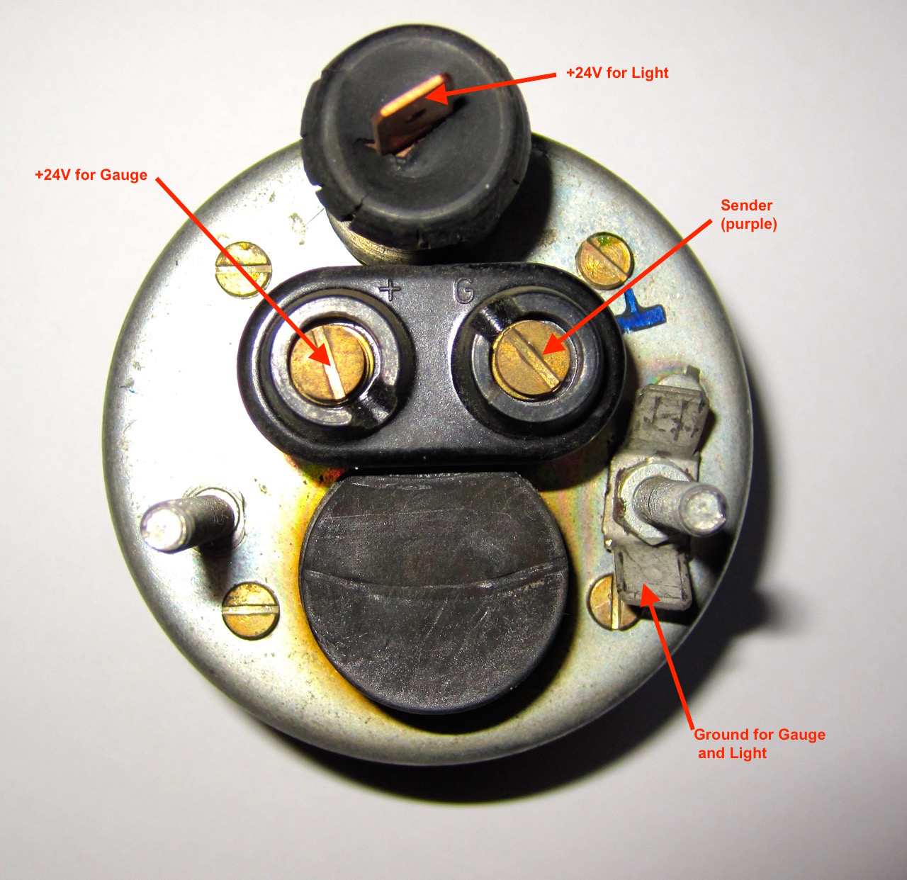

Ok, so the fuel gauge has never worked right...pegged to full with the lights on, jumped all over the place with the turn signal on. Read old posts, seemed to be a bad ground, right? Took the gauge out expecting to find three connections, power, ground and sending unit....out came the gauge, two 24v wires to the power, one purple (sending unit) going to what looks like should be the ground ( G in casing of gauge on right, + sign on left) the spade connectors on each side are the gauge light....what am I missing? Thanks!

The spade connectors are for the ground of the gauge and light. The gauge light goes into the top hole and has it's own connector on it - +24V.

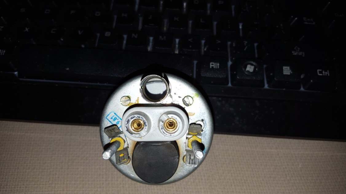

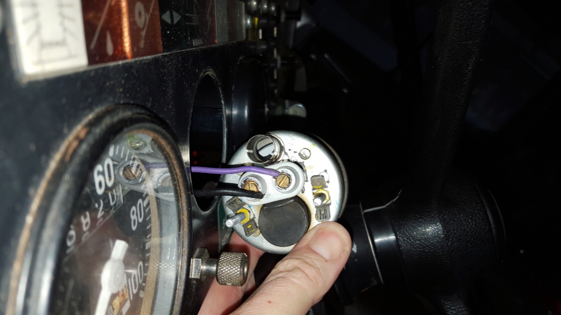

Did you get your gauge working? In tackling mine next and following both threads. I can power mine and get a full sweep but when installed as outlined here I only get empty. New sending unit installed but have not ohm tested it.

Check the wire between the sender and the gauge, it may have been cut or damaged somewhere under the truck; but the most likely issue is a bad ground at the tank. I have had success putting a ring terminal under one of the sender screws, and bring that wire to a good chassis ground. This has helped some "iffy" gauges.
