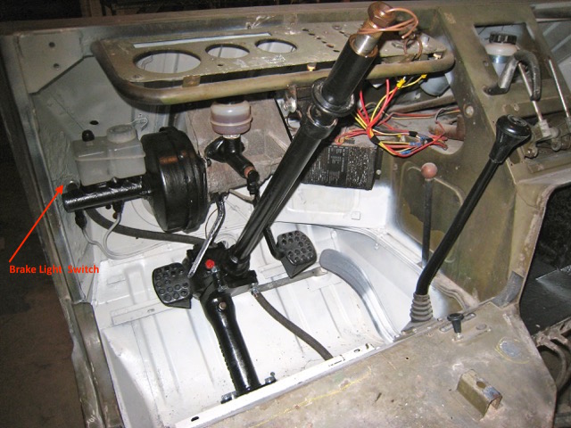

The green and the brown wires are for the brake fluid level sensor(s) and you have wired them correctly. The original reservoir had 2 sensors and the newer model has only one.
The brake lights are controlled by the brake light switch which is a pressure switch screwed into the body of the master cylinder. It's on the front of the cylinder at the left end of it and is difficult to see. It has 2 wires going to it, one providing power and one connected to the rear brake lights. I'd check to see if the wires are still secure as you might have knocked one or both off while changing the reservoir. They are typically spade connectors.
Hope this helps.

Thanks... I didn't even think of that. I'll give it a shot tonight and report back. It has to be something simple. I just couldn't figure it out. Thanks for the suggestion.

Post by John L »
Guys thanks for the input. As usual the input was invaluable. I knew it had to be something simple... but was unaware that the electrical connection on the reservoir was only for the warning light. I checked the spade connections on the brake switch on the master cylinder. The bottom connection was loose. I installed it, and no joy. Still no lights. But then I remembered in the process of installing the reservoir I removed the electrical connections all together. So, I switched the connections and put the red on the bottom and the orange on the top. It worked! I have brake lights. Thanks again for taking a minute to shoot me in the right direction. Levers down! John
