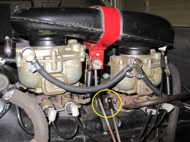

One other area to check - occassionally the engine tin beneath the throttle linkage on the rear carb becomes bent upward and interferes with the full return of the throttle linkage. Here's a photo with the offending area circled:
Make sure that the throttle lever is returning all the way to the idle speed adjusting screw stop point.
