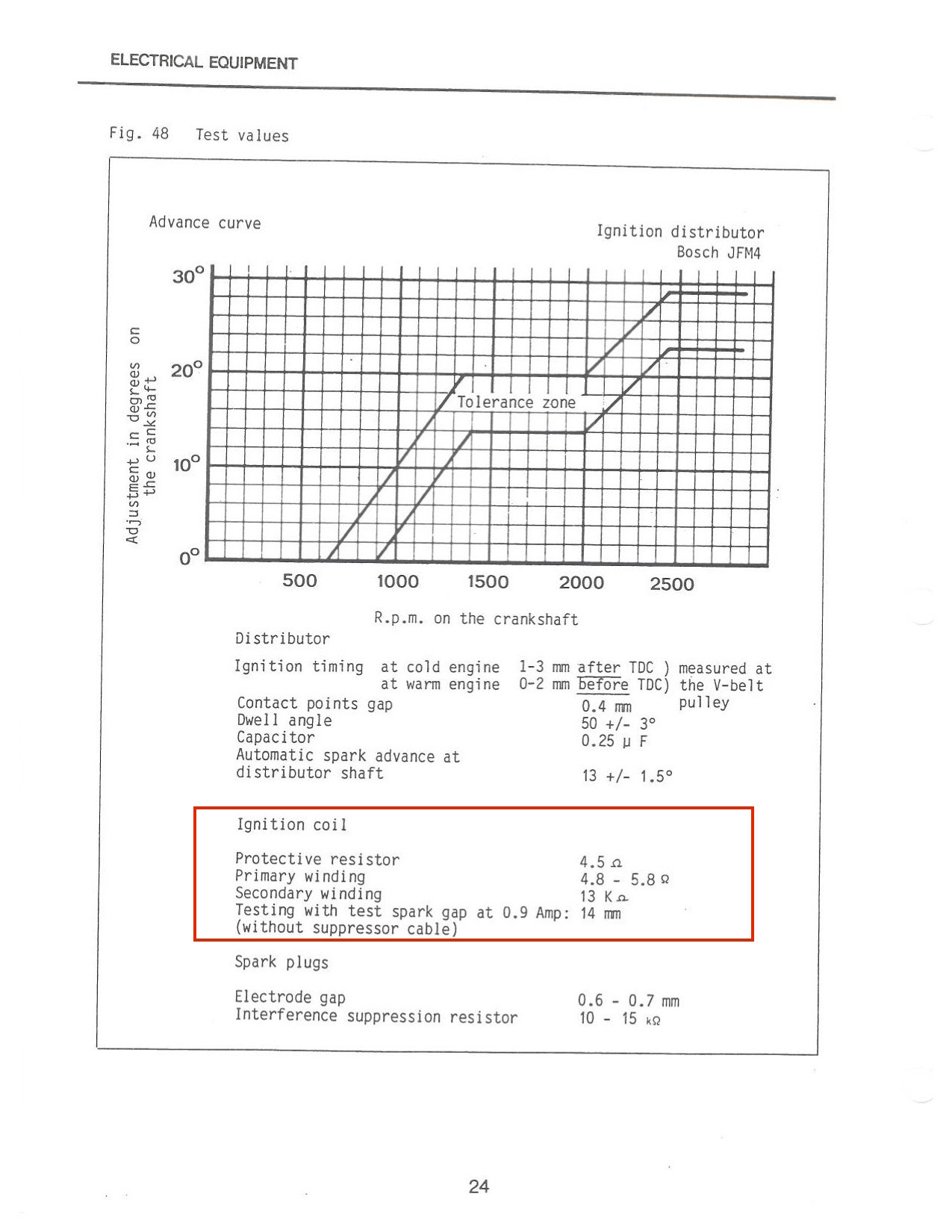

I'm trying to find out if my military ignition coil is still up to snuff.
I did a test and came up with 5 ohms for the primary windings,
and 13.17k ohms on the secondary.
Does anybody know what the specs are supposed to be?
Thanks much
'76 710K
Re: Is my OEM military ignition coil still good?
From the Service Manual:
mm58
Posts: 241
Location: Tucson, AZ
Post by mm58 »
Awesome...thank you! Looks like I am just about right on spec.
