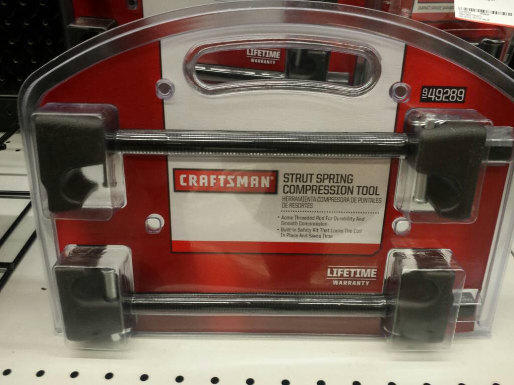

Saw these spring compression tools at Sears ($39) and wondered if they'd be a good fit for the Pinz springs. Anybody have experience with these?

I haven't seen these before, but on visual it doesn't look like the
top Jaw will clear into the top cavity or reach deep enough. Jim L.
has a template for making a clone of the Pinz extractors, I'd go
that route.
Re: Will this spring tool work with Pinz?
NO!!
While they might, maybe, possibly do the job, you are probably just as likely to discover whether the afterlife is for real or need to have an emergency spring-ectomy performed on your head.
Regardless of whether it actually fits or not, it's an entirely different tool. Get the original, or another one built equally stout.

Not for the front springs. Those take a special tool, don't try to improvise.

Ok that's what I needed to know. Thanks for the replies. I will take a pass on this tool
