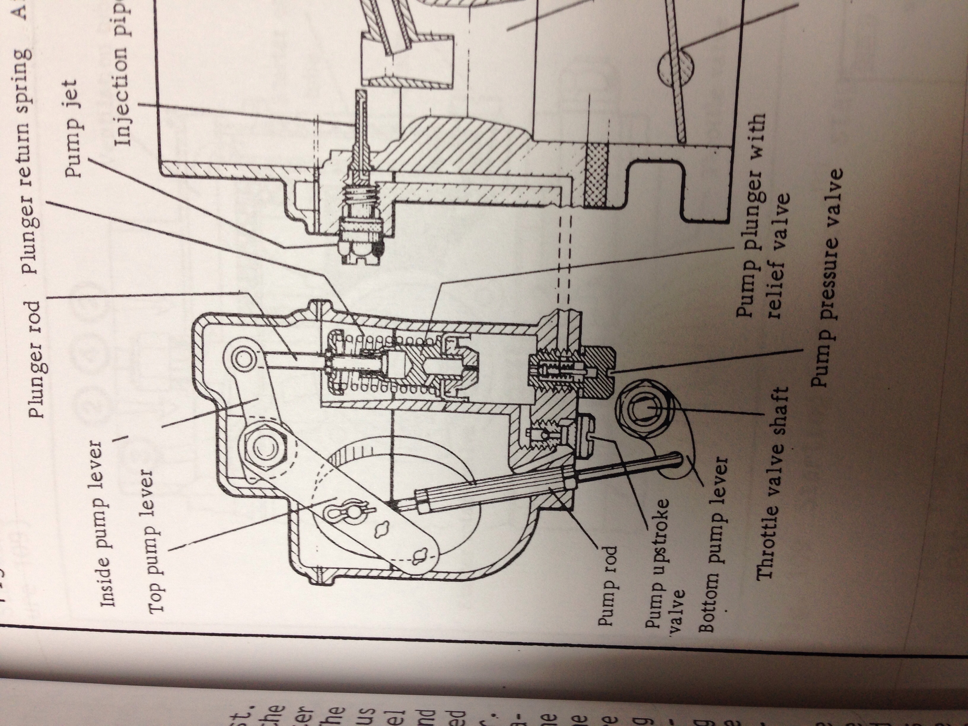

Interesting comments on the accelerator pump lever. I checked the repair manual. Two drawings show the lever connected to the hole closest to the pivot point at the top of the carb. This is where mine are connected and how the carbs came. But a photo in the repair manual notes the lever mounted at the lowest hole where the return springs mount. So there's a bit of a discrepancy. Do you suggest I move the lever so it's mounted at the lowest hole where the return spring mounts? I'll post photos tomorrow of what I'm referring to in the manual.

Here's the other diagram. My lever is connected like these diagrams.

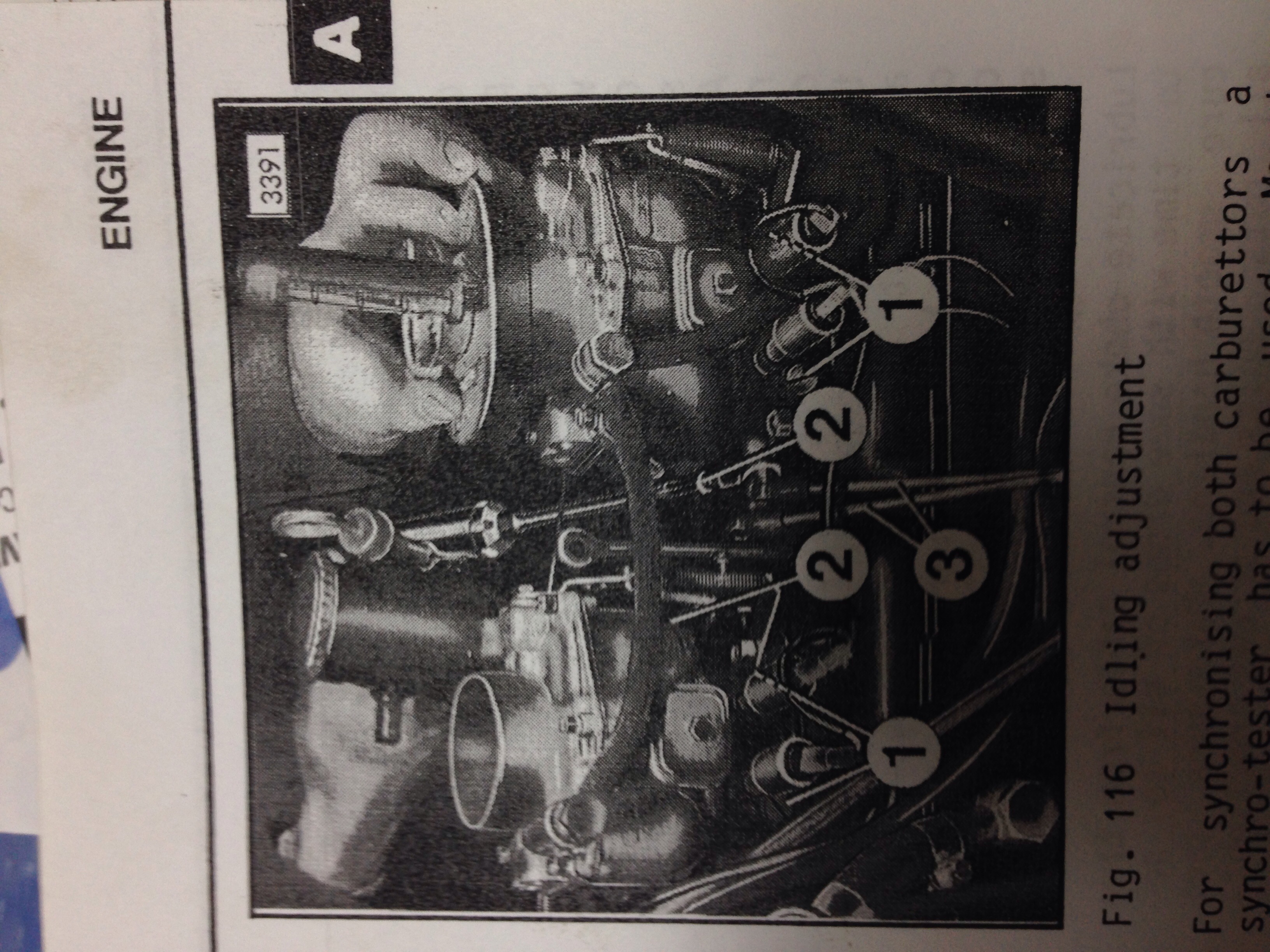

Here's the pic in the manual which appears to show it mounted at the spring return hole which is the lowest hole and/or the one farthest from the top pivot point on the carb.

I believe the rod has to be a certain length, too. This might affect the volume of gas pumped, since the piston would be higher or lower in the cylinder.
Re: Loss of power and backfire: help!
I believe that the drawing is correct, with the linkage in the innermost hole -- this will give the largest piston movement and the most amount of fuel (if the lower lever had multiple holes then the linkage would need to be in the outermost hole there for the most movement. Pardon my confusion). I did not realize the rest of the accelerator pump valving like the pump upstroke valve, pressure valve, and plunger relief valve - any of these could be causing trouble, too. But the first question is: how much fuel do you see squirting into the carbs (with the bowls full of fuel, just after shutdown)? The cylinder bore and piston travel probably can squirt something close to a tablespoon worth of fuel going from idle to wide open throttle. You should see the same amount flowing in both carbs. IIRC it will come out as a stream of fuel when you look down the carb venturis, not a dribble or atomized spray. If you see a good stream then the accelerator pumps may not be your issue.
