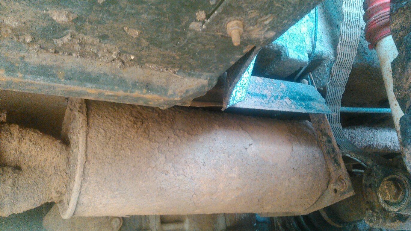

Hi everyone. First time poster. I have a new to me 712K that has its exhaust pipe routed straight back out of the muffler, and runs underneath the body to the back of the vehicle where it exits out the side. The pipe threads through a narrow gap between the floor of the box and one of the support arms on the central tube for the double axle. The exhaust pipe is actually pinched a little to make it fit in this narrow gap and rubs against the top of the support arm. I will post a picture of it. The rear is dropped in the picture, so the clearance looks bigger than it really is. You can see the rust leaving a rub mark on the support arm where it hits.
My question is, have others tried routing the exhaust pipe more in the wheel well so it bypasses this narrow gap and did it create any problems? It seems a bit more exposed but wondered if its really a problem.

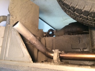

Last october I have seen a 712K with an M-type exhaust , sightly modified
I took this pic as an inspiration

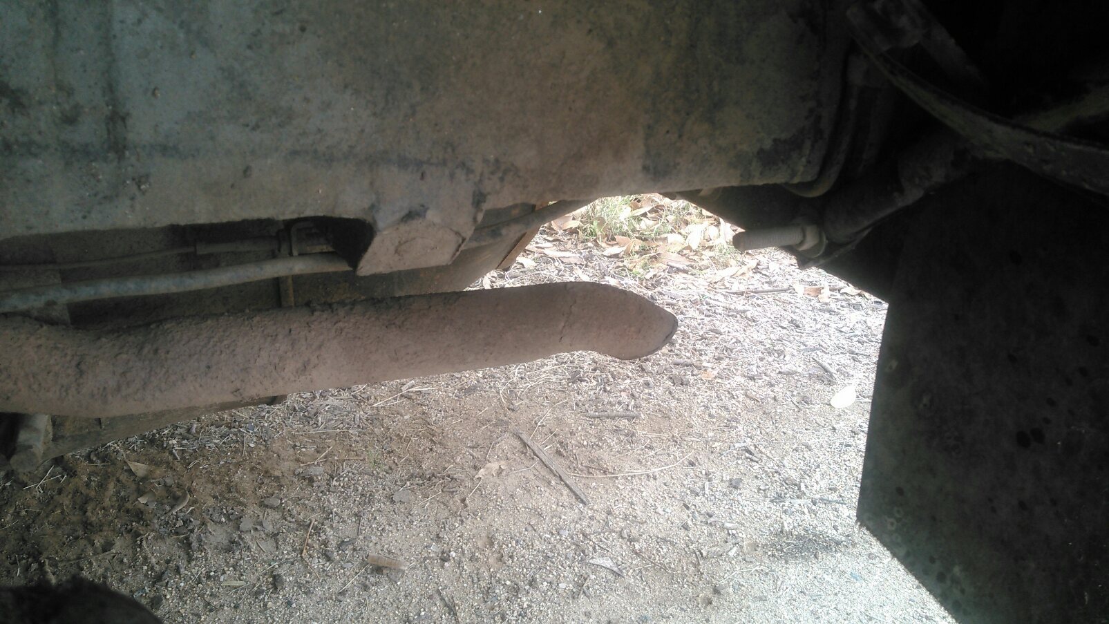

I had a SS "small" (louder) muffler installed about 12 years ago; the muffler exit was at the rear so they routed it this way:
Originally they had routed the end straight outwards, but I added the curved tip. It is not supported anywhere past the rear of the muffler. It does shake a bit but not enough to rattle against the body.

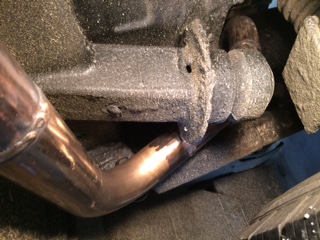

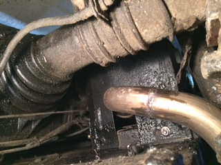

I thought I would post a couple pictures of how the exhaust system was eventually routed for whoever the next guy is that has to do this.
