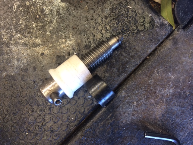

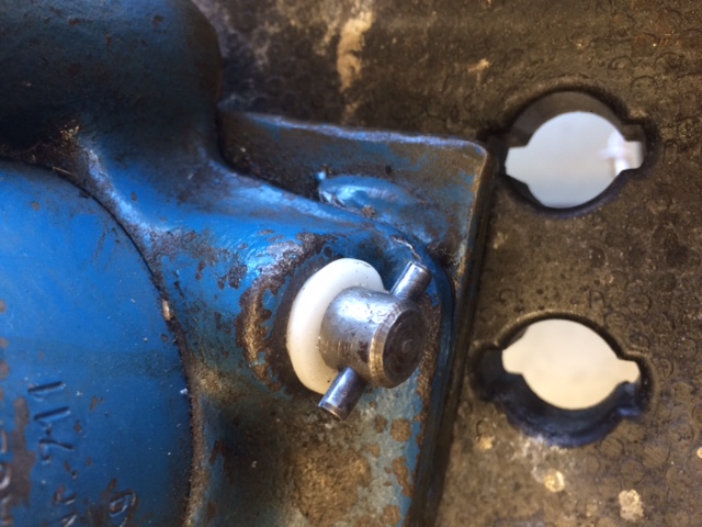

My jack was leaking from the valve that relieves pressure on the jack. Since that was the only leak I decided to try to fix it myself. I machined a piece of Delrin to fit over the valve stem which will compress rubber seal. So far no more leaks.
