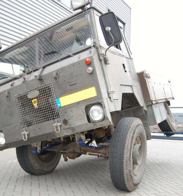

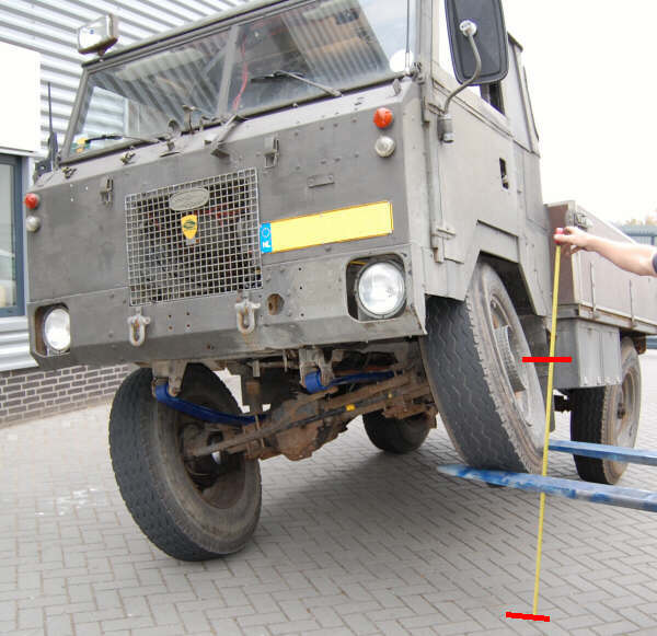

I would confirm with Paul the load rating of his springs as in most circumstances the old army load ratings are not needed and softer springs make for a much nicer ride.
My Landrover 101 FC has parabolic springs as standard from the factory and even though they are only 2 leaf given its 1.5 tonne load capacity you can imagine that in light civilian use, the standard parabolic springs do not provide much flex until it is loaded up.
Hystee used to carry stock for the 101 and these had a reduced load rating, more appropriate to civilian use and performed great with a nice ride and great flex while still having a good load rating for everyday use. Unfortunately Hystee has decided not to carry these springs any longer on the shelf and like the springs you guys are looking at, have to be made to order - the 101 fraternity has never got the numbers for a new production run.
I hope you can get enough numbers because they are a good product but if you are going to carry heavy weights near your load capacity, double check that the hystee springs will still meet your requirements.
Garry
Hystee Springs on a 101
