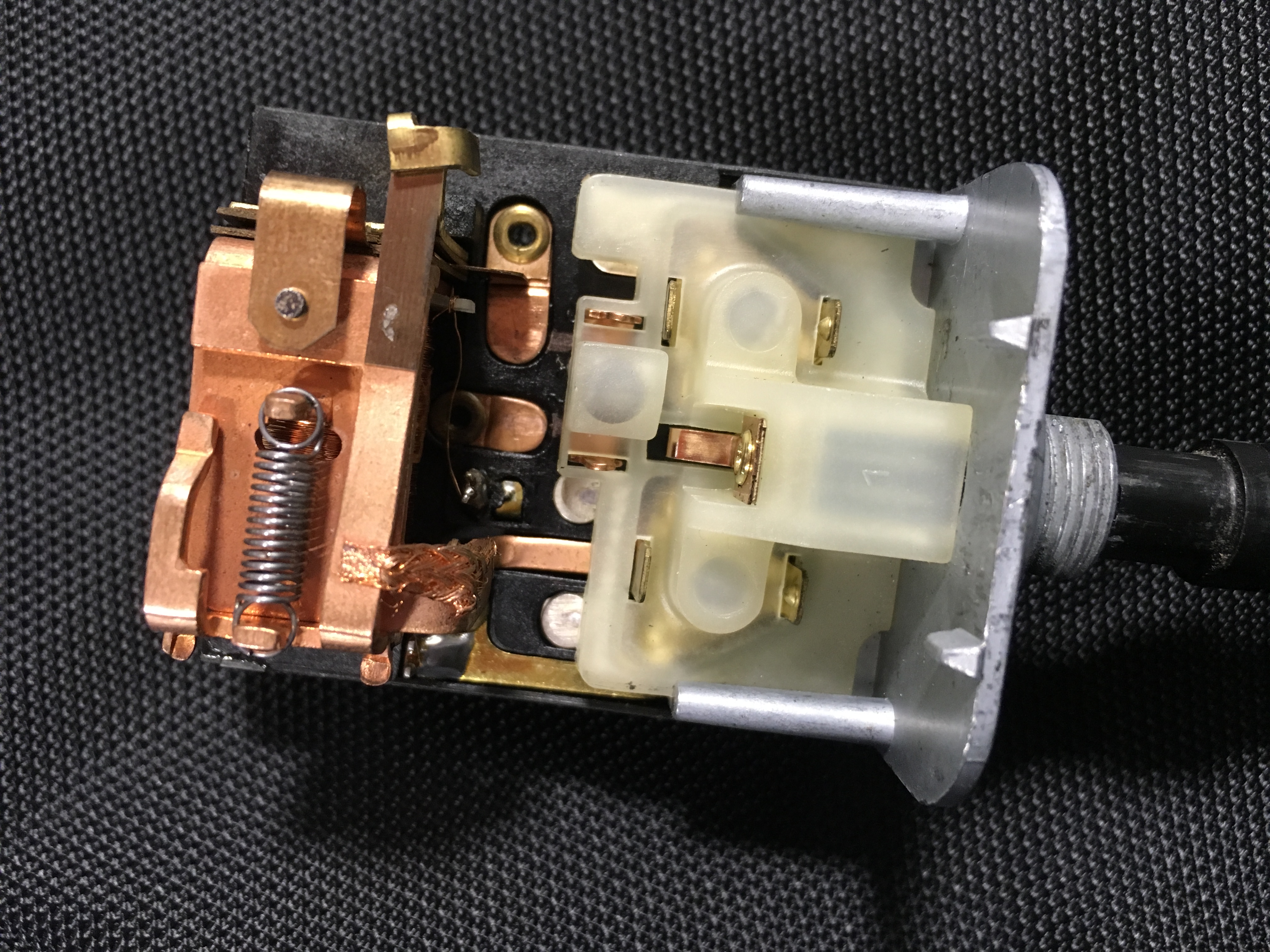

Sonarman
Posts: 80
Location: Sonoma, Ca
Re: Brake light/ Ignition switch
Post by Sonarman »
Took apart emergency flasher switch it looks like new inside. I still took my my meter and did checks of alll contacts with switch open and closed.
