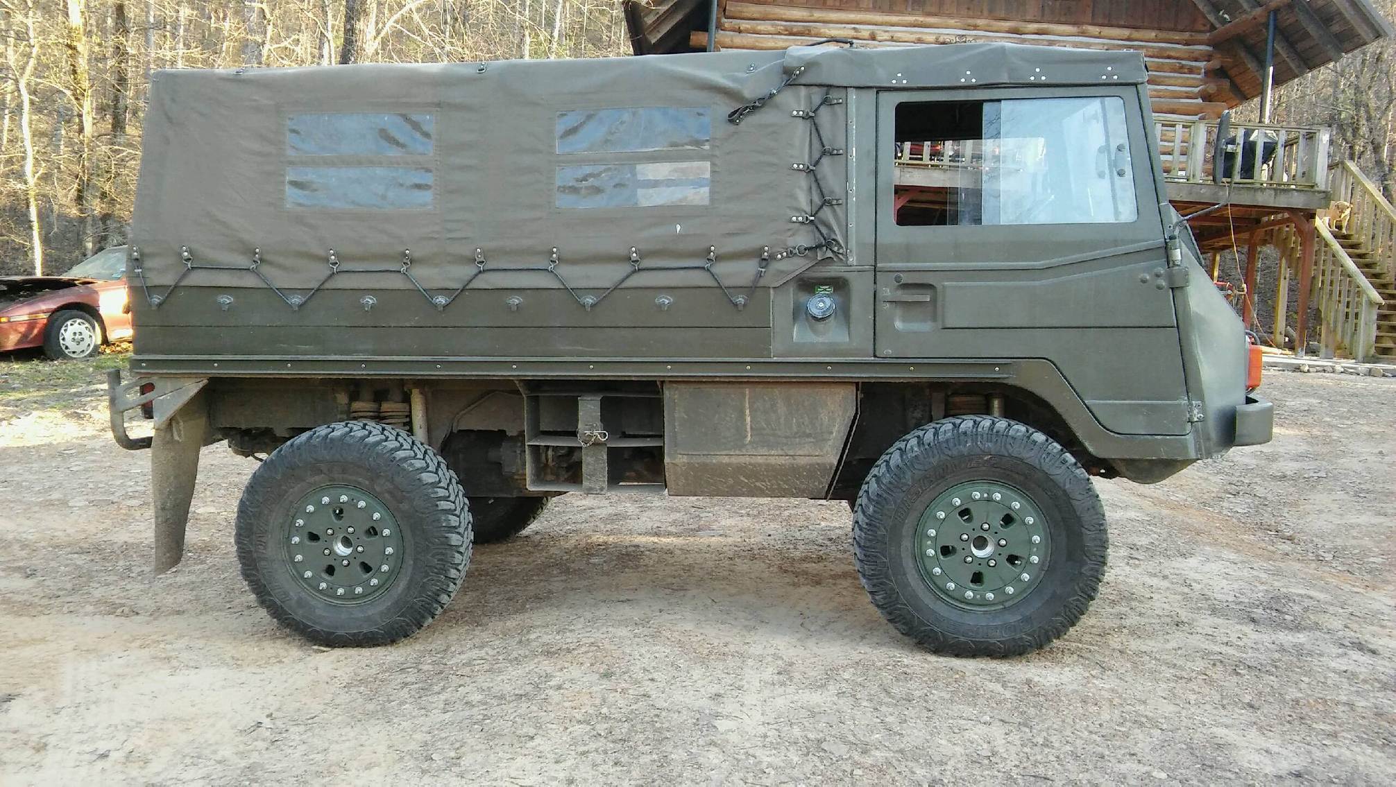

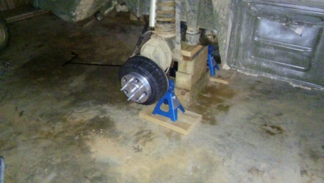

Pics of wheels and adapter
ziegler
Posts: 100
Joined: Thu Mar 13, 2008 9:21 am
Location: oklahoma
Re: New hutchinson wheels and adapters
Post by ziegler »
Adapters and wheels ordered though HEM industries in Dewey Oklahoma, ask for Jim. Metal rub rail, dual gas can holder, electric steering, solid state ignition, carb work, etc. done by the great Andre of Fat Fabrications in Mount Pleasant Tx.

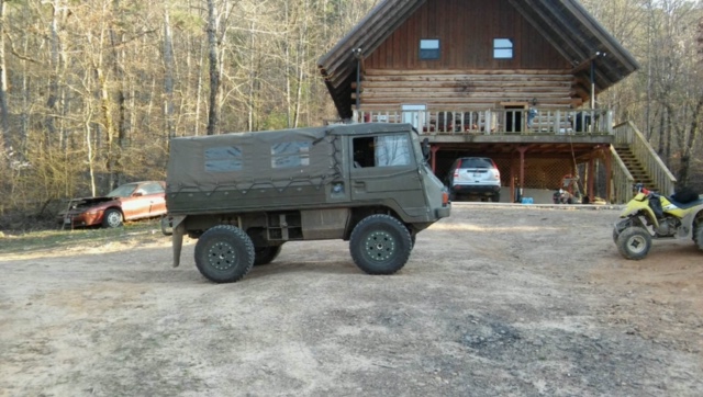

More pics of truck and log home truck built
Curious what size tires your running, my guess would be 285/75.
With the added extension, don't be too surprised to hear wheel
well rub on the front right side. Looks like you have about 2" of
clearance there.
That's been a tight spot for me with 8" wheels and 285/75. The
plus is you just increased your tip stability by 6% with what looks
like a +4" increase in overall track width.

Cost was like 460.00 per wheel and the tires are 285/75.

any down side by using those kind of adapters for the wheels?????
