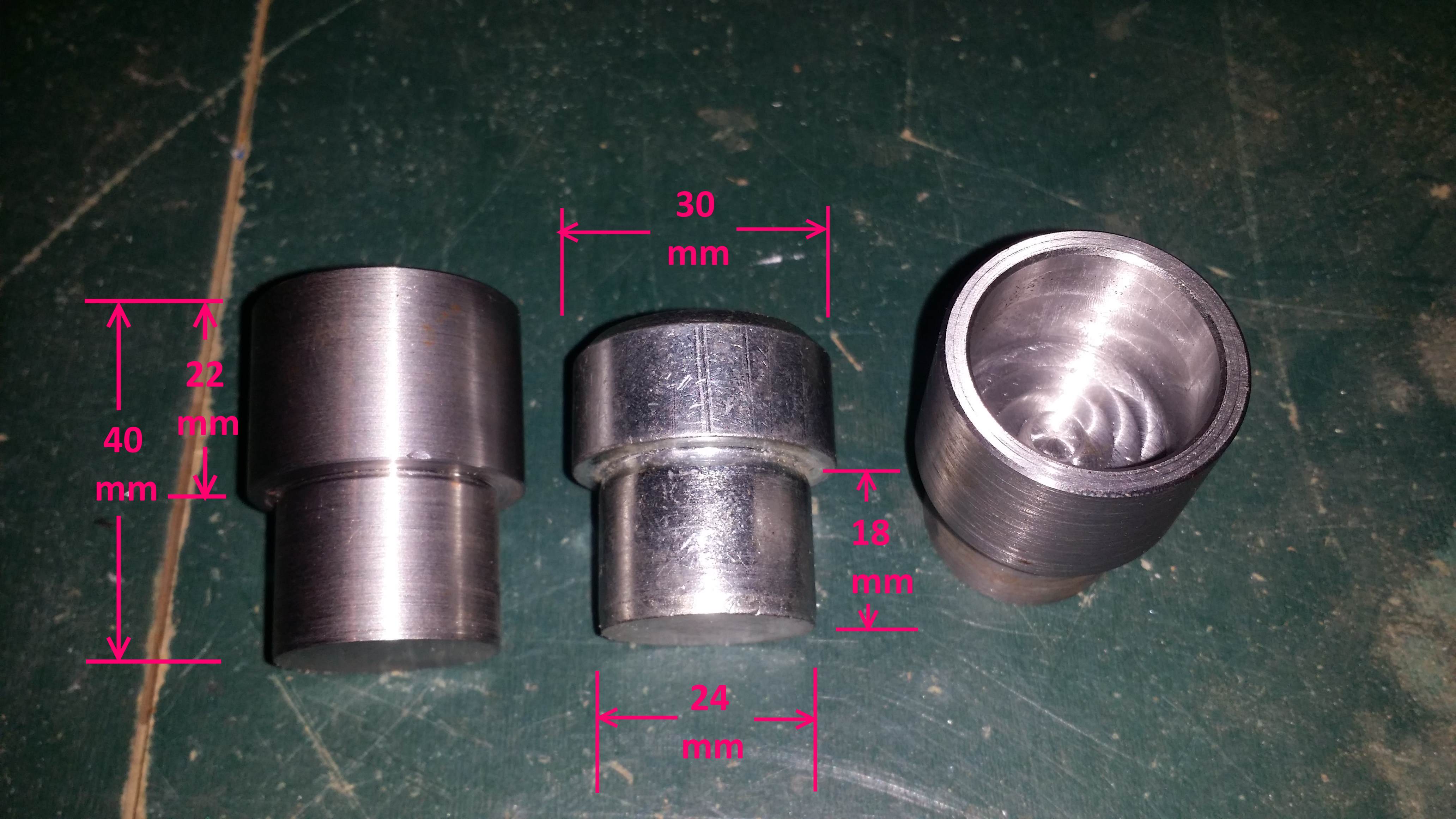

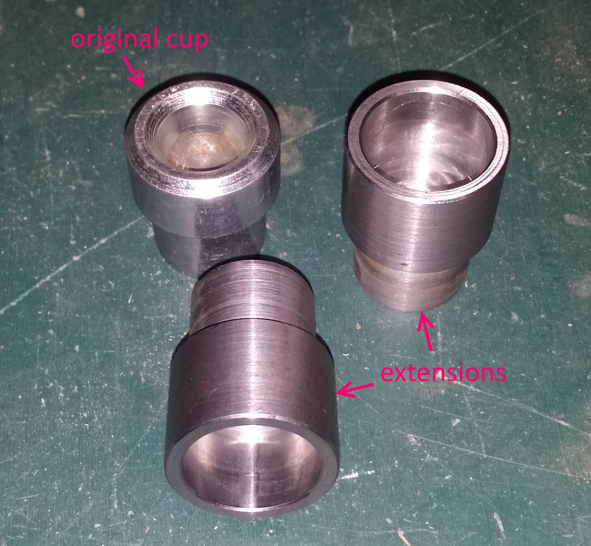

A while ago I had a friend make me up a set of front spring spacers to extend the original ball "seat" part downward. I haven't put them in yet. I would be willing to supply them to GadgetPhreak's truck if he wants to try them out. I can always make up another set - they are pretty simple.
There was a slight mis-communication and the height of the extensions was only 22 mm - which is about the minimum that a part can be made for this approach to work. I was wanting it to be 1 inch / 25 mm instead.
Here are some photos with dimensions:
This approach retains the ball seat for the upper spring cup. It would be hard to replicate the original part's inner curved surface with a simple lathe - so the idea of making an extension seemed like an easier approach.
Thoughts?
Thoughts?
