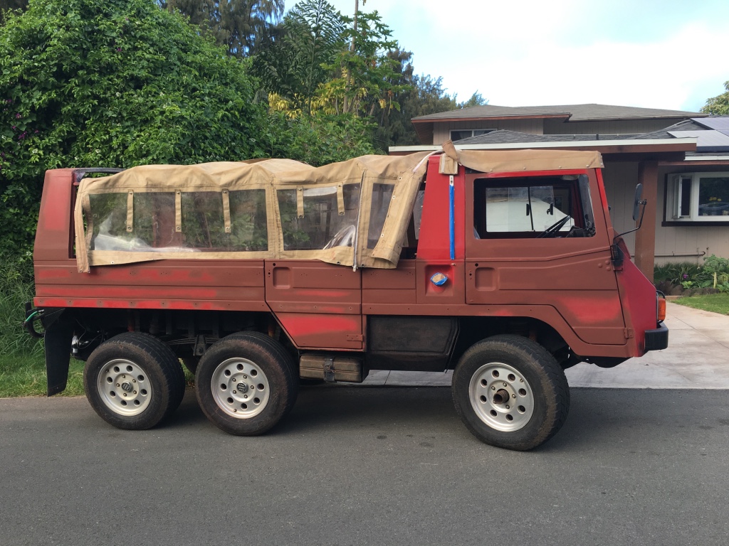

Just saw this ad - love the rear doors!!
https://denver.craigslist.org/cto/6007129791.html
Located in Honolulu :(
Re: 712 almost DK with a bit more work :)
and they've been dipping the ass end into salt water!
well seasoned :)

712k with the hard top removed and canvas added. I like the way David's 716 worked out when he did that to his.

IIRC, this looks like the same truck that was for sale in the last year or so as an incomplete project .
The ad does say it was a "M" originally and the doors were added. Many of the pics would seem to support this. The truck has all the original cleats for the soft top and the new tops doesn't use any of them. The latch jambs behind the doors do not appear to be made of the structural (or rigid) metal common to all K's. For the life of me, I never remember seeing a Swiss spec 712K through all the years of the Thun auctions...??
One of my main concerns would be if longitudinal structural supports were added to the body where the door openings were cut into the pan. The folds in the M's sheetmetal adds lots of structural rigidity.
Thank you Andre... I was extremely happy with the way the Pick Cow came out... just shoot me if I ever think of trying that to GG. :lol:

That Pinz was on here previously - but in rougher condition:
viewtopic.php?f=9&t=10441&hilit=hawaii

712DK can now be easily had with the Austrians now surplussing 712K's. A couple of rear bedside panels, a rear roll bar, other odds and ends, cutoff blades, a welder and some time. One or two weekends and you are there.

i am lasy on this one ... i have seen these many times .
Can any of you guys tell me what kind or rims are on this islander pinz please ?

yano wrote:i am lasy on this one ... i have seen these many times .
I believe they are Cepek (?) rims - originally made for Hummers / HMMVs.
