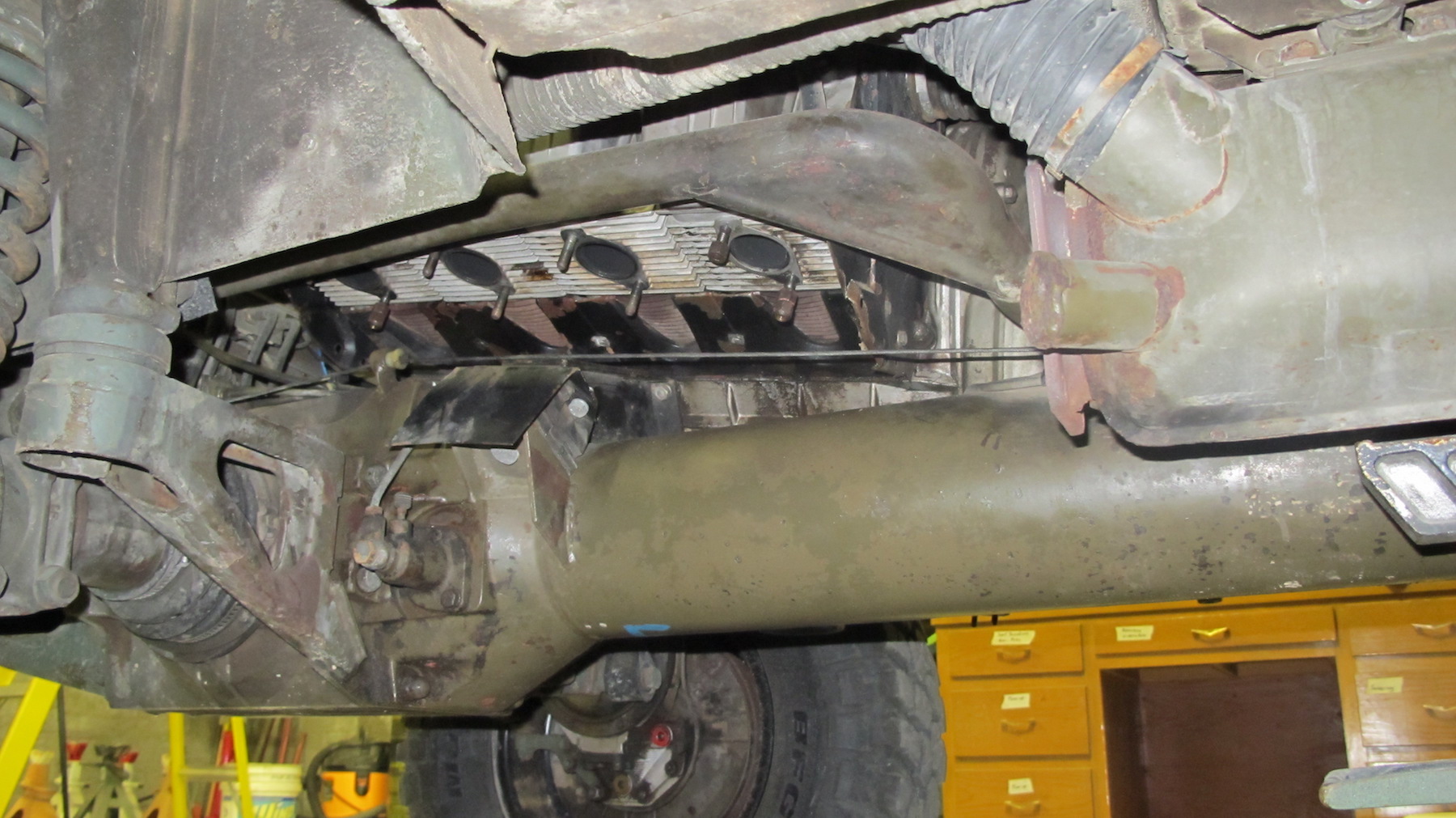

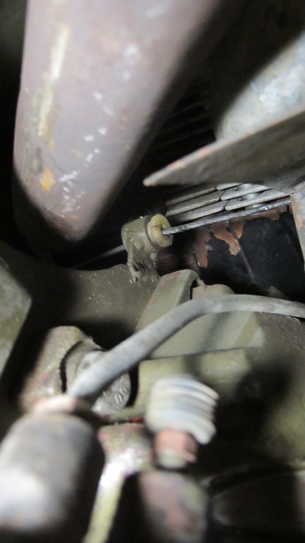

Here's some other pictures of mine, clearly shows a guide.
IMG_1856 copy.jpg (458.61 KiB) Viewed 4469 times
IMG_1857 copy.jpg (137.57 KiB) Viewed 4469 times

Thanks for that, however I'm wondering how it mounts.
Is the bracket welded to the top of the backbone?

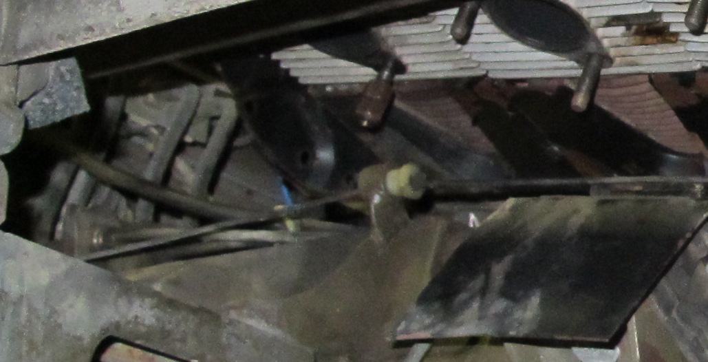

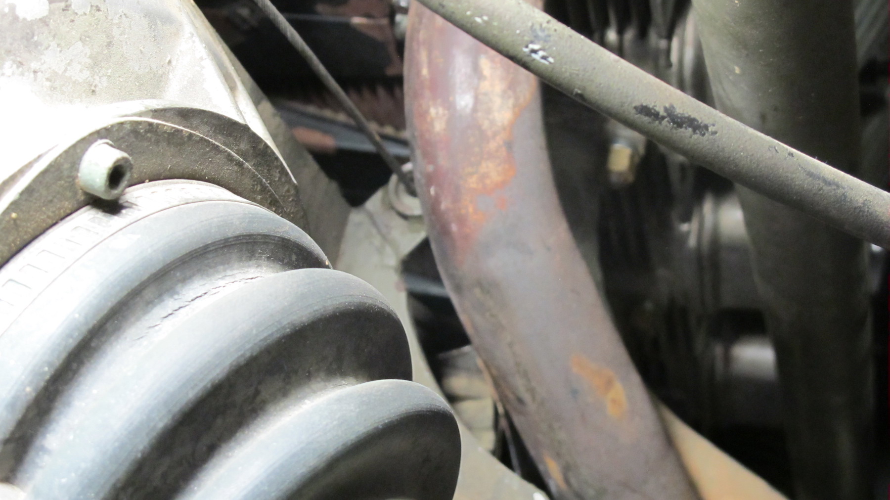

Yes, it's on a bracket welded to a gusset. Better pictures from rear and front.
E-brake cable bracket taken from the rear.
IMG_1886 copy.jpg (364.17 KiB) Viewed 4441 times
E-brake cable bracket taken from front
IMG_1888 copy.jpg (365.04 KiB) Viewed 4441 times

Aha I see... Welded to the steel sandwich piece between diff casing and the back bone, no wonder it's not detailed in parts drawings.
I wonder what on earth happened to mine, there no evidence of anything ever been welded there. I had always assumed some kind of bolt on bracket was missing.
It's going to be fun trying to get a weld in up in there....ill probably have to take the headers off.
