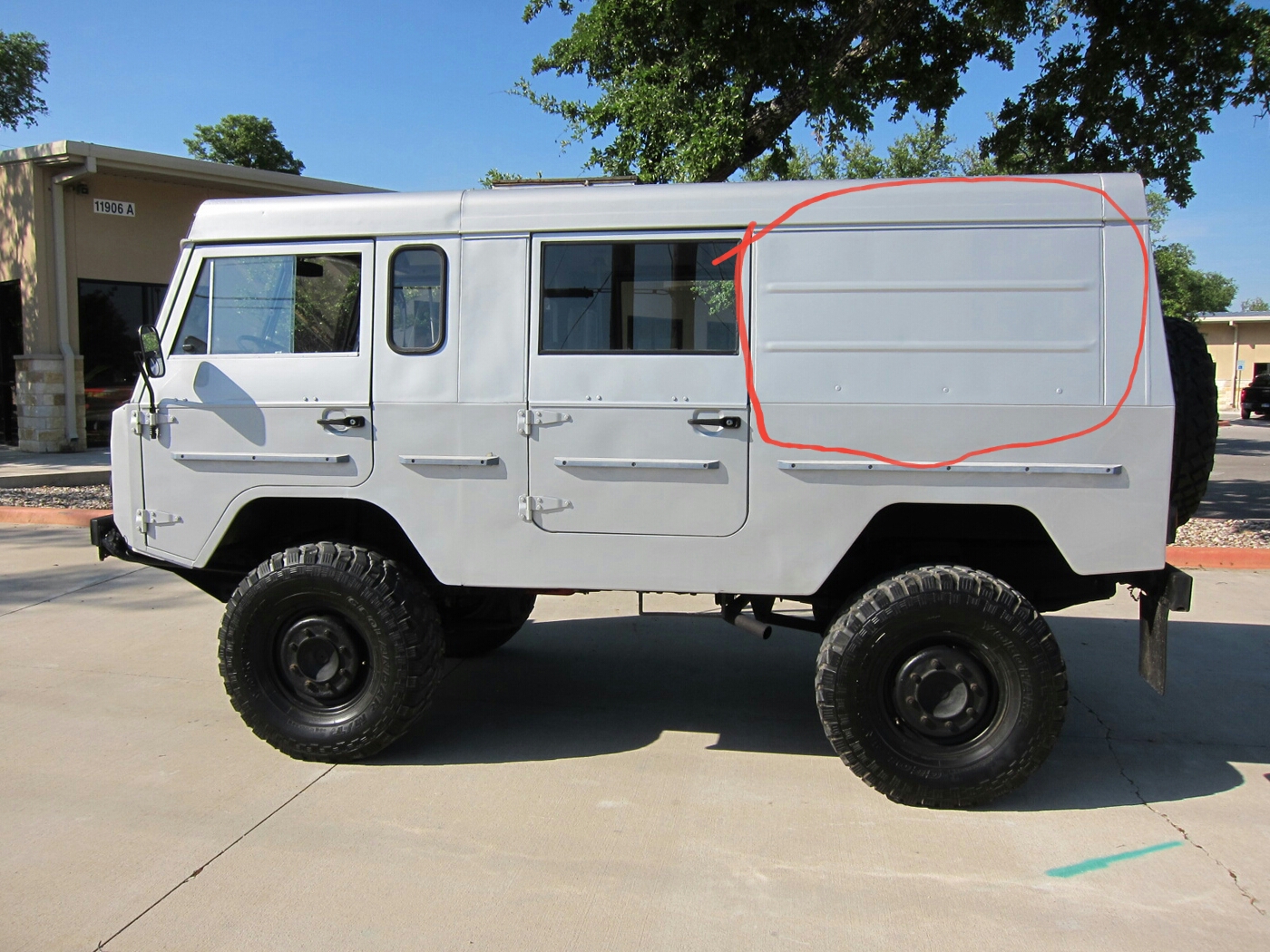

Does anyone know how easily the rear side panels come out? I want to have someone make some replacement panels and was going to take the old ones out that they can use for measurements. Before I get too into it though, I was wondering if anyone has taken theirs out and perhaps even have some photos of what they look like taken out? I haven't looked super close but I only see a couple bolts at the bottom of the panel.
Referring to the circled area in the attached photo.

it's a curved square. :D should be easily duplicated by any good fab shop.. Originality is not a big issue with these trucks, as MANY have been chopped up for the awesome axles!

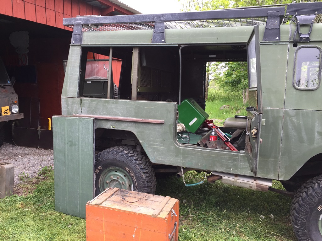

I took the three bolts at the bottom off but it's still stuck in there pretty good. Guessing it's the seal/glue holding it in still. Will probably have to cut the seal from the outside to get the panel out.
I'm taking them off because the previous owner cut out a large piece of the panel to put in windows. I want to restore it to original but need to bring the panel to a fabrication shop so they have something to work from.
