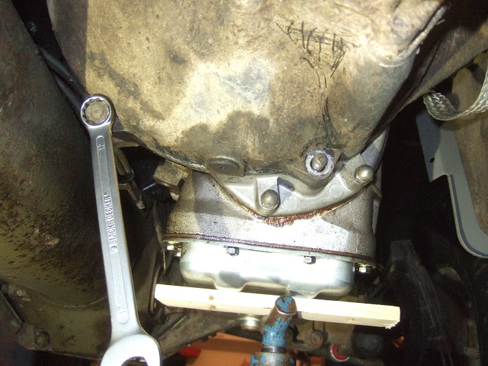

1 - First support the engine-oil-tray with a Jack-stand: Use a regular jack to lift the engine 1-2 mm max and then put a jack-stand under it with pieces of wood, so it fits tight

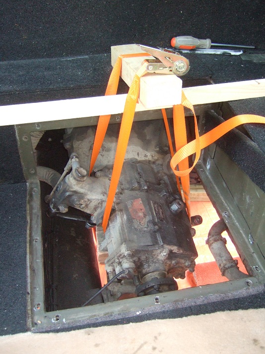

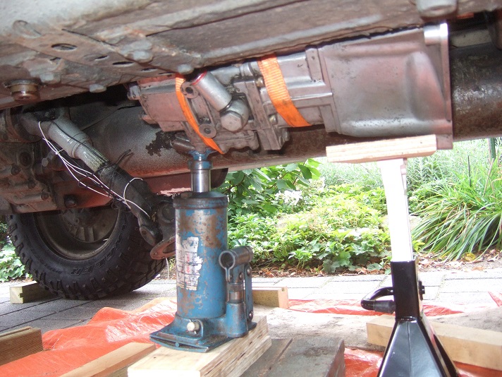

2 - Build a make-shift bridge to hold the gearbox later with the ratchable strap (Don't use a thin crossbar-beam like I did, but had nothing else... It needs to support 39 kg)

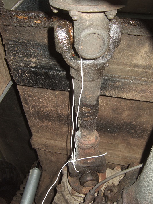

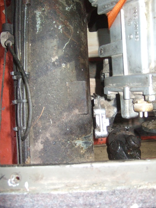

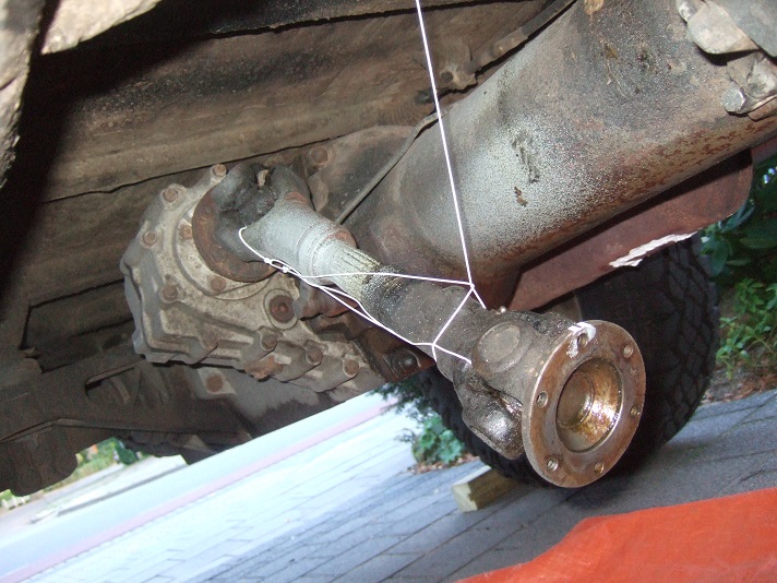

3 - Wire the two ends of the cardan-shaft, so they cannot slide apart (some mark them, but with all that grease easily wipes off). They are balanced together and when they're apart: no telling of the correct position anymore (This is more fool-proof, like for me...)

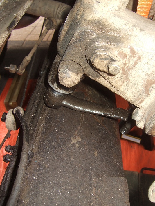

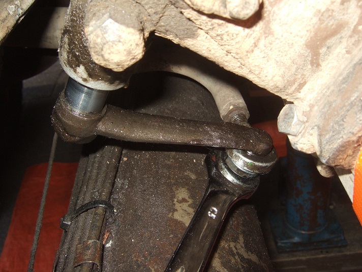

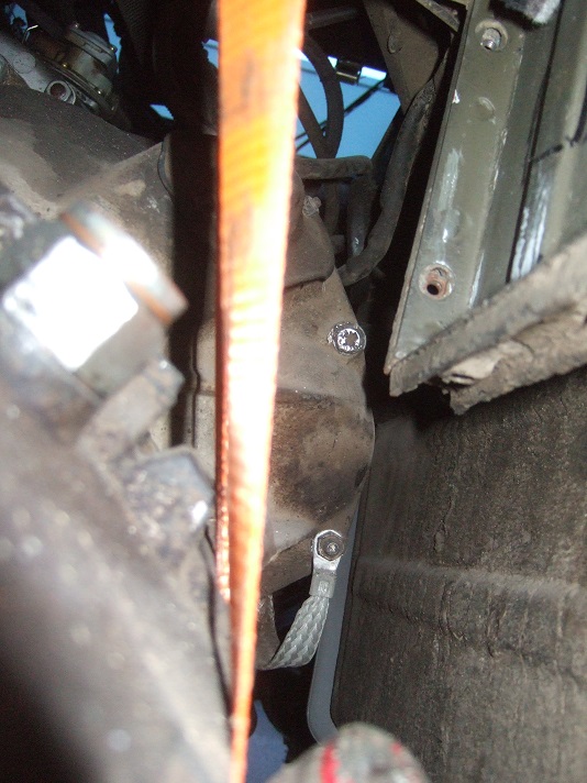

4 - Remove the nut (size 17) from the gear-shifting-rod-guide that connects to the weird two-pronged bit at the end of the thick tube
5 - Remove the nut (size 19) that connects the gear-shifting-rod to the gear-selector-arm of the gearbox. Keep the ring under the nut together with the nut !!

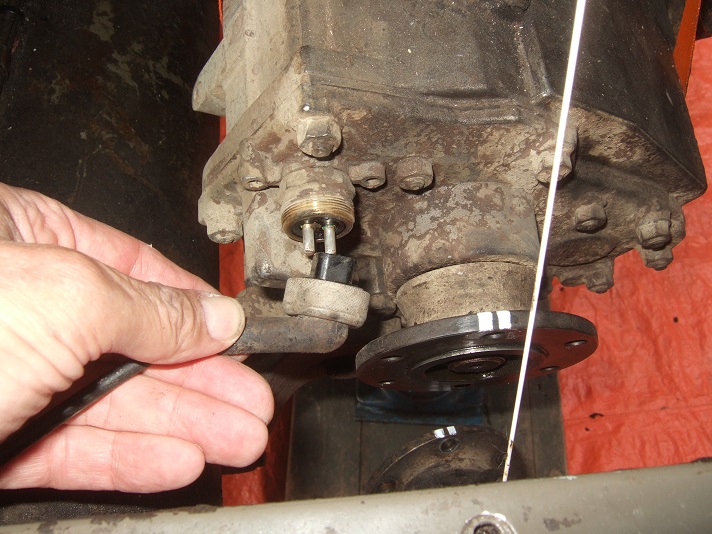

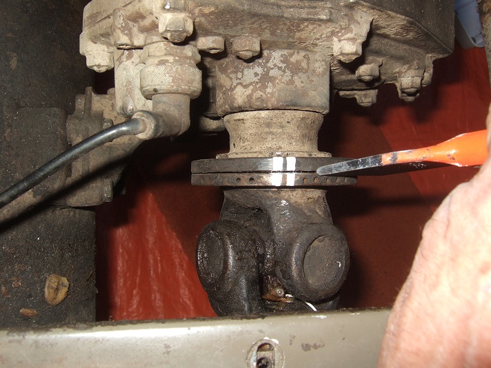

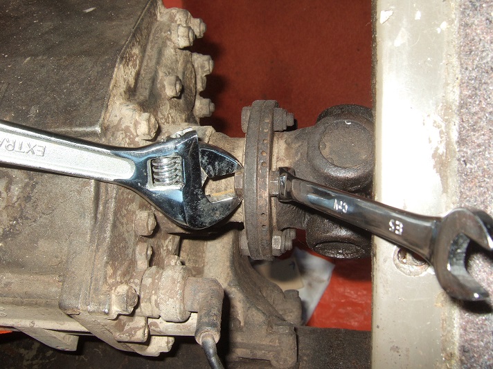

6 - Unscrew the 6 bolts and nuts (size 13) of the cardan-shaft at the gearbox end
7 - Ensure that the wire, holding the cardan-shaft-parts together, is tied off somewhere above, so the cardan-shaft cannot fall all the way down.
8 - If needed; pry the two apart, mine spilt a tablespoon or 2 oil with it, when the cardan-shaft suddenly parted...

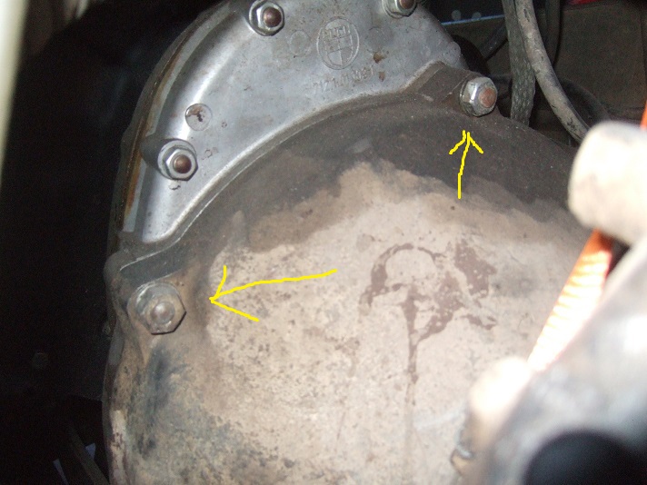

9 - Remove the 4 large (size 17) nuts from the bellhousing, two ON BOTTOM... (Ratchet with 17 socket is easier to use , but I just could 't find the 17 socket...
10 - and two size 17 nuts ON TOP...

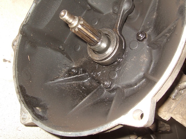

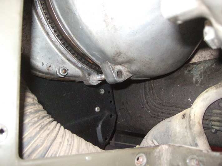

11 - Near the startmotor - top-right - remove ON TOP: one bolt (size 13) without nut  and BELOW: one nut (size 13) with earth-strap. Needed a 6 Allen-Key to hold the bolt at the back

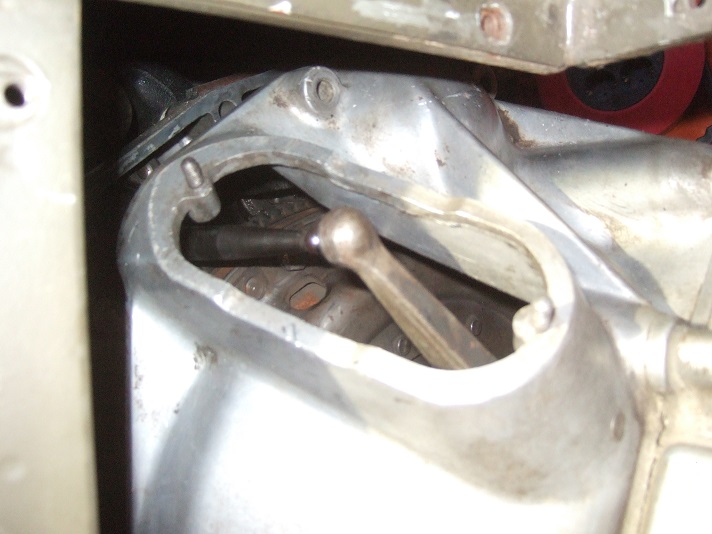

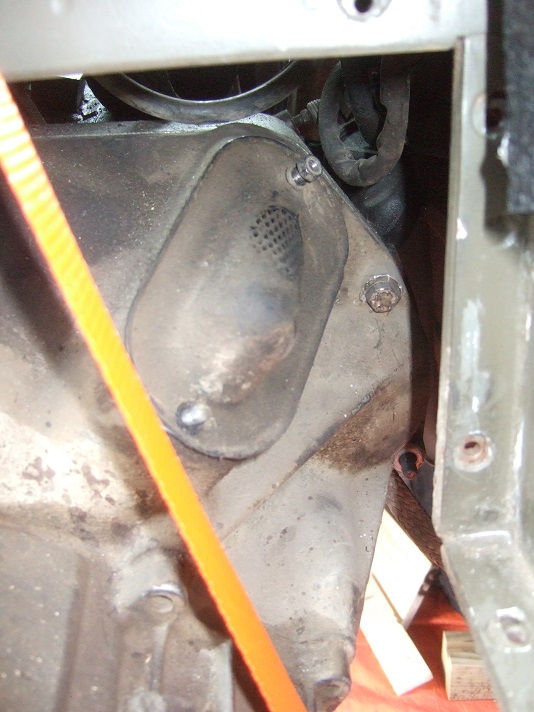

12 - Remove the 2 nuts (size 10) of the breather-cap, then remove the breather cap itself
13 - Push the thrust-bolt backwards and jerk the release-fork from it, mine went real easy

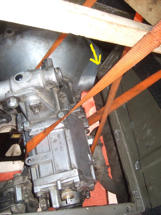

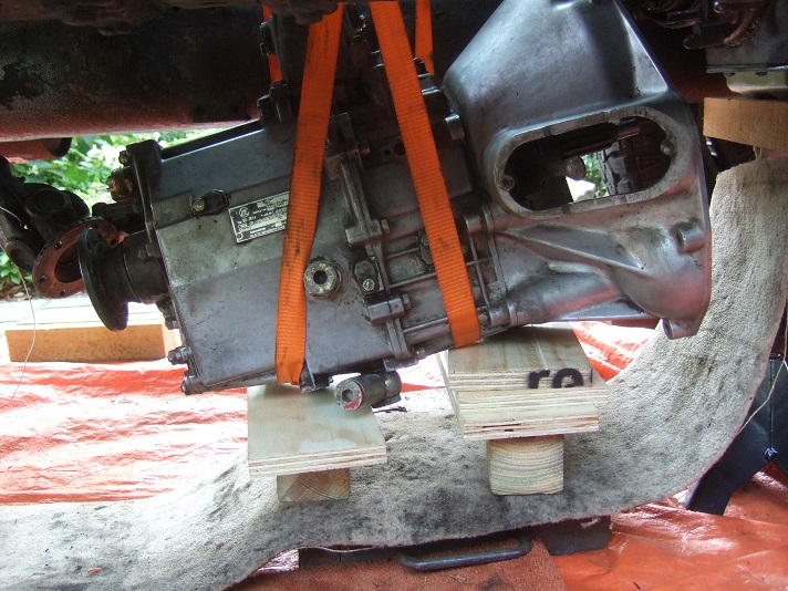

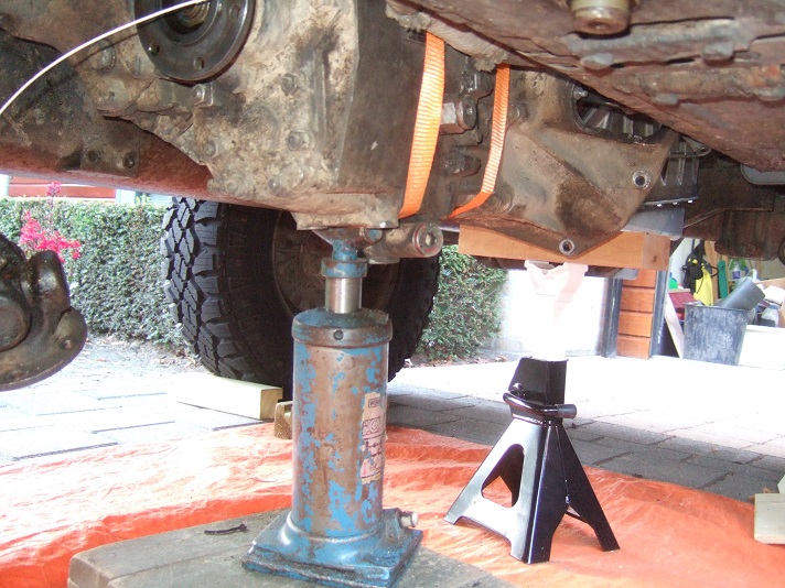

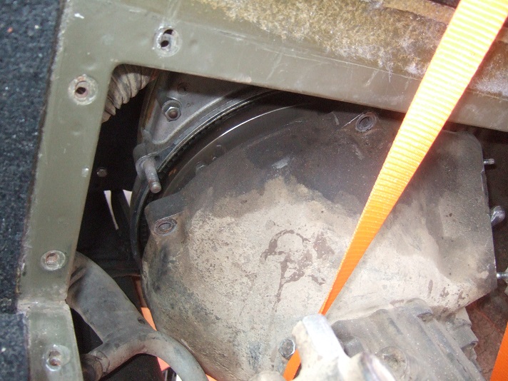

16 - BEFORE you loosen the gearbox and bellhousing MAKE SURE you have it all supported in the strap and with a jack below it, so it cannot fall down. You now have to grab hold of the cardan-shaft -end of the gearbox and wriggle it up and down and pull backwards at the same time (Muscle-power needed)
17 - Once loose; you cannot lower the gearbox as the gear-selector-arm gets stuck on the main beam, so you have to turn the unit sideways...
18 - Once turned sideways, lower the unit
19 -  Support the unit with a jack, loosen the strap and have the jack assist its descent until the strap is tight. Support with jack and re-loosen the strap. Lower it with the jack, etc...

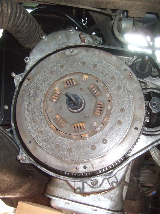

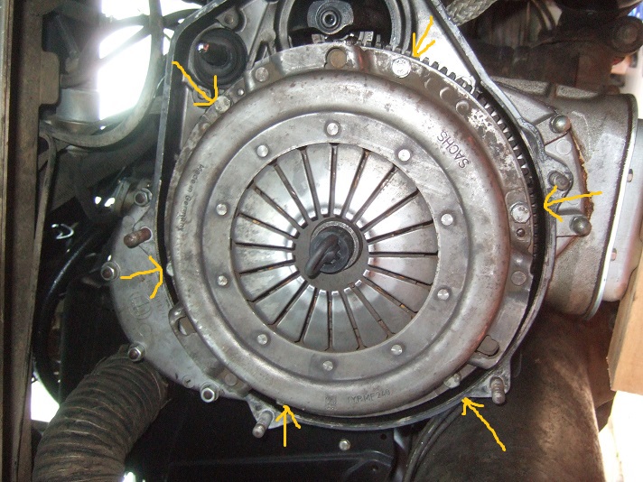

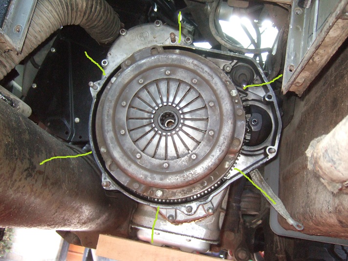

20  - Now the pressure clutch unit is visible. These 6 bolts (size 17) need to be undone

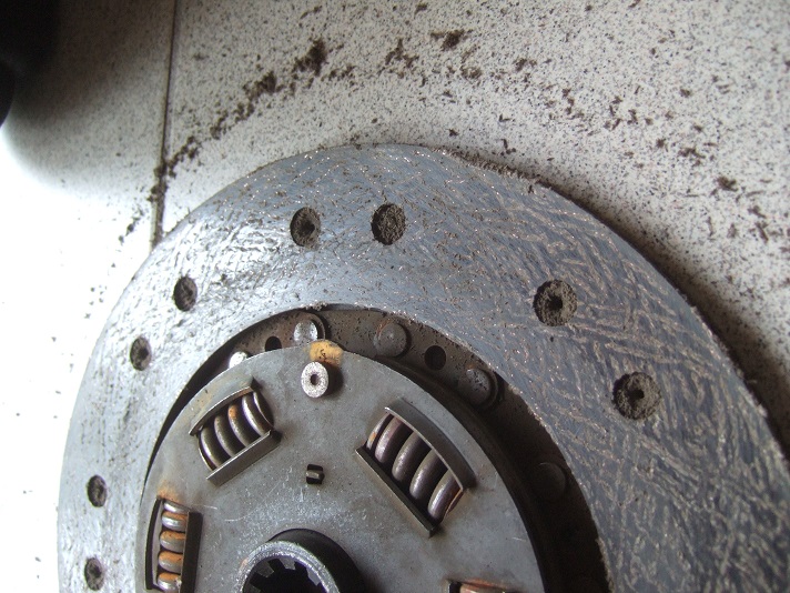

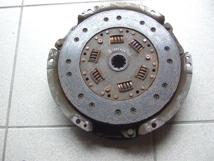

Luckily ? my clutch-plate was stuck to the pressure-plate, so I could remove the whole unit instead of working under the truck.<br />IF the clutch-plate IS STUCK TO THE FLYWHEEL then use a piece of wood and hammer on its side to loosen it. MAKE SURE you have 1 or 2 bolts still threaded in to prevent it falling on the ground OR on your face...
21-a IF the clutch-plate is stuck on the pressure-plate remove the unit, place it on its side and use a piece of wood against the sleeved tube and bang it loose... After sanding the clutch-plate a little, it clearly shows the 'rope-threads' that had swollen and stuck on the plate. The tiny white spots are steel wire threaded amongst it all in the plate

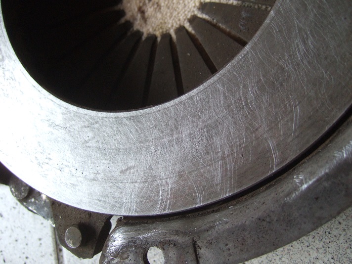

22 - Without going into too much detail (huh ?), I just sanded all the exposed surfaces with 80 sand-paper. (Flywheel, pressure-plate and both sides of the clutch-plate) It seems that the 'rope' in the clutch-plate swelled from the moisture and got it stuck to the pressure-plate. The picture shows the sanded area from the pressure-plate. It looks the same as the flywheel. Sanded the clutch-plate slightly also, the remove any 'swollen' rope on the clutch-plate.

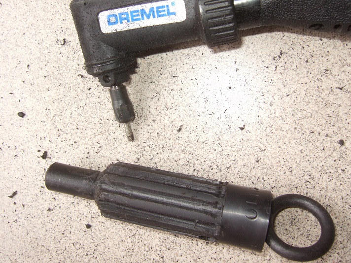

23 - The clutch-alignment-tool did not fit and had to remove excess material to make it fit, next time I'll buy from SAV
24 - Put the alignment-tool in the clutch-plate-sleeve and insert both in the flywheel
