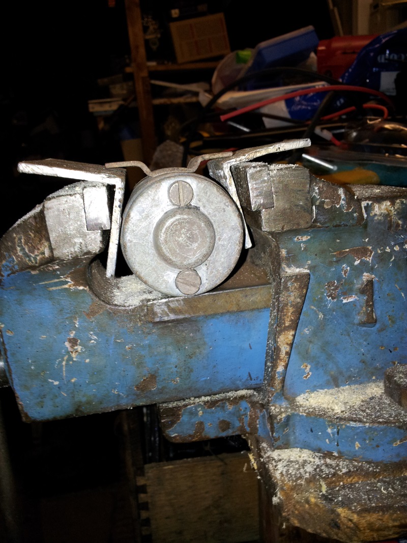

4: Undo the two flat blade screws on the bottom of the solenoid and take the cover off.
bottom of solenoid with metal cover.jpg (274.91 KiB) Viewed 12755 times

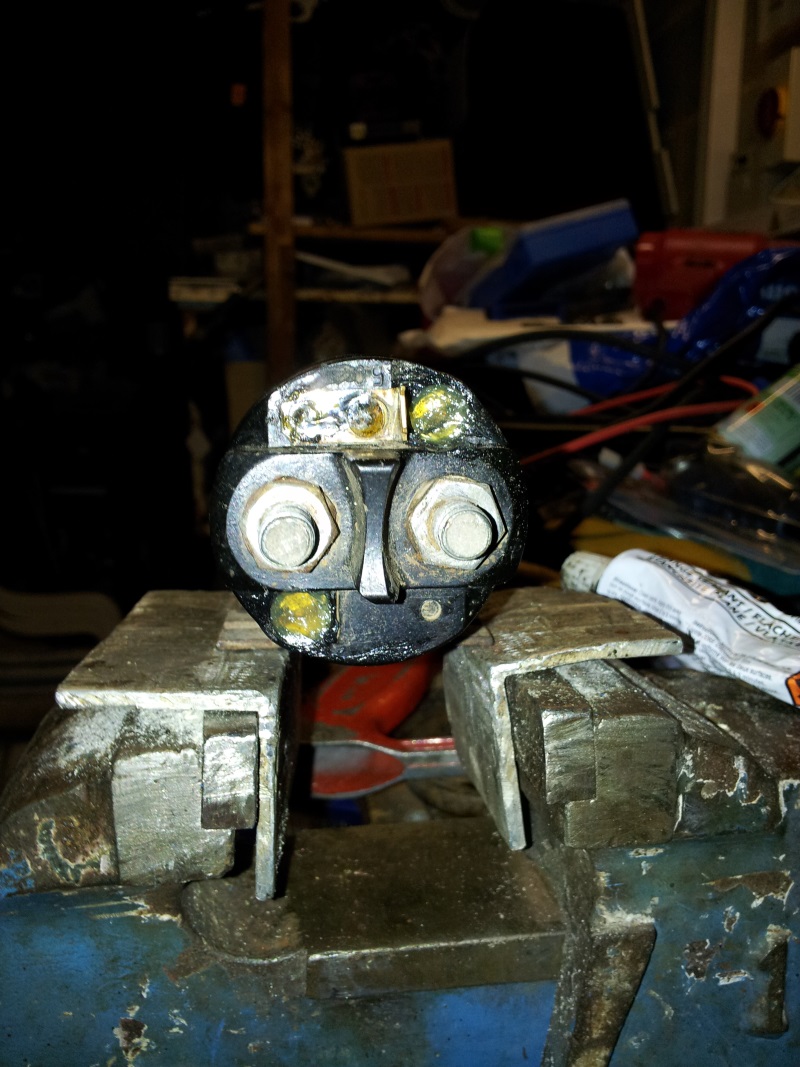

5: Undo the two flat blade screws on the top cover - you do not need to take the two locking nuts of the cable posts.
top of solenoid showing screws and wire to de-solder.jpg (138.54 KiB) Viewed 12755 times

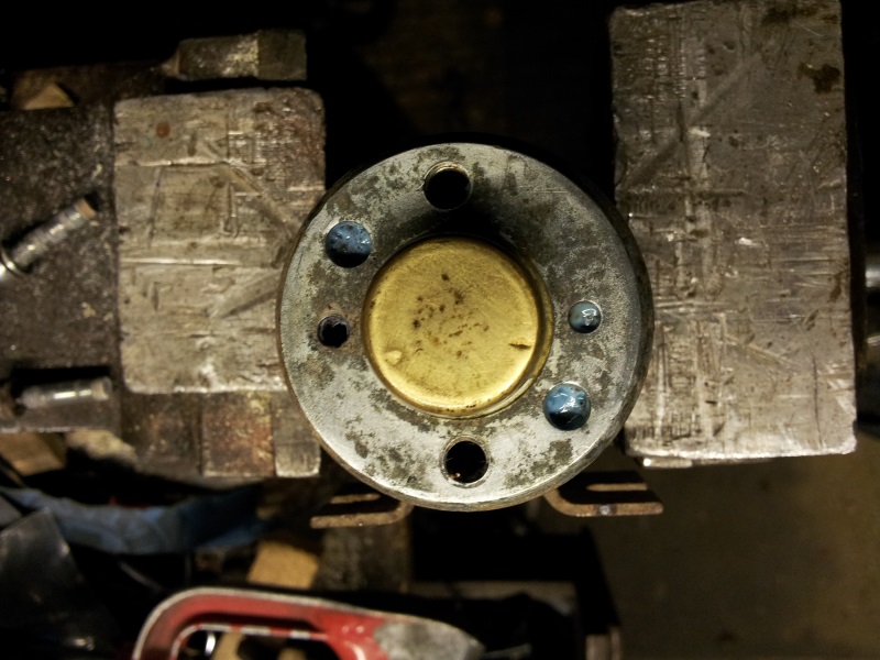

10: Now look at the top of the solenoid itself. The copper bar will also be black and pitted. Use a fine file to clean the two faces up, make them shiny as well.
11. Use some oil, spray grease, PlusGas, WD40 etc, to put down the centre hole of the solenoid.Leave it for a few minutes to work its way down the shaft.
12: Turn the solenoid upside down, Clean up the brass centre post and again lubricate it.

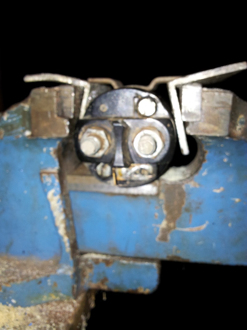

top of solenoid showing screws covered with grease and wire soldered.jpg (231.44 KiB) Viewed 12755 times
17: Put the Bakerlite top back on make sure the wire from the coil goes up through the hole to the spade connector.
18: Put the two screws in and do them up.
19: Use the soldering iron again with new solder to solder the wire from the coil back on to the spade connector tag.
