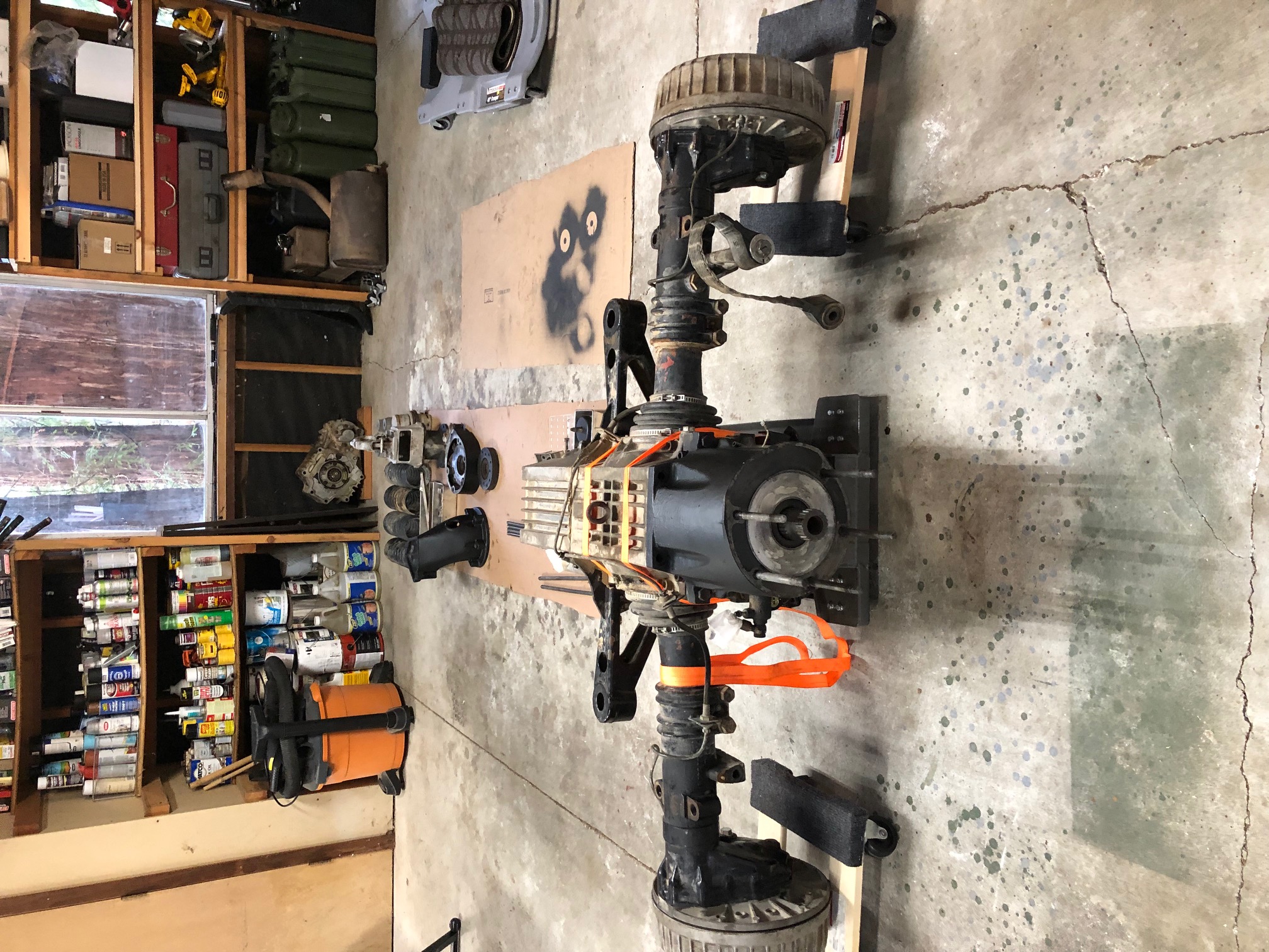

made was that the TD tranie in a 710 is bad trade off for off-roading and
certainly terrible if your running the lower power (Torque) unmodified engine.
I stand by that position.
This past spring I decided to fix this problem with what I believe to be the best of
all compromises -- a 712 transfer case mated to this TD tranie. I managed to source
a 712 X-case and just completed this surgery.
On the HWY, the TD's 5'th gear is over-drive, RPM was 3150 @ 60MPH on 265/75 tires.
A stock Pinz is approximately 3600 RPM @ 60MPH. This seems like a decent trade-off
to me. I was also able to stay in 5'th longer than before even with grade.
On the trail, my only test is a old logging road on my property, not that severe or long
enough to render a full impression, but I can tell that there is a huge difference in
crawling performance and Power. Can't wait for spring to hit the trails.
PIX of disassembled drive-line ready for re-assembly attached.
As a passing comment, this was a fairly big project and is definitely a 2 man job.
There are several techniques and procedures you have to know to attempt this, but it's
a doable project. Proper jacks/lifts and a good life insurance policy is recommended :wink:
