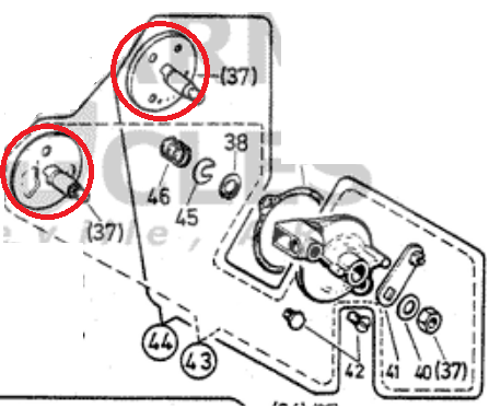

Please can some one tell me where to get specs on the sizes of different jets for high altitude? I am at 1500m but do intend traveling at the coast now and then, probably a 50/50 scenario. Southern Africa is my playground :lol:

I have also noticed the following concerning my two carbs;
Are both carbs supposed to have the same jets? Because one has Idle Jet 55 and the other Idle Jet 60 , Main Jet 135 the other Main Jet 140 and the choke disks are also different, one is a No.2 and the other a No.6 i.e. one has small holes and the other bog holes (one of each circled in red).
Thanks in advance

Main Jets 135 for 800-1500meters, 130diameter 1500 to 2000meters and 125 diameter 2500 to 4000meters
mount at your´s with slow running jet 55
and 130 slow running air jets
( 140 Main jets only with 60 slow running jets and 110 slow running air jets up to 1200meters)
The starter air disc no 2 has the big hole and is corsale to regulate( short way). Mount no 5 or no 6
There are different kinds of throttle cambers too, different drill holes, throttle flaps and side sealings, also different throttle lever- high and low :wink:

Definitely I would expect both carbs to run the same set of jets...
