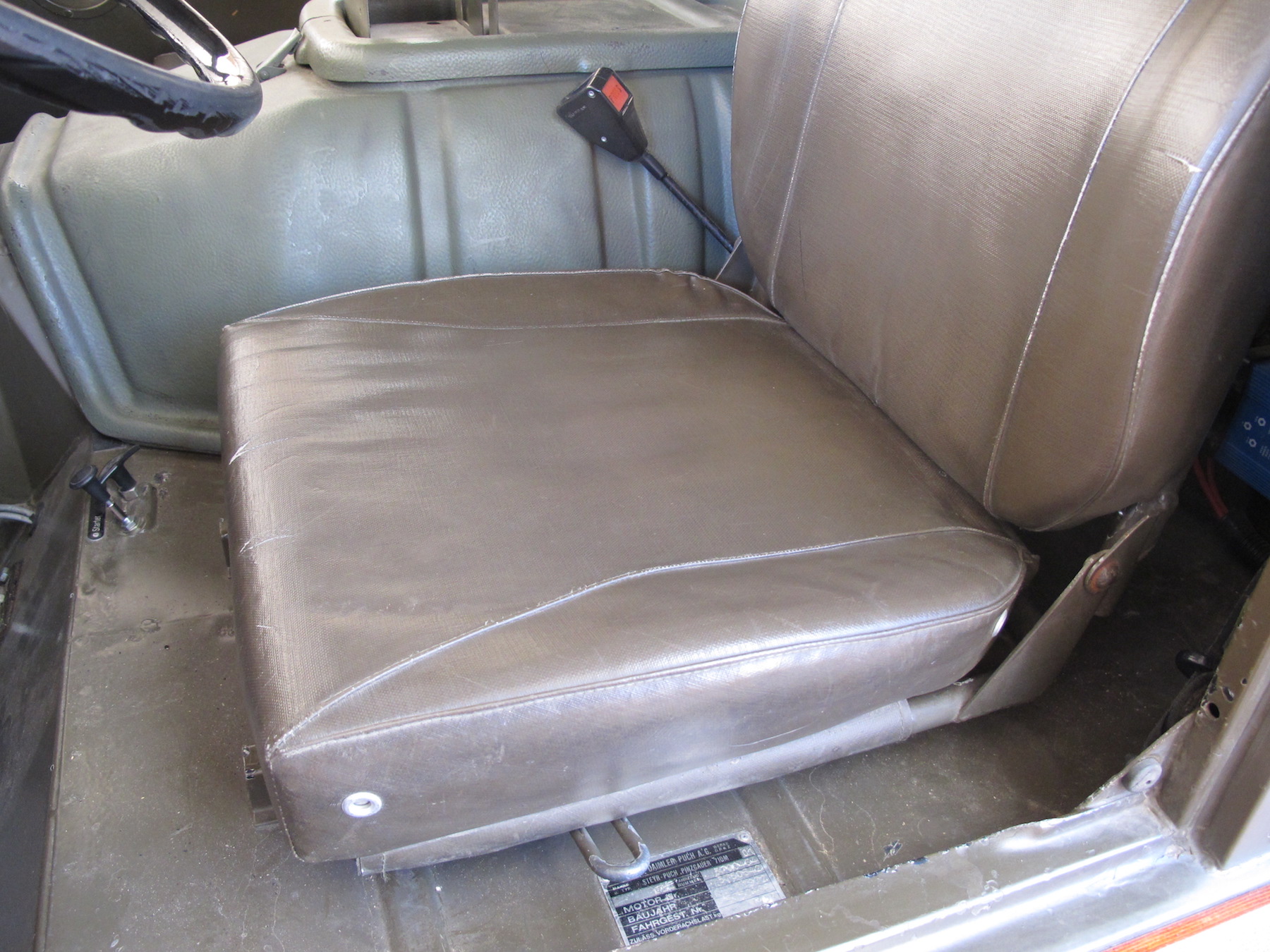

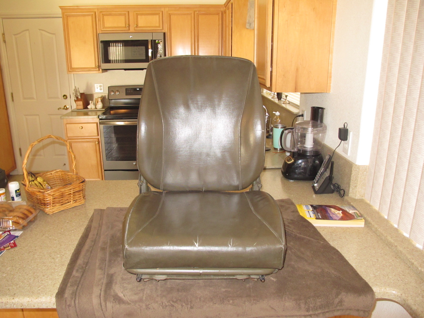

Thanks to pcolette for the better OEM drivers seat cushion. Got it installed today. Getting the flaps off of the frame prongs was easy with tugs on the flap with linesman's pliers. I had to bend the prongs up to get the replacement seat on though. Fortunately only one of them broke off.
The old seat seams were torn, fabric torn.

The replacement OEM seat is much better.
