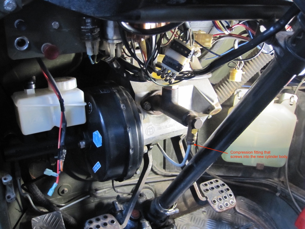

I had to do this 2-3 years ago. It looked like a potential headache at first but was actually fairly easy. The compression fitting on the line that connects to the banjo fitting screws directly into the new cylinder body with no problem. The hydraulic line needs just a small amount of bending by hand to line it up properly.

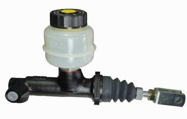

Just for reference here's a PIX of the new Master showing the exit on the side
clocked to the 3PM position.

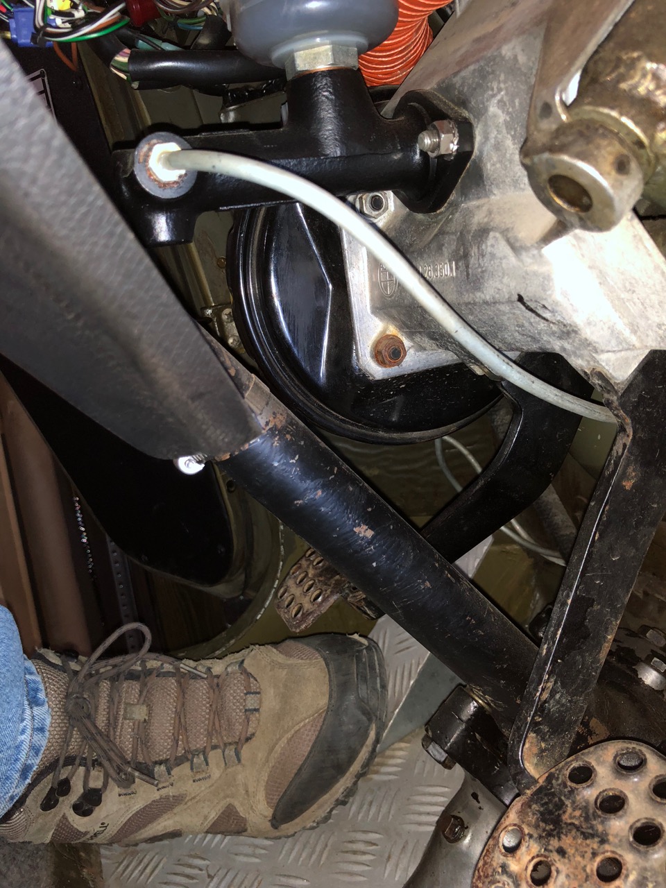

Re: Clutch Master Cylinder
Hi Ron, I just did mine earlier this summer and ran into the same issue. Yes, I was able to pull another inch or two from the line and I put about a 1 to 1-1/2" radius in the line just before the fitting and get it into the master port. Not really much to it (but I was likewise bummed that I had to make the modification), but it will be this weekend before I can get you a photo if Paul doesn't beat me to it.

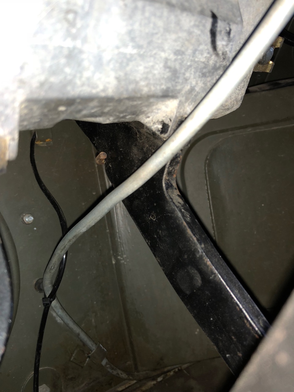

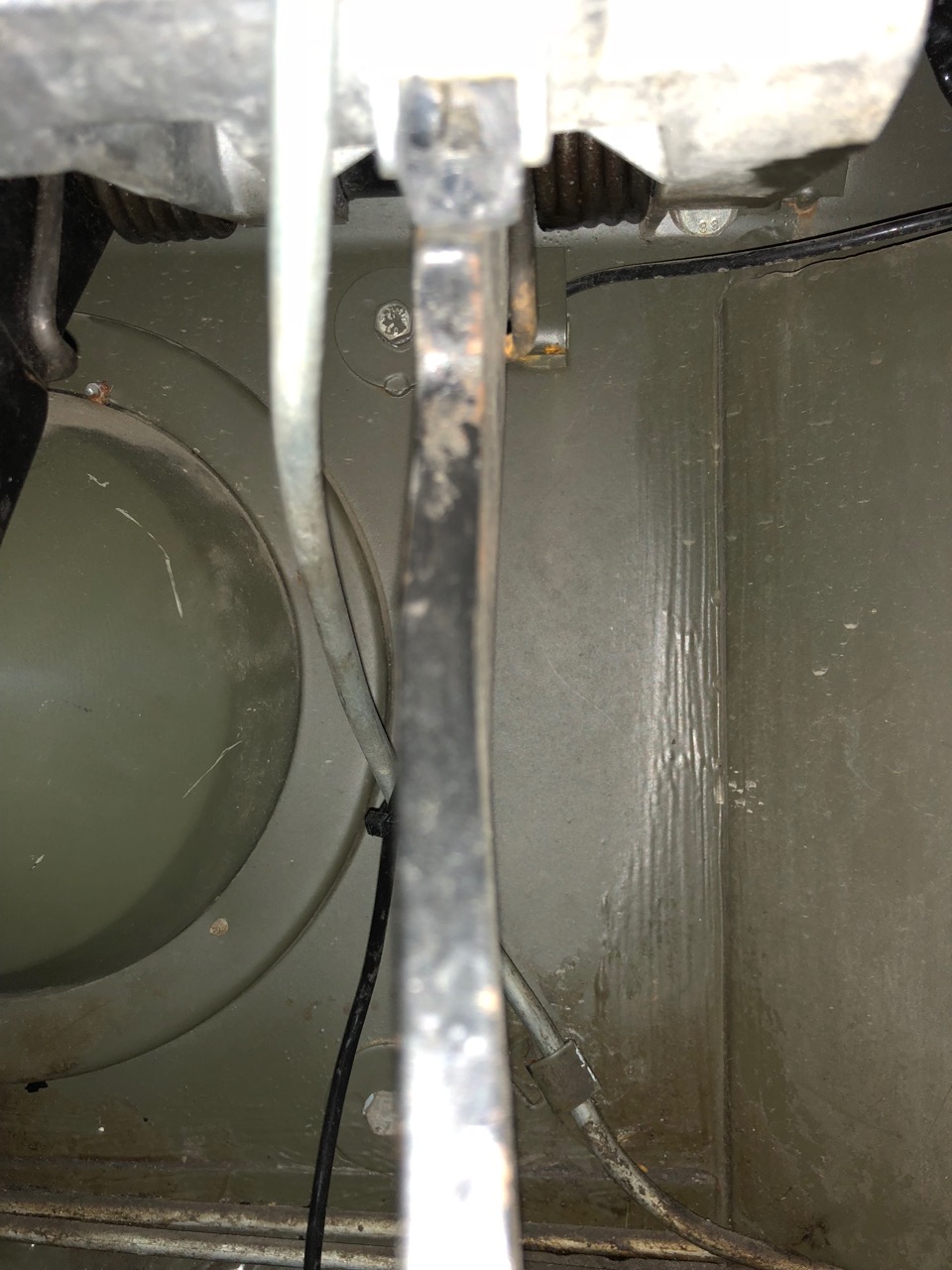

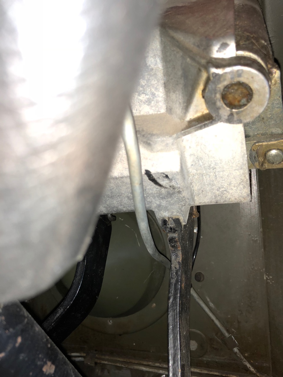

Here's a few photos which hopefully will help.
Posts: 1550
Yes! Very helpful!
Thanks.
Ron
While the bend does move the clutch line closer to being over top of the brake pedal, remember that the pedal moves DOWN, away from the clutch master. And my foot is securely on the pedal, below the bend, and moves away from the clutch line as I press the brake. In other words I don't feel that the modification has any effect on the fit of feet on the pedals; it is just a non-issue.
Paul's photos (yup, he beat me to it) generally reflect my truck as well. I think my 90 degree bend was a smidge tighter.
