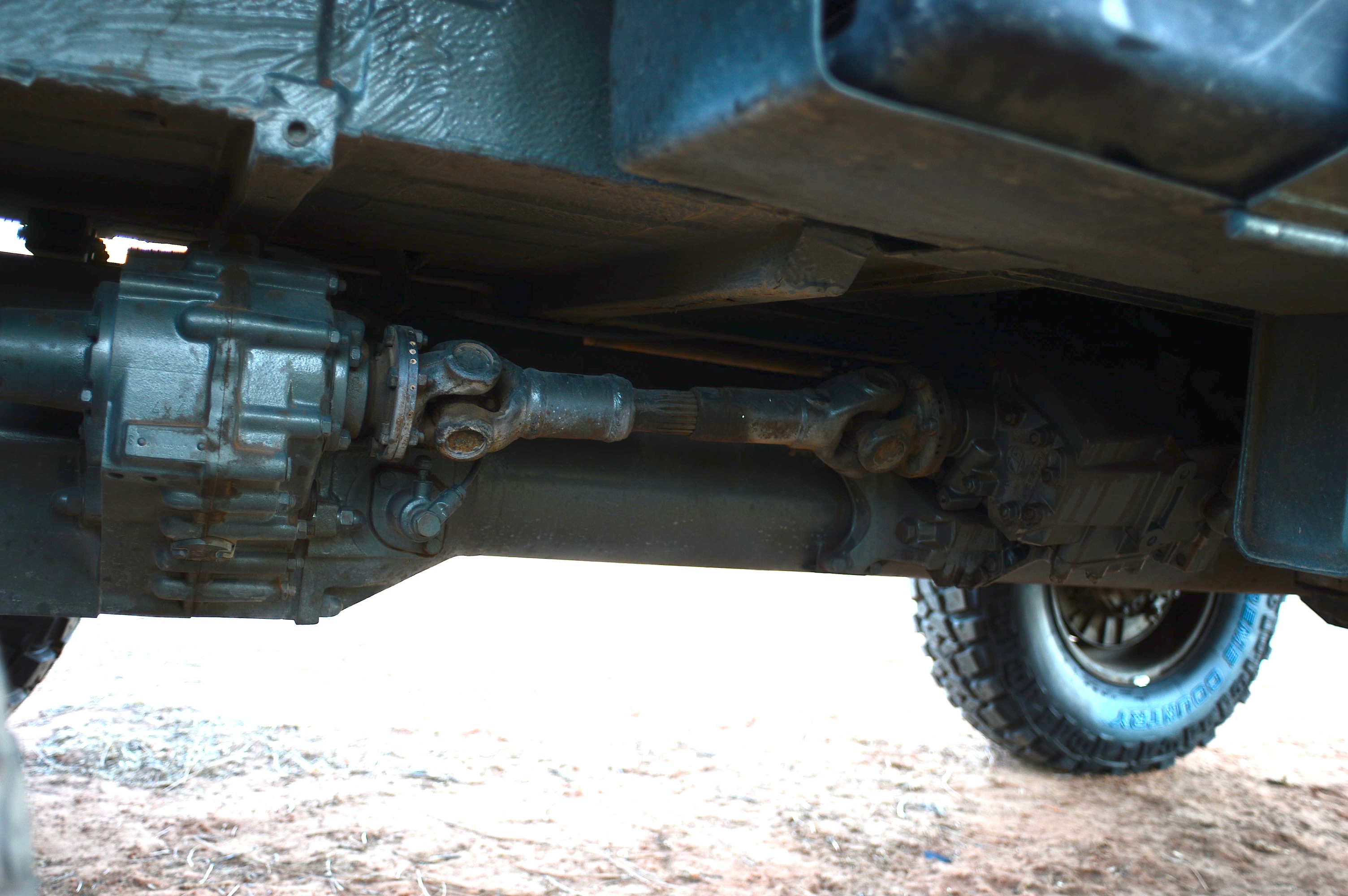

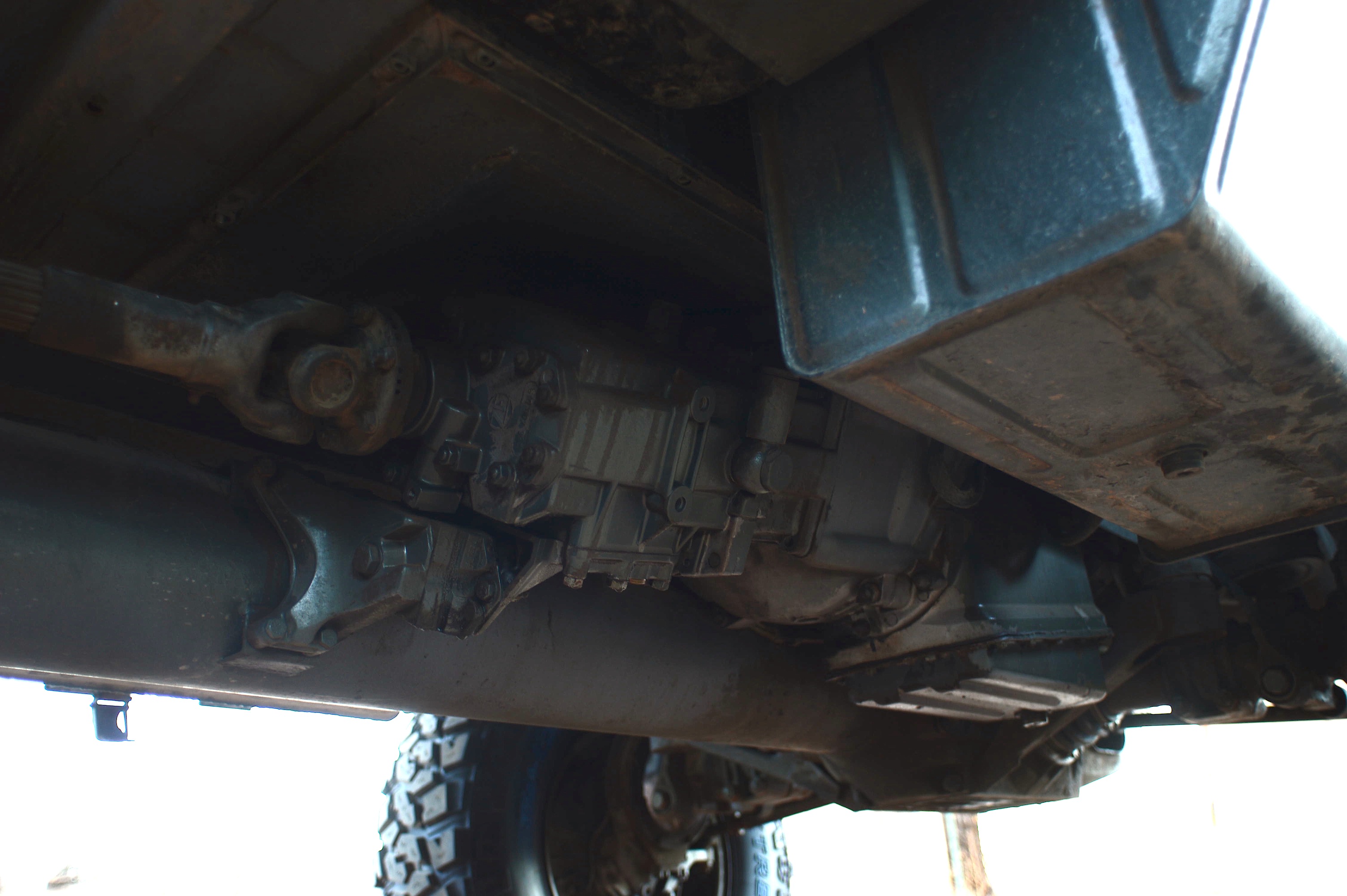

Here are a couple pics (looks stock to my untrained eye).

(the t-case reads "4x4" above the number tag, you can just barely see it in the photo)

The Volvo and Iveco transmissions have exactly the same high gear (5th) ratio of 1.00:1 (input shaft directly connected to output shaft) so they won't get you going any faster than the stock transmission (and it looks like that's what you have from the photos). Ron's test will check the transfer case, diffs and hubs for their expected ratio, but the drive shaft will only need to be rotated 2-7/8 rotations since the differential action will double the raised tire rotation speed since the opposite tire is still on the ground.

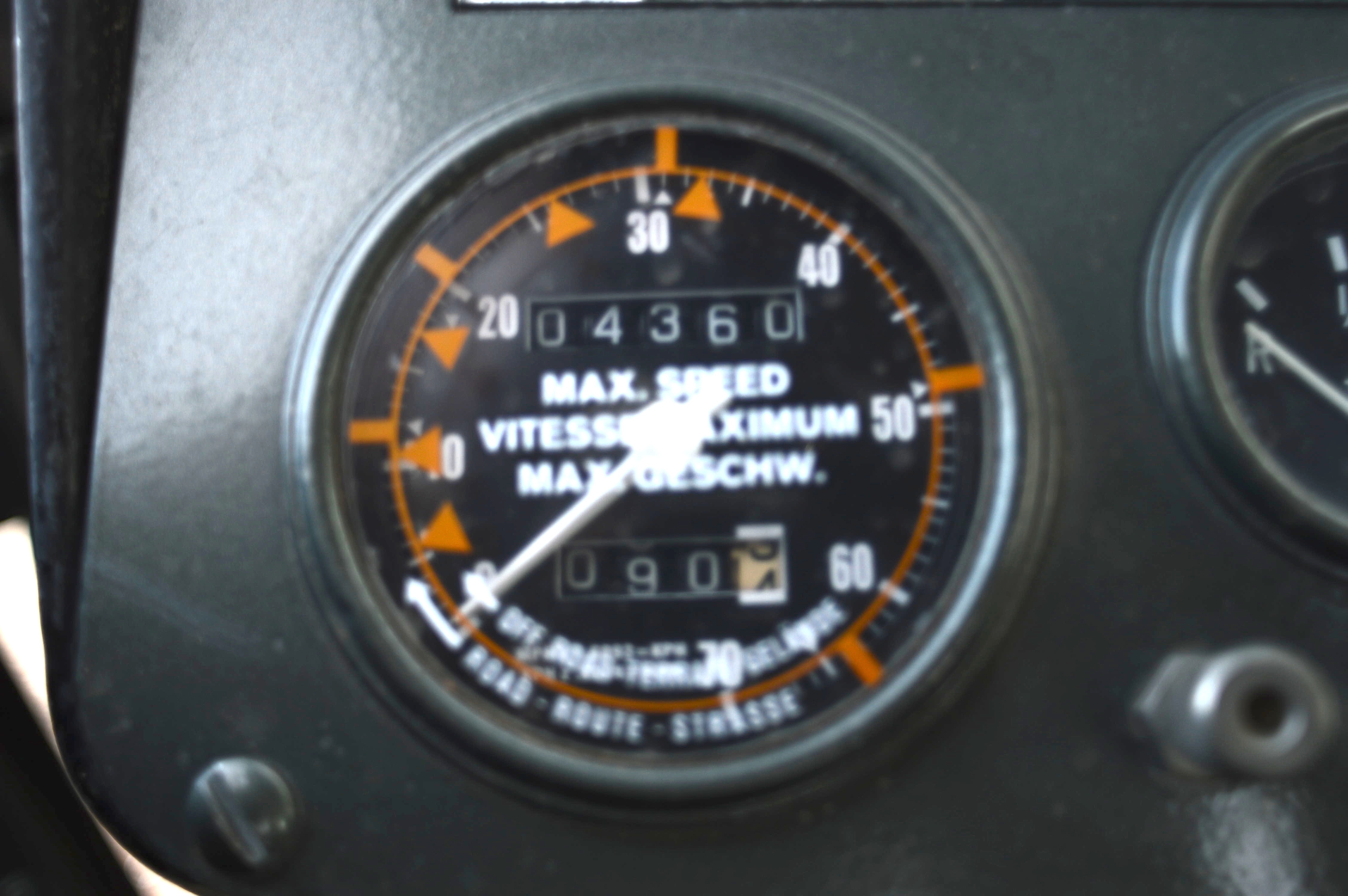

Also, the speedo only reads up to 70 km/h.
70 km/h speedo? Most I've seen indicated (were marked for) up to 100 or 120 km/h, any chance your speedo face has been changed out for a mpg face? Have you verified the speeds you are indicating with a gps?
Also hard to tell in the photos however I don't see any evidence of recent grease in the drive shaft and u-joints.
Re: Converting Low Speed Transmission To Taller Gearing?
Good catch on the speedo!
dieseltoy - Post a picture of it please

Here is a pic of the speedo
That has to be a mph speedo no?
The orange speed pointers almost match up (within a few mph compared to kph)

The speedo's on these trucks often are in need of refurbishment and/or are out of calibration. Many owners convert to electronic speedos or just use a GPS. Many of the Garmin units (not all) are 24v friendly.

It says kp/h, but it has the 90* cable adapter on the back so it's probably not accurate
Probably going to go GPS as Ed suggested.
