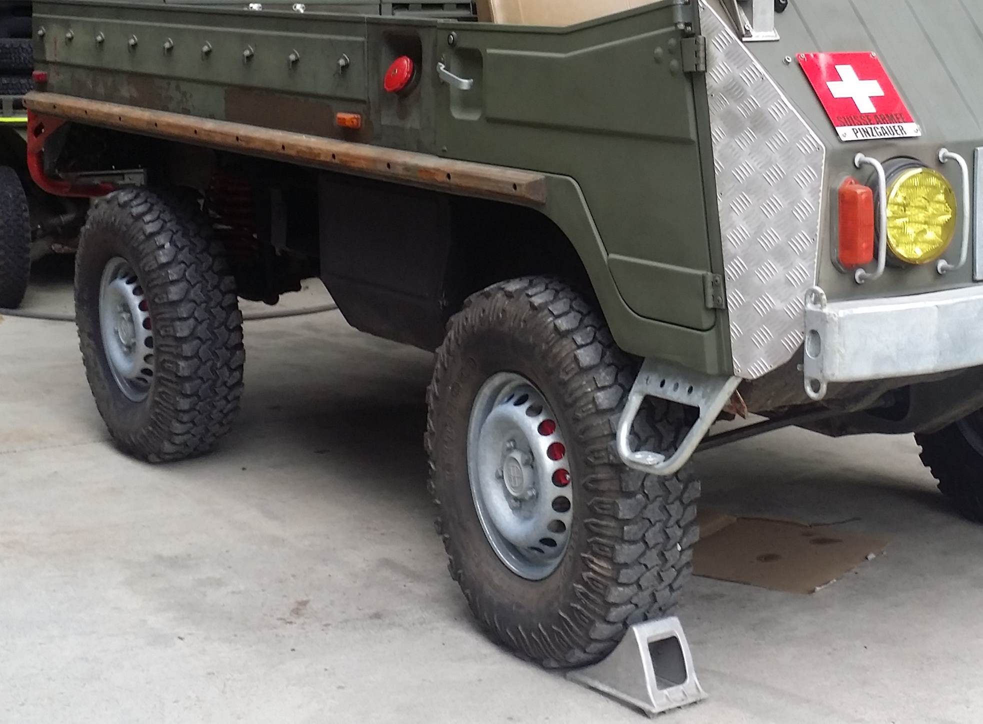

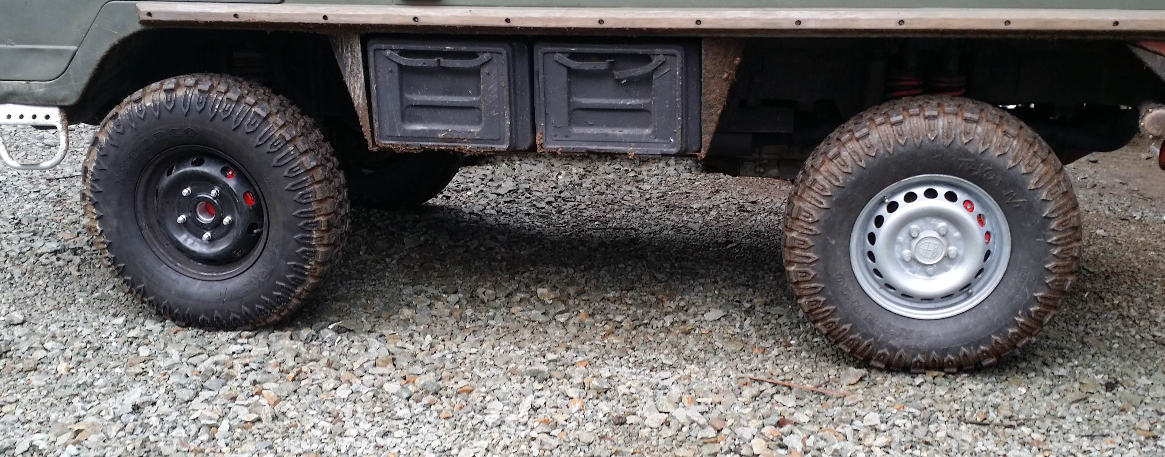

Re: KLUGEWERKS Disc Brake Conversion Kit Updates
Yes - the look of the Transit wheels has grown on me - especially when they are painted green to match the truck. Here is a picture of one like that:
Yes - the manual proportioning valve does require adjustment when loads vary - its not a perfect solution but it does allow dialing in the amount for different vehicles - for my Pinz which has been mostly lightly loaded I've kept it on the minimum value and the rear end barely locks up on gravel - and only when the front wheels are also locked up. Before I installed the proportioning valve there was way to much rear braking going on... of course when 4WD is engaged then the rear and front axles all rotate together so it's not as much of an issue off-road.
Since the front brakes have dual calipers - and the rear have single calipers (all the same piston size) - the braking is biased towards the front axle by a 2:1 ratio inherently - this is the same approach Steyr-Puch used on the 716 and 718 Pinzgauers.
I did consider the automatic "inertial" proportioning valve used on the late 70s VW bus and Vanagon - it uses a steel ball which rolls up an inclined barrel - so it responds to the vehicle's position (going up hill / going downhill / braking hard front end dive) but they are hard to find quality reproductions (at least that is what I hear from VW guys) and they are much more expensive than the manual valve - about $300 or so... It's almost is a type of rudimentary anti-lock braking system for the rear axle. The british Mini's and Moke's had a similar system but it cut out all braking of the rear axle when the nose dives down - the VW one simple goes from full braking to partial braking of the rear axle.
My Sprinter has the same load / nose dive sensing valve connected to the rear axle - that same system was also added to the 710 Pinzgauers that were rebuilt and upgraded by the Austrian military - they did not add them to the 712 Pinzgauers... I would still recommend a manual proportioning valve as a minimum though on a 712.
In many ways - the same issue exists for the drum brakes - the front / rear braking bias is fixed at a compromise level which is appropriate only for some operating condition - probably with the vehicle lightly loaded... with the manual adjustment you at least can increase the rear braking effect for times when you are heavily loaded and need all the extra braking ability possible.
Here is a picture of the Sprinter wheels from an angle - they look better that way then when viewed straight on IMHO.VinceAtReal4x4s wrote: I like the front <Transit> wheels more in the pic. The rears <Sprinter> almost look fragile with the amount of holes it has. I know they aren't but it just feels that way at a glance.
The gross rear axle weight (GAWR) rating on the Sprinter with these single wheels is over 4000 lbs - so they should handle the weight of a 710 or 712 without issue. The Transit wheels are heavier - 32 lbs - vs 30 lbs for the Sprinter wheels.
I don't know... the transit in alloy powder-coat might beat them out, for me.

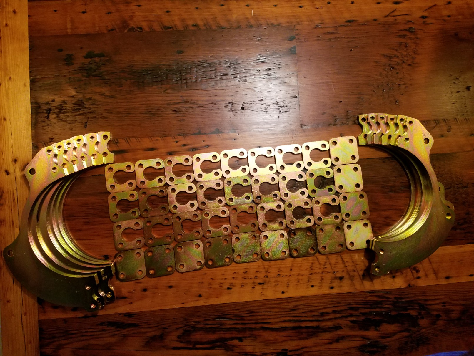

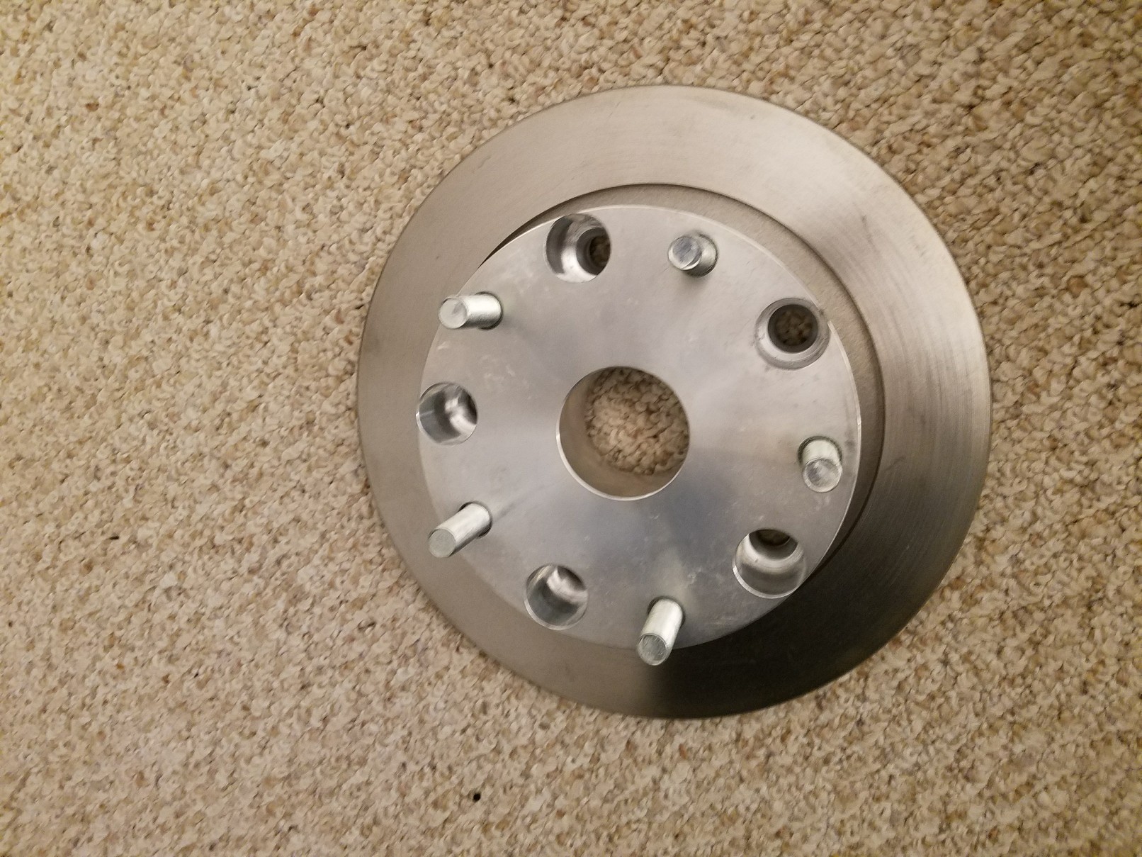

Here are my disc brake brackets after I had them yellow zinc coated and a shot of the disc and spacer with studs!
Can't wait to get started on the install!!!!

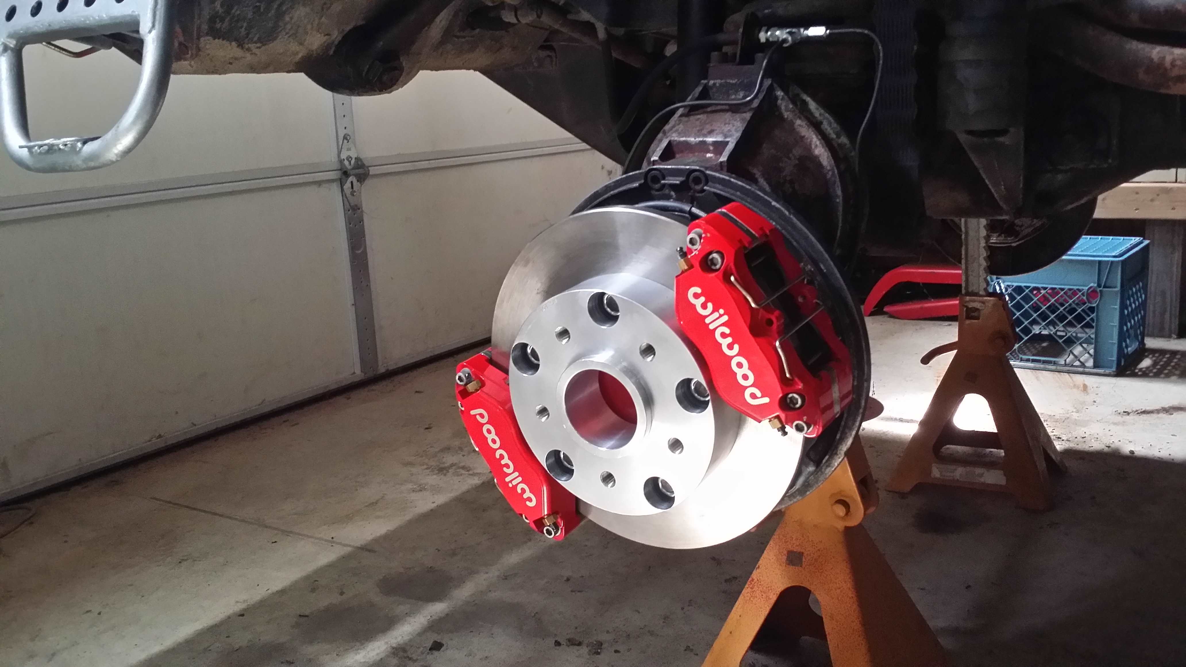

Got the first production batch of vented rotors for the disc brake conversion kits
The thickness increases to 0.640" / 16.2 mm which is 25% thicker - but the weight of the vented disc decreases by about 15%. Original solid discs are 0.510 / 13mm thick.
The existing calipers and brackets work with either by removing the 0.125" thick pad spacer which is used only with the solid discs.
I am offering to exchange the front axle solid discs for the vented ones to all of the kit purchasers at no cost.
Any thoughts/preferences on vented versus solid rotors? I would like to not have to have to stock two different discs going forward...
The TD Pinzgauers used solid discs through their entire production - and the TDs are heavier & faster. Nearly all cars and trucks now use vented discs now though.
I look forward to these updates as it’s very exciting news each time!
You know my thoughts on the solid vs vented
Vented fronts on my TD G and the only negatives I have ever seen are people saying the vents could clog up with mud but I don’t see that being a real issue.
The offer to exchange rotors for all existing kits out there is simply OUTSTANDING!
I suppose the vents could get plugged - but I don't think its very likely. Also - these are the straight type vents (as opposed to the curved versions) which would make cleaning them out easier I would think.
The same disc is used on all wheel positions BTW.
