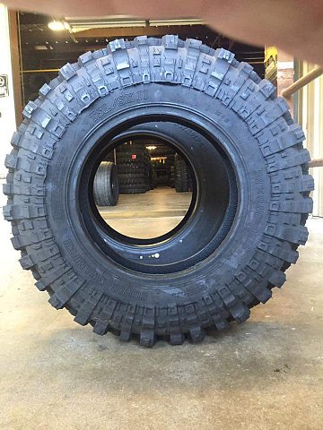

Im buildinsg up a trail specific 710M. I mounted a set of 34x9/16 narrow tsl ss super swampers on the stock wheels with out tubes. How do i find out how low I can deflate for the trail w out finding out the hard way? Anyone have experience with this tire offroad?

Pros on the tires: great traction offroad, very impressed.
Cons: super sketchy on road. Loud. Took 8 mph off top speed up my short mtn rd (32mph in 4th versus 40mph with smaller tires when i purchased). Probably the most out of round tire ive seen, tons of weight to get it even close.

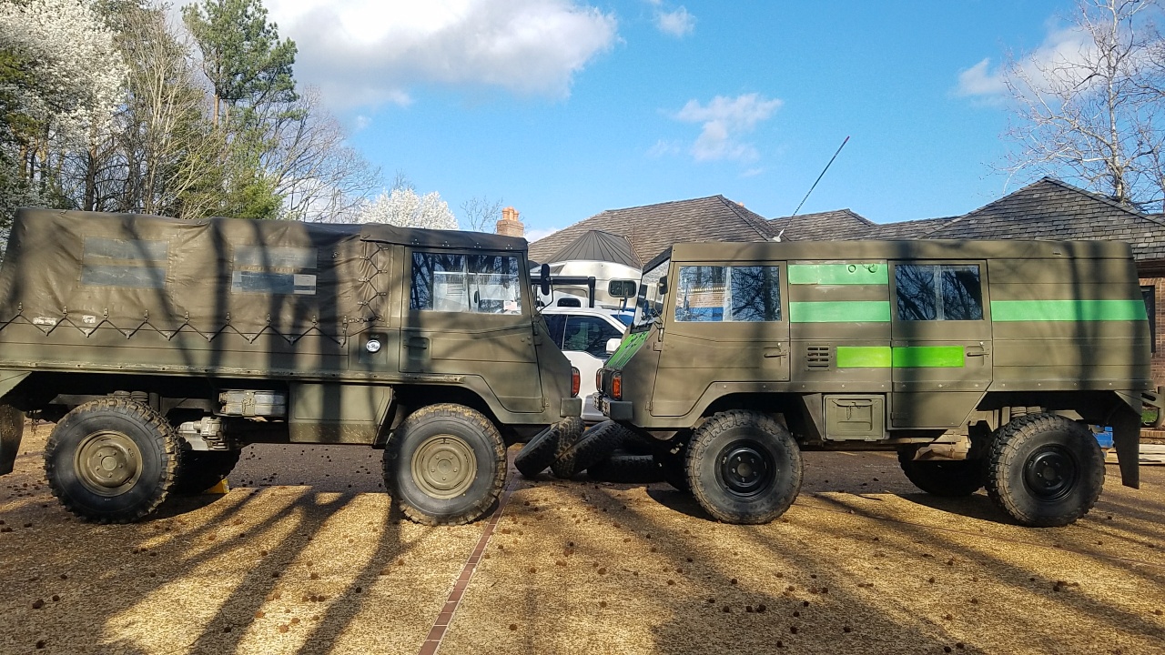

Here they are next to some toyo open country mt's 255/85r16's on 710k. Toyos feel like high performance summer tires compared to the intercos but no comparison on the trail.

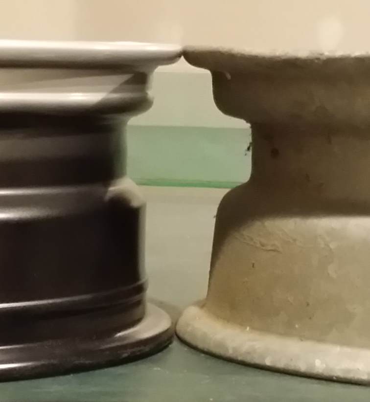

No experience with those tires but your rule of thumb will likely not work as the stock Pinz rims have no inner safety bead like most other rims.
The tire can lose its bead (to the inside) pretty easily if you go too low psi.

I agree - it would be best to swap out the original wheels with a pair of Ford Transit wheels as they not only have the bead retention "humps" but they also will add about 3/4" of width on each side to enhance stability.

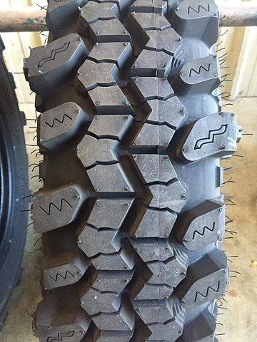

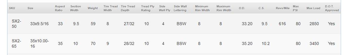

Interco does have a newer version of that tire - but it is slightly wider at 9.5" versus 9" - and it is spec'd as requiring a 8 inch wheel versus 7 inch for the older one. The new one is called the SX2-50 and is slightly shorter - 33.2" in height and listed as 33x9.5/16
https://www.intercotire.com/tire/148

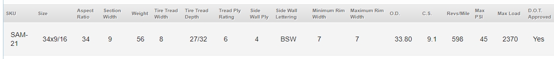

Here are the specs on two of the SX2 tires
And here is the specs on the 34x9/16

I have only had them out twice and nothing extreme enough to experience rub if its going to happen. I was concerned after mounting....it will be close for sure.
I might as well get the transit wheels....im going to end up with the disc conversion anyway im sure
Your comments on contact patch are spot on...i can see it on the truck.
I thought about the 9.5's but went this way. Probably try them out next time.
Pics next to the courser tires 255's thst were on it
Sent from my SM-G935V using Tapatalk
Your comments on contact patch are spot on...i can see it on the truck. I thought about the 9.5's but went this way. Probably try them out next time.

I think for the stock and Transit wheels (both are 6.5" wide) the narrow TSL 34x9/16 is a good choice since it is spec'd for a 7" wide wheel.
The new SX2-50 is spec'd for an 8" wheel and I wonder if the tread would end up being too rounded when mounted on a 6.5" wide wheel. The SX2 is being made using a much more advanced molding process which hopefully will result in it being less out of balance and more true in shape than the traditional swamper tires.
There will be a Pinz 710M running with set of the SX2-50 tires very soon on some new 8 inch wide steel wheels specifically made to work with the disc brake conversion - we'll post the pictures as soon as they are mounted up.
