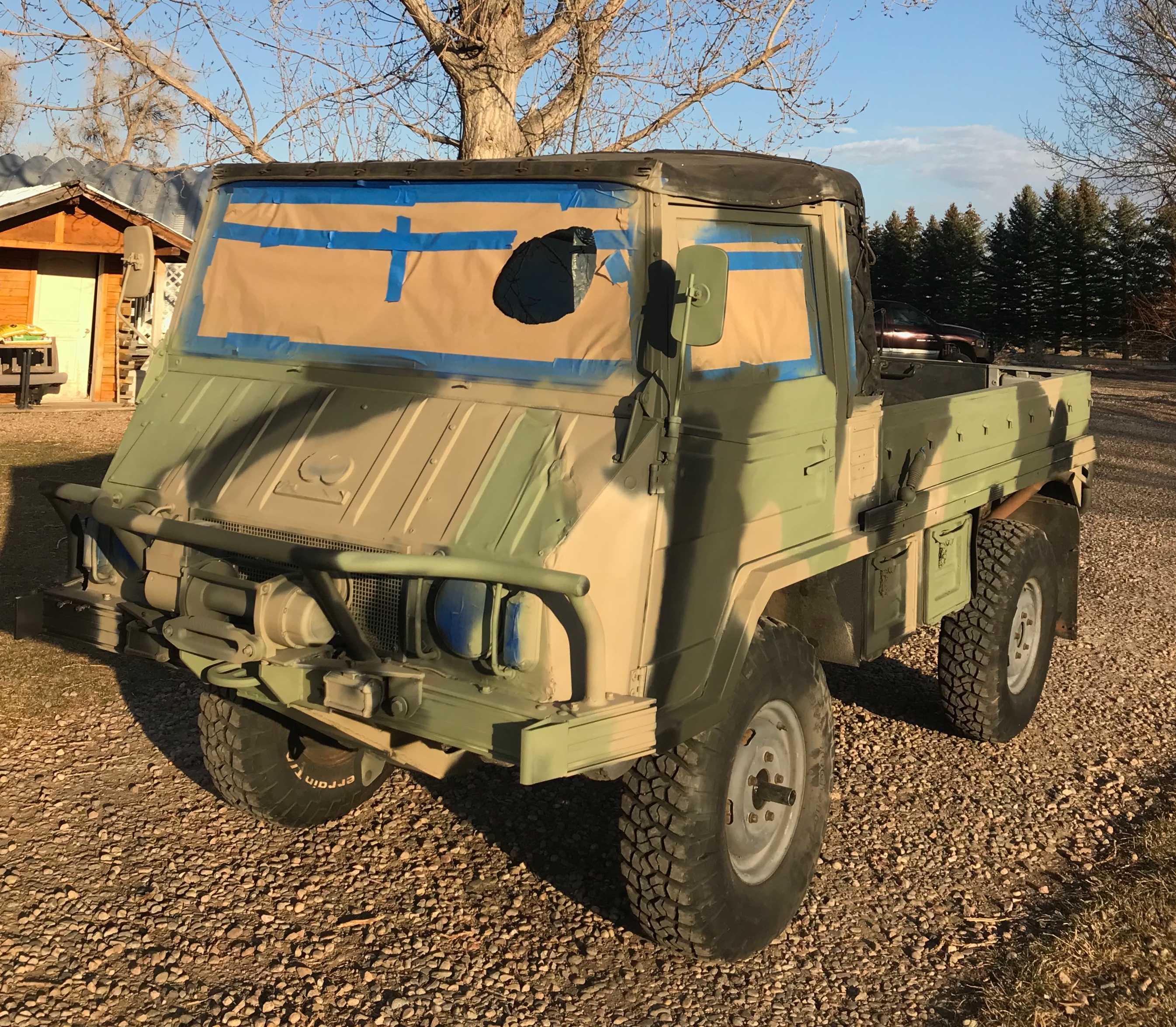

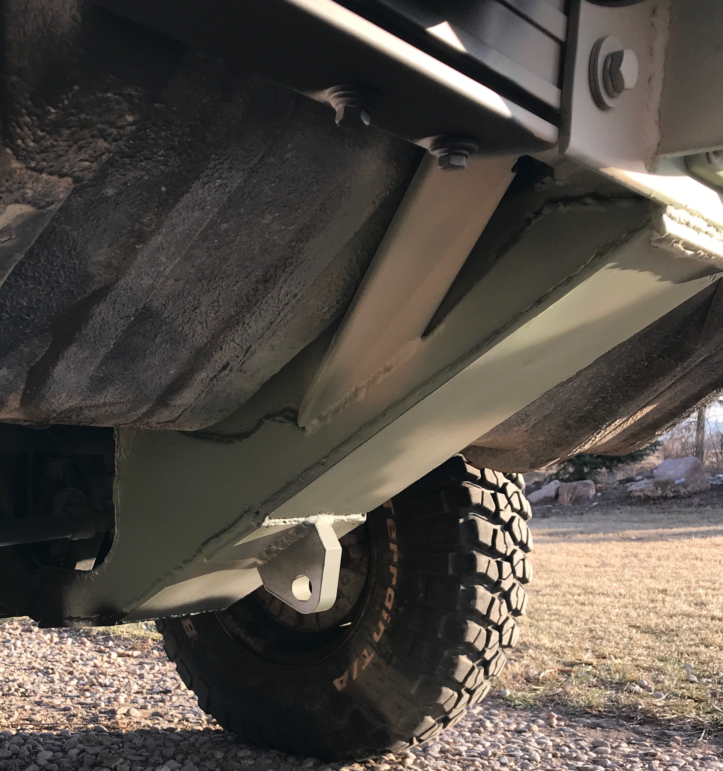

And away we go. My new ‘73 710. Slapped on an aluminum bumper recycled from an old ladder rack off my dodge. Brush guard is 1 3/4’ aluminum tube from an old raft frame. Put together a winch Mount since I travel solo a lot. The fender flares are 2” steel tube which should provide cover for the extended wheel width of the Klugwerks Disc Brake Conversion kit being shipped. The rear bed protector (replaces the wood rails) came off my dodge too, were bed rails for a tonneau cover. I’ve got 4 Super Swamper 33-12.5-16’s waiting for the new wheels custom made by Klugwerks for the disc conversion. I reinforced the center nose cone frame to prevent further deformation from winching. The 1/4” plate is welded on to the nose cone and goes completely around the steering linkage openings. (I’ve got bad cervical vertebrae & bad vision, hence shitty looking welds but I think they’ll hold). Yes I bought a Pinz that had been subject to a force great enough to pull the entire front cab down enough to misalign the windows in their frame. I didn’t realize it at purchase time, but learned after reading hours in this great forum. I got pics of all the fabrication I did if anyone is interested. And the camo job.....I guess not bad for first time, not 100% confident it’s permanent.
So happy to be a Pinz owner!

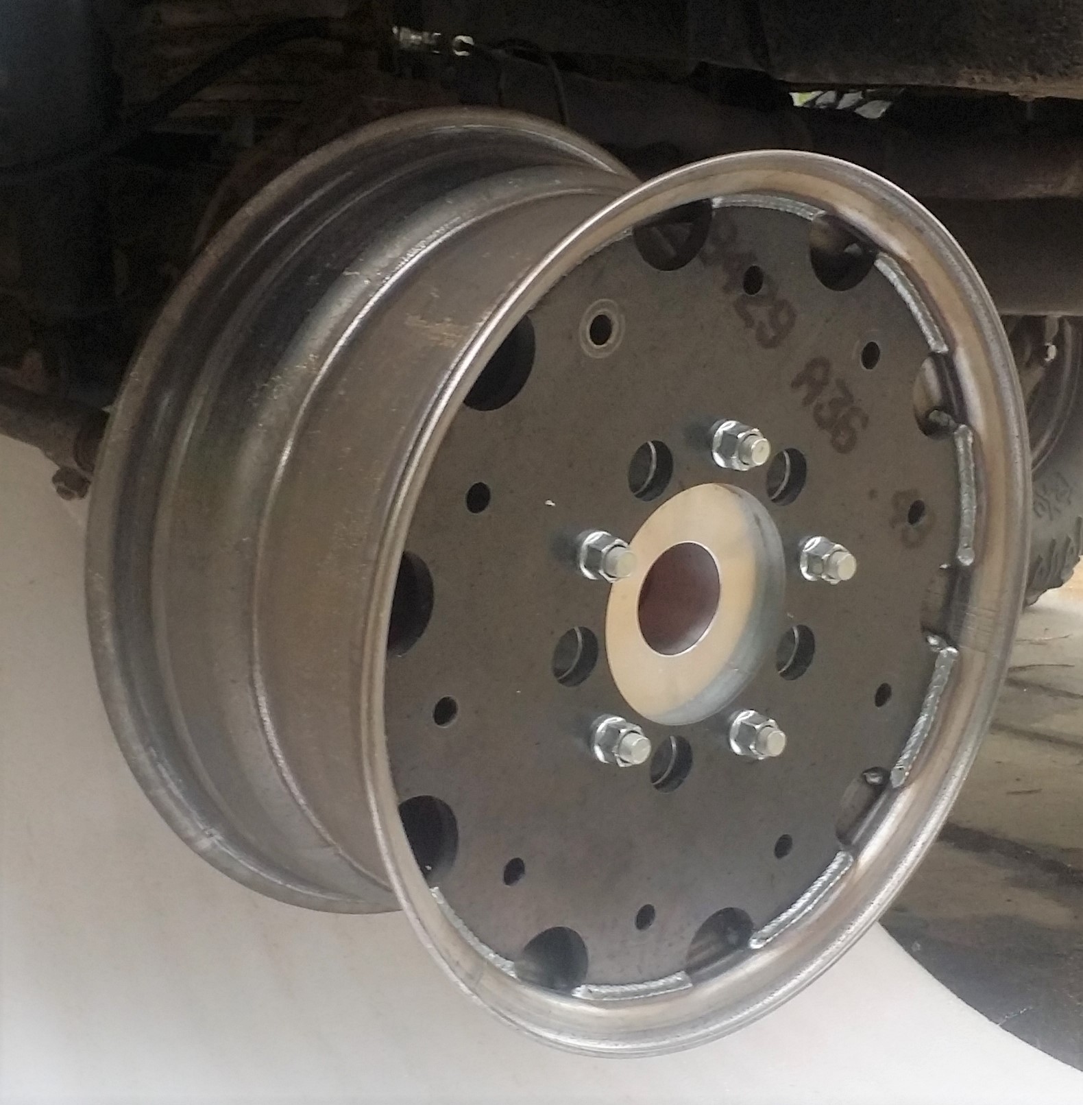

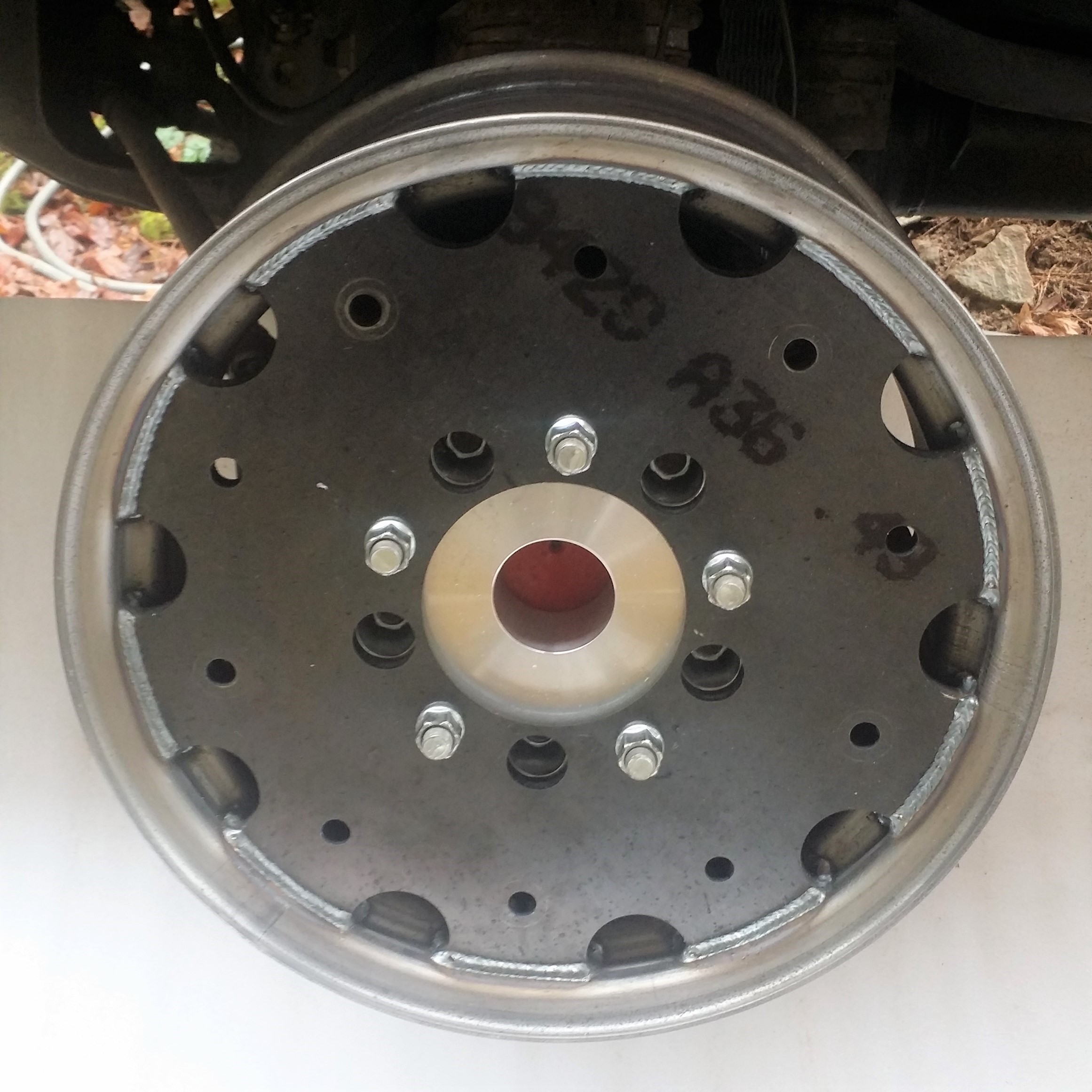

Here are two pictures of the 5x160 lug-centric version:
KW 5x160 straight 14MAR2018 .jpg (783.22 KiB) Viewed 7073 times
KW 5x160 angled 14MAR2018 .jpg (415.84 KiB) Viewed 7073 times

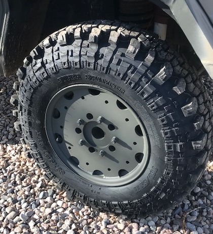

The five holes around the center allow re-torquing of the spacer's nuts with the wheel in place. The spacer is used with the disc brake conversion.
The ten holes around the perimeter are used to press in the center and to hold it true while it is being welded in a fixture. They also can be used to bolt on a sacrificial aluminum "rock ring" to reinforce and protect the wheel's outer edge.
These wheels extend outward the same amount as the Ford Transit wheels with the disc brake conversion - but are 1.5 inches wider. It might be possible to even make a 9 inch wide wheel the same way with 8.5 inches of backspacing - anyone building an iceland / arctic type truck?
Thoughts? Opinions? Too ugly?

Yeah hard to tell without it mounted up. They look really thick and heavy to me... like something Id make a winch plate out of. Why so much metal?
Re: Hyde Ho
These weigh 40 lbs per wheel - the transit wheel weighs 32 lbs but is 6.5 inches vs 8 inches.
The center plate is 22 lbs of steel. I made a set up in 3/8" steel for myself to test out also.
It would be possible to take a few lbs of steel out by adding more cutouts / holes in the plate as well. The current design is pretty minimal as far as cutouts go.

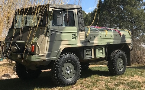

Here are a couple of updated photos of those wheels installed on a Pinz. Also I reweighed them on a better scale and they are 38 lbs vs 32 lbs for the Transit wheel. I don't have a original Pinz wheel on hand to reweigh as a comparison.
