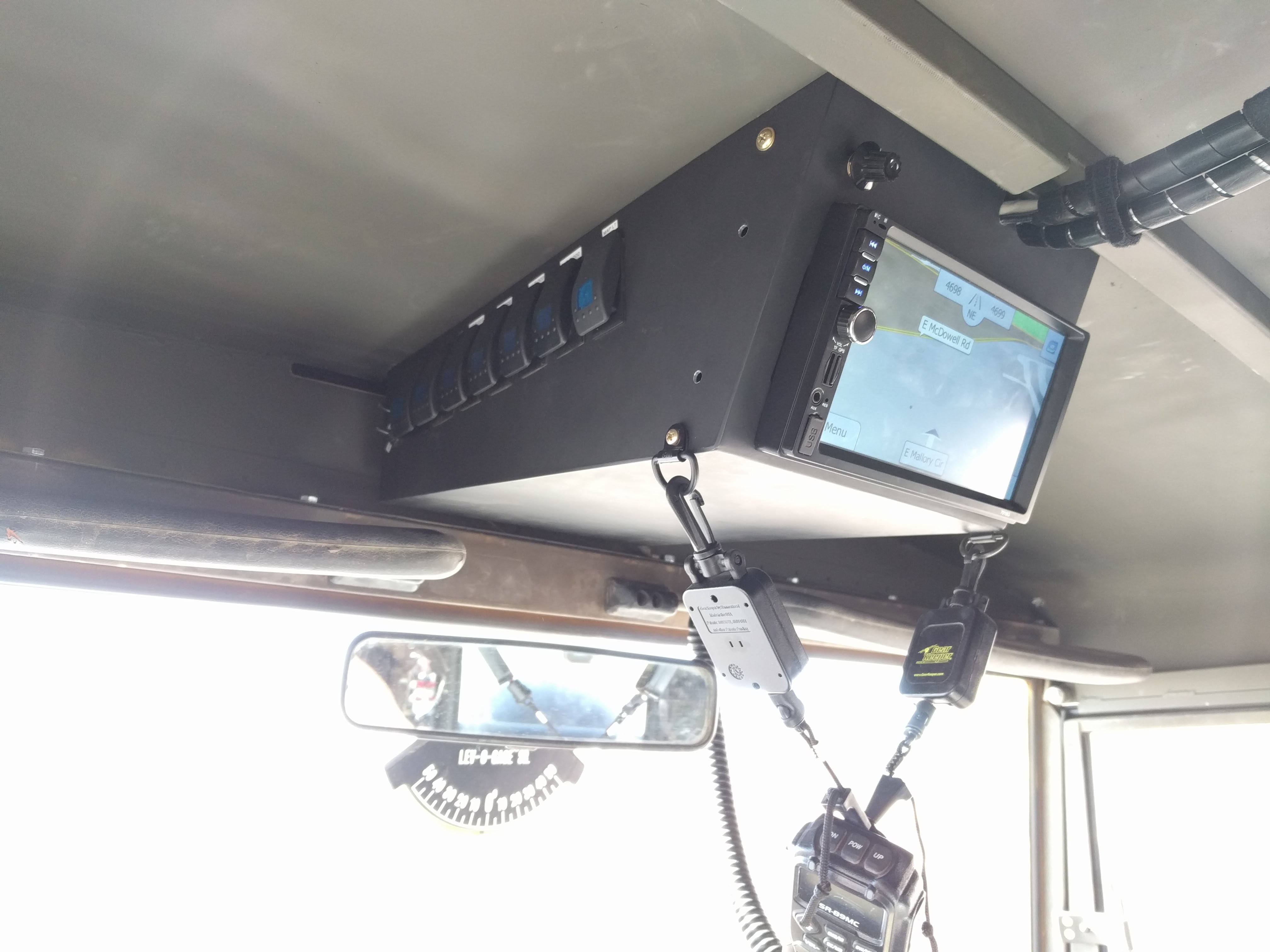

-Custom dash: Speedometer, Tach, Fuel, Oil Pressure/Temp (in process), Davtron M303 OAT (in process). LED annunciator lighting, Rocker switches, Klixon Circuit Breakers.
--The fuel indicator and probe have been upgraded to a system that reads accurately. Mine has a low fuel light that comes on at 1/4 tank. There are pot adjustments on the probe for Full/Empty/Low (let me know if you are interested in a kit)
-LED shift locker lights and laser engrave english locker placards.
-Avionics cabinet in bed area for push button switches which turn on the LED lights in the bed (sleep in bed of Pinz). Also has the voltage and temperature display for the refrigerator.

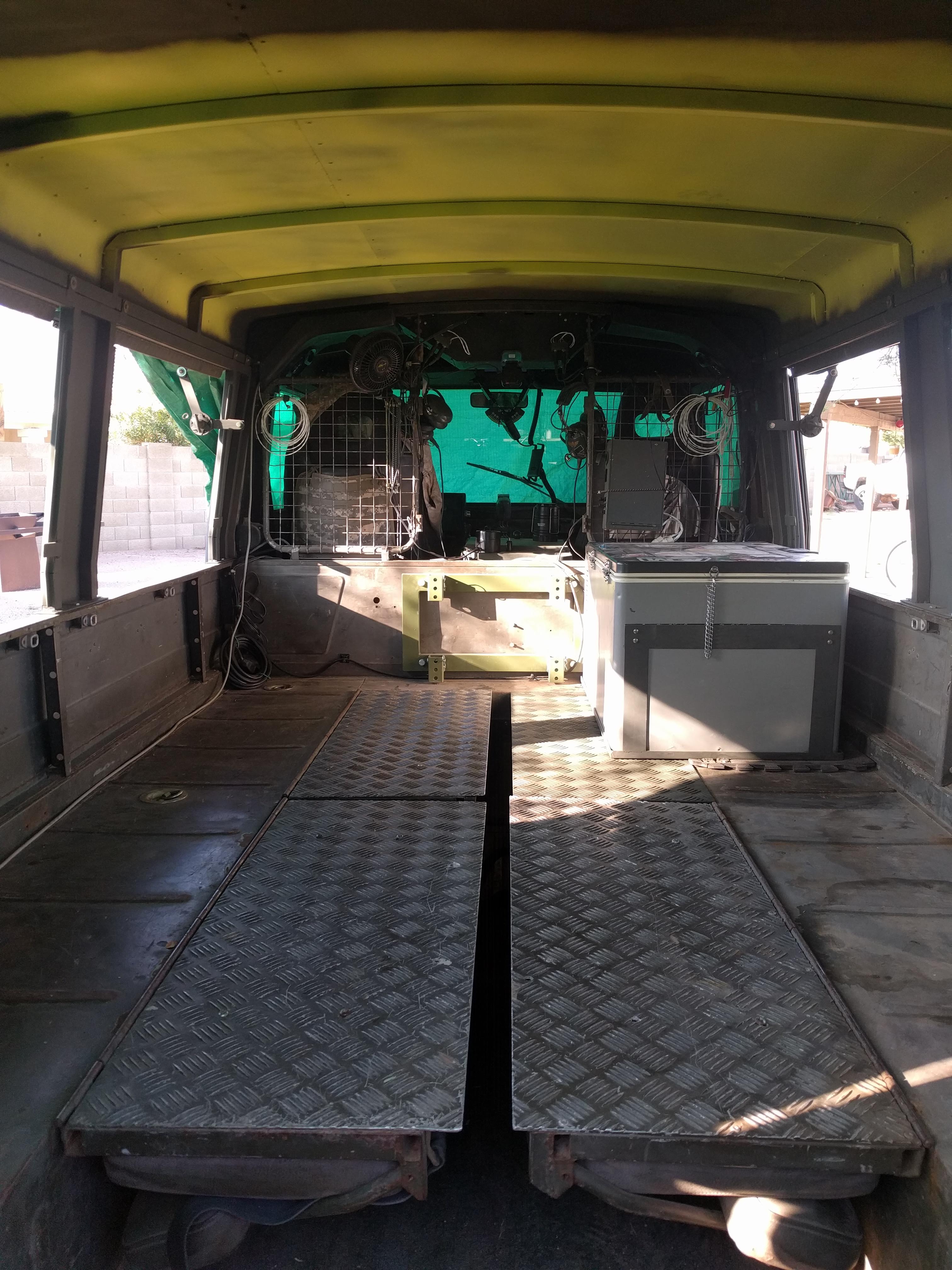

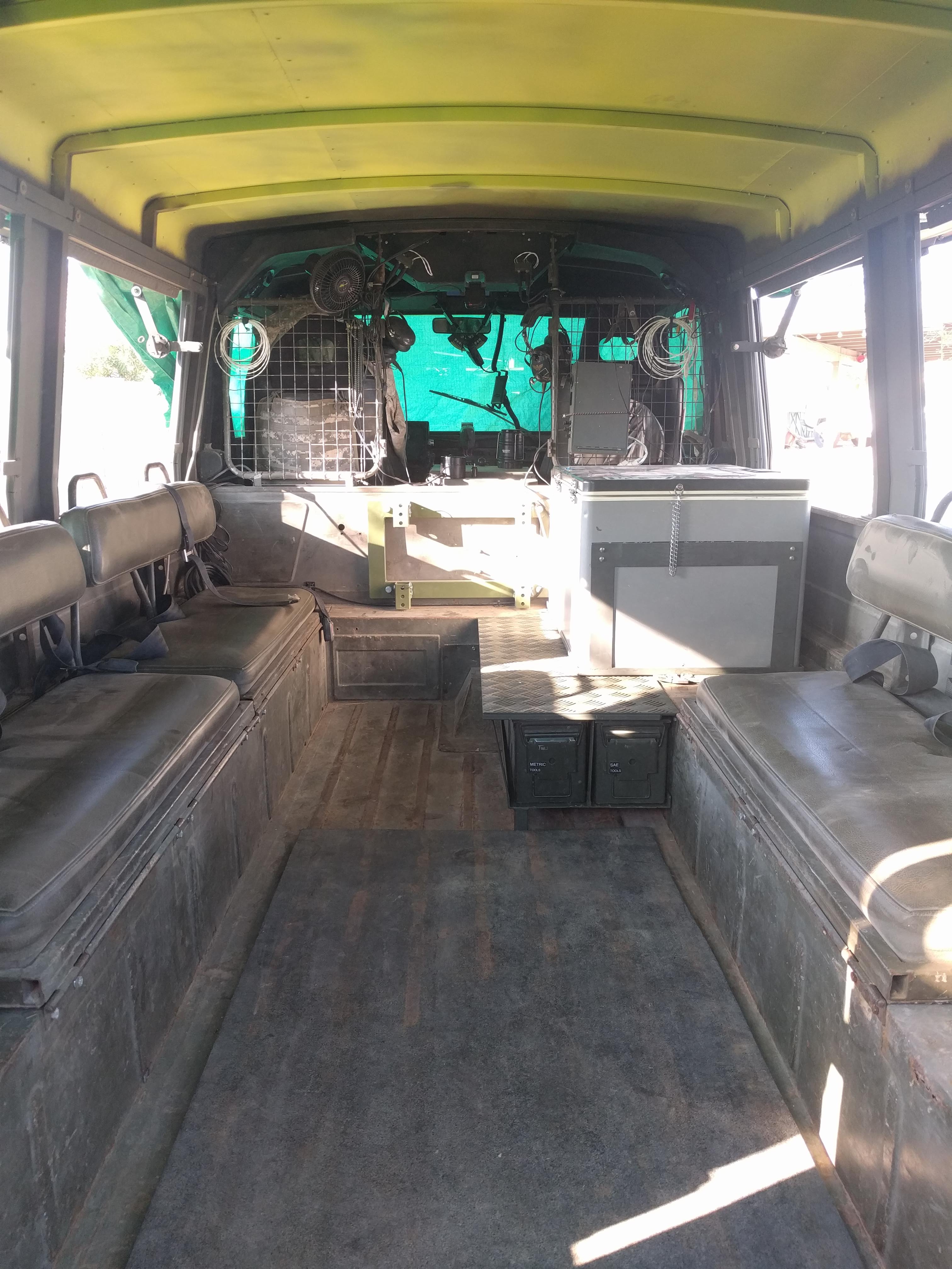

I added 2 pics of the back of the pinz. I like to keep it cleared out so that way depending on the adventure I can either load up all my military boxes filled with camping and cooking gear and then sleep in the back with the bench seats folded or keep it empty to drive it around town.
I wanted to keep everything modular. Pretty much everything that I have done to the pinz for upgrades can be unbolted and removed with minimal affect to the OEM body. I never know what upgrade I may want to do or change next. It is continually evovling! It first started out to support the wife and I during camping and offroading but that has changed into a plus 1 so that moved things around.
I still need to add the insulation and windows to the aft hardtop and sides but that will be a little farther down the line.

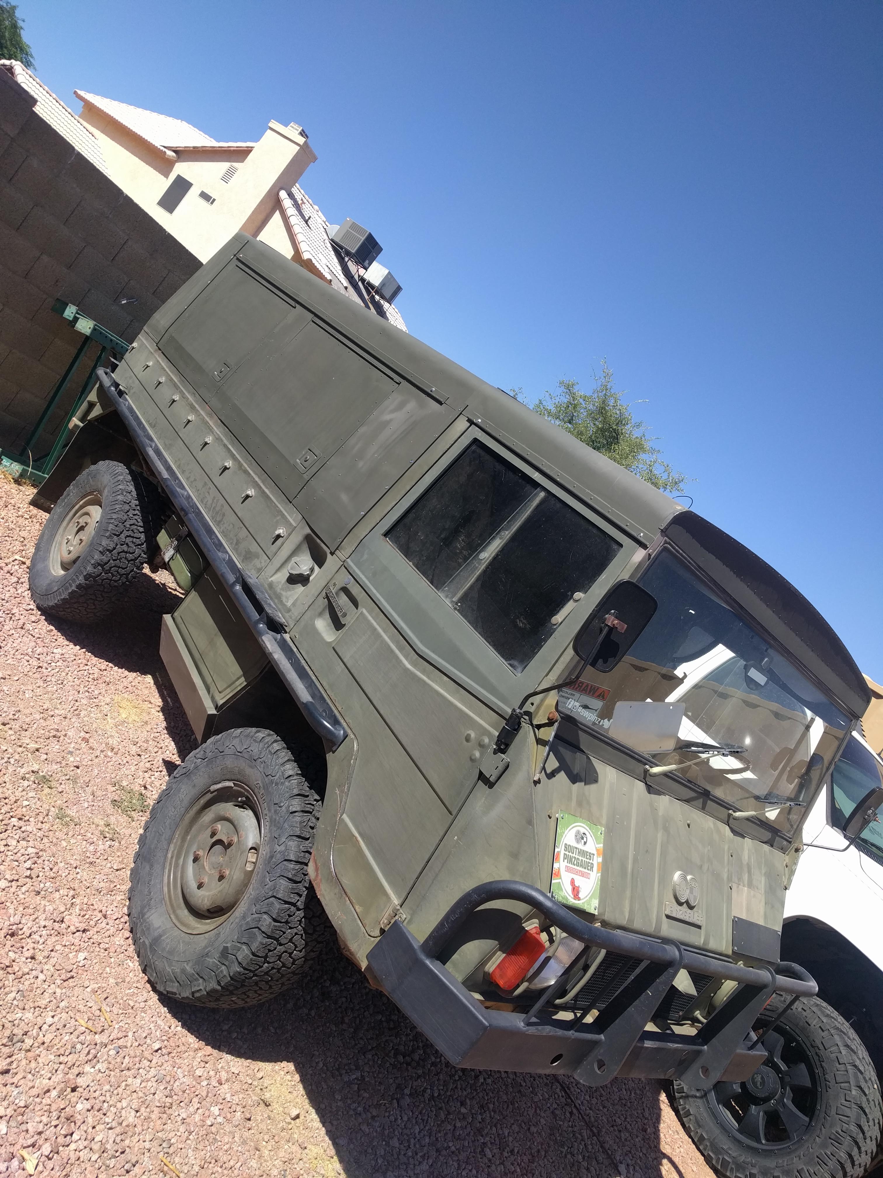

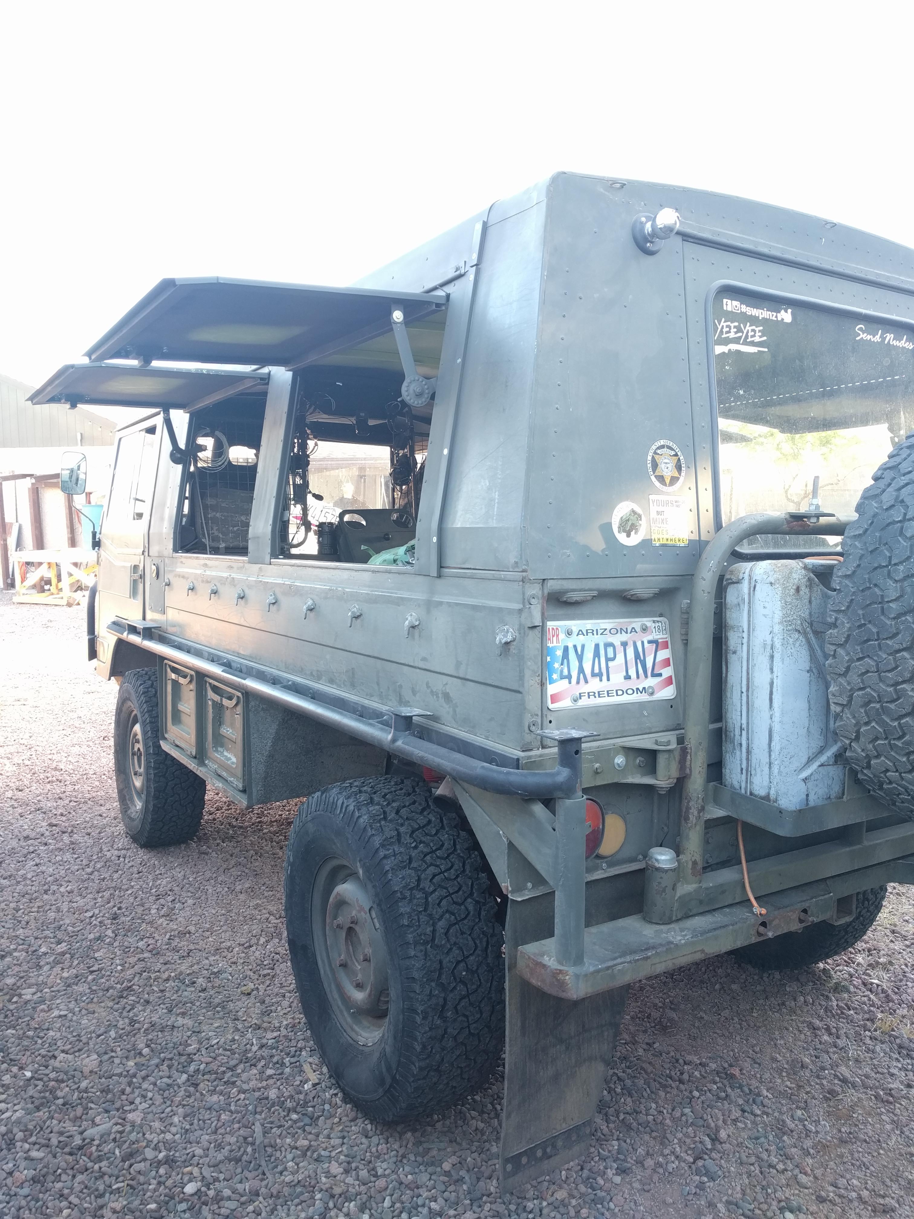

Re: SWPA 710M DeStories Customization
Nice set up. Thinking of making a hard top for mine. Did you use aluminium or steel for the skins? And what thickness is the metal?
Sent from my SM-G950F using Tapatalk
- DeStoriesair
- Posts: 38
- Joined: Mon Jan 05, 2015 9:02 pm
- Location: Mesa, Az
I used stainless steel sheets for some of the side paneling because I had it laying around. Everything else is steel.
Definitely took some time to build but I think it was well worth it.
